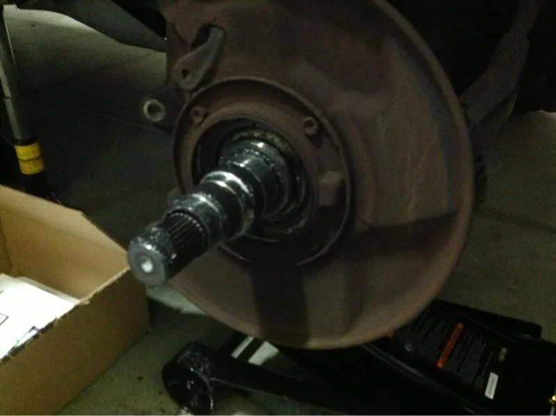

Got this far... How can I remove the oil seal and bearing?
There's an actual seal remover:
Or, you may be able to hook it with the claw hammer you've got there. You're going to destroy it pulling it out, so have a new one on hand. Then the bearings will just fall out. If you're replacing the bearings and races, you can hit them out from the opposite side with a brass drift. If not, clean them up, grease them, and reinstall with new seals. Great trick for greasing the bearings is putting the grease and bearing in a small ziploc sammie bag and go to town mushing the grease into the bearing.
I think I used a pry bar and popped em out....as 1407 said, they will be trashed.
There's another seal here, inside the dust shield, that looks like it needs replacing.
attachment.php
There are four bolt heads [2 visible in your pic] that hold the dust shield and the seal. The inner pressed circle that the bolt heads sit in actually carries the inner seal. Its one part - the pressed metal ring and seal. Easy to change out.
