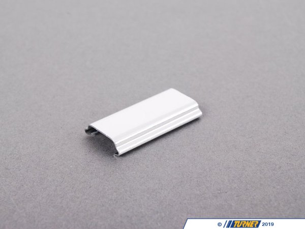

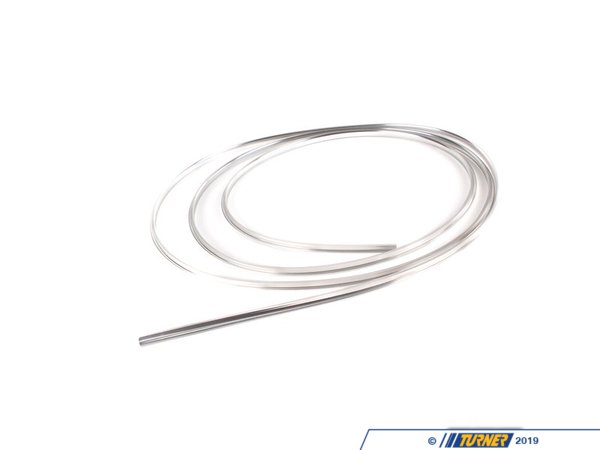

Does anyone have a cross section of what the locking strip looks like? Curious if its anything similar the whats used in most european cars of the era. Its more of a plastic and is solid so it makes it quite easy to install.
Can see cross section of the bmw one below
Here's an image of the cover where two of the locking strips will join. Because it is a cap, it doesn't show the plastic which essentially runs as a flat strip on the inside from what I recall. Both the cap/join and the locking strip have the same x-sec profile and it is the flange on either side that fits into a notch on the window seal.
Good morning @gregkline55 ... maybe @LCABOVEALL will post a x-sec picture of the locking strip for you with measurements (height and width). What you show might work, but I'd be a little concerned that the thickness of the flange you showed in both pictures for the E30 chrome is too wide (thick) and it doesn't appear that the LC strip has the triangular plastic portion below which could make it too tall.
That said, I can see where you are going with this and it would be great to find an alternative that fits. Let us know.
12mm wide and 5mm tall. I included pictures of the lock strip , which is two layers. The top layer is a very thin chrome steel. The second interior layer is a hard plastic. The two layers are bonded with adhesive. I suppose the plastic layer is to add strength to the steel strip and possibly acts as a moisture barrier to prevent rust. That said, they are very delicate when not installed. I also include a picture of a new OEM weather seal. It’s necessary for the back side of the lock strip to be flat given the shape of the seal. No alternative that I know off, which is why so many FJ60/62’s have been converted to an aftermarket seal that does not require the bead lock.
