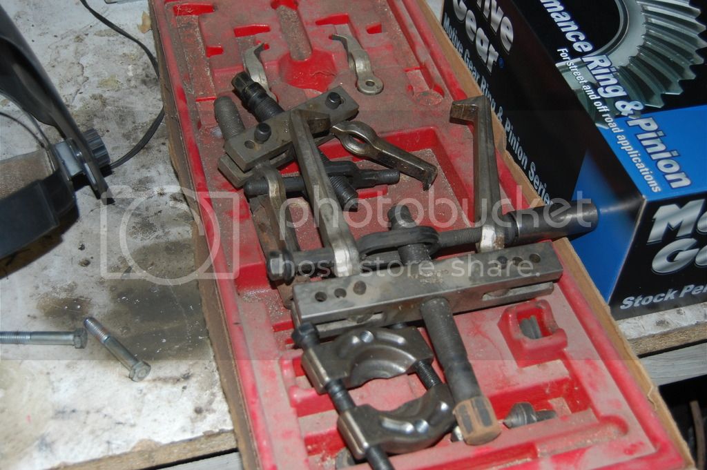

Borrowed puller from my friend.....priceless.

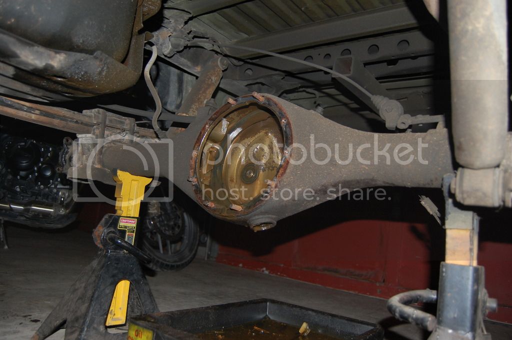

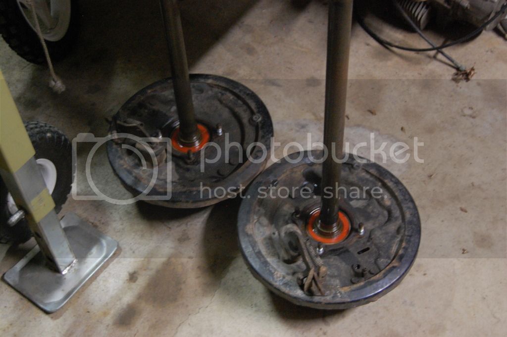

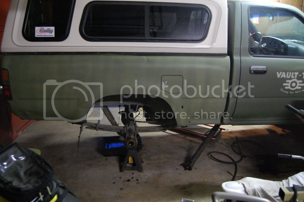

I pulled the axles.....I really like the removable 3rd member! Much easier than my jeep to work on.

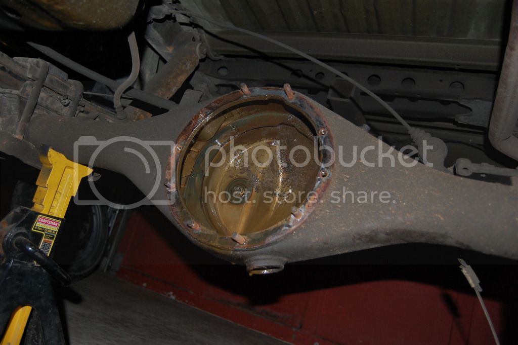

Axles out!
Crusty Axle housing... This axle laid in my yard for 9 years before i used it.

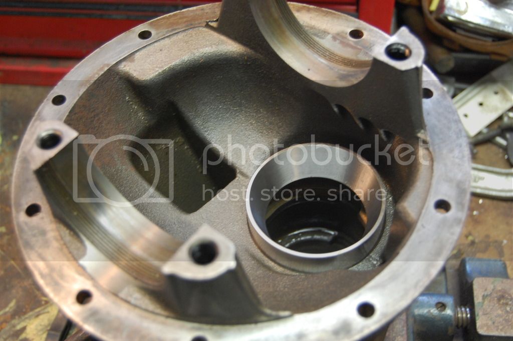

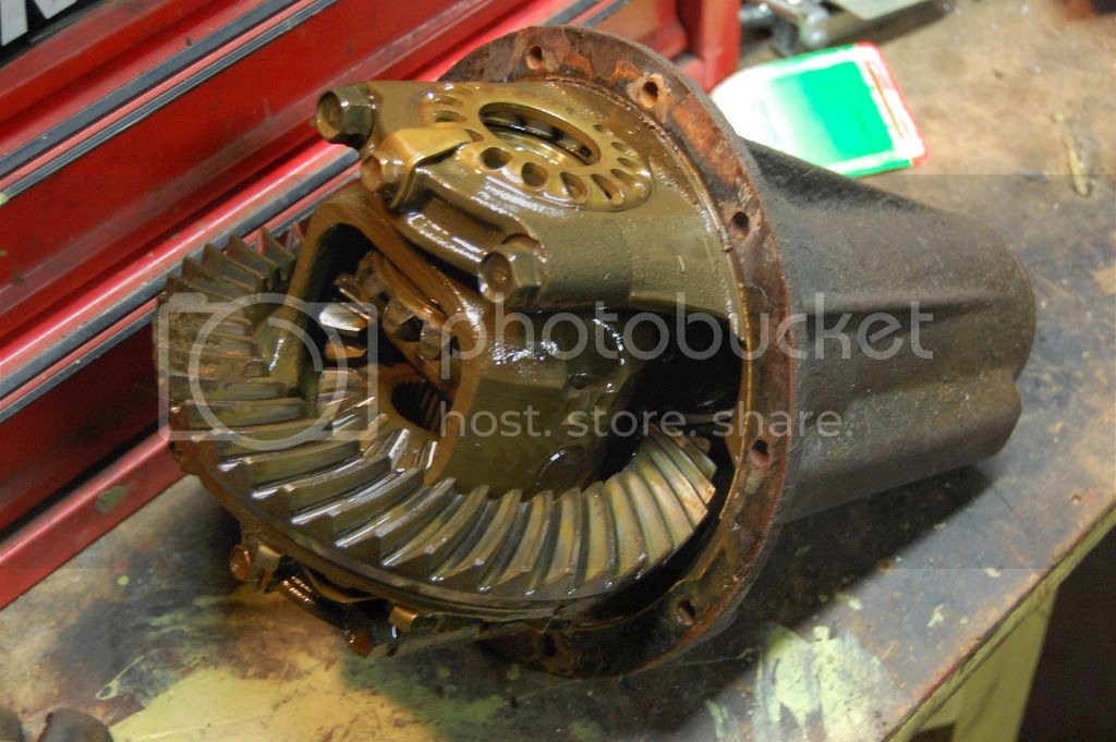

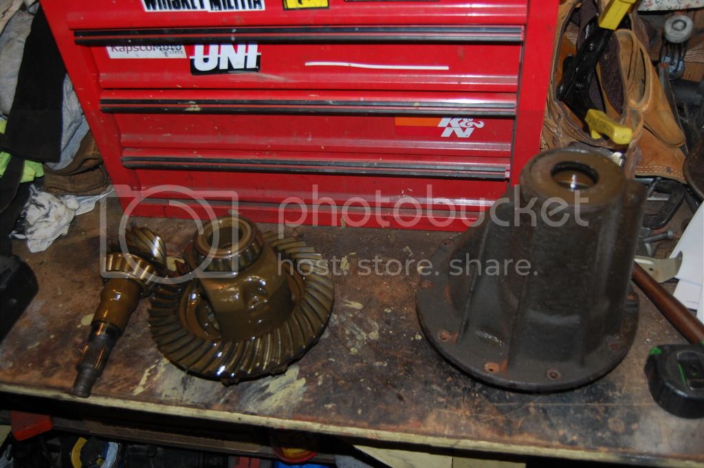

3rd member out

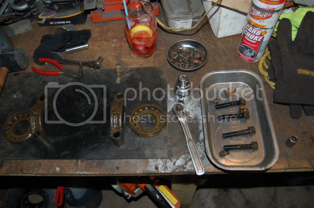

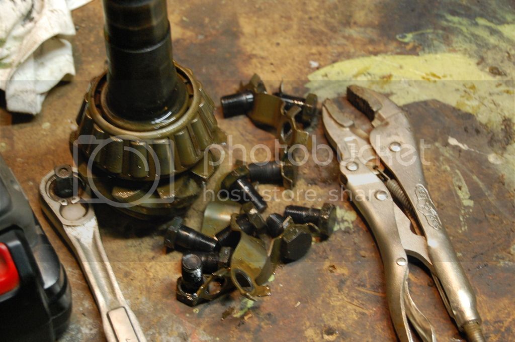

Punched the bearing caps
My gear oil wasn't very old but it looked nasty!
Slimy Crush sleeve!

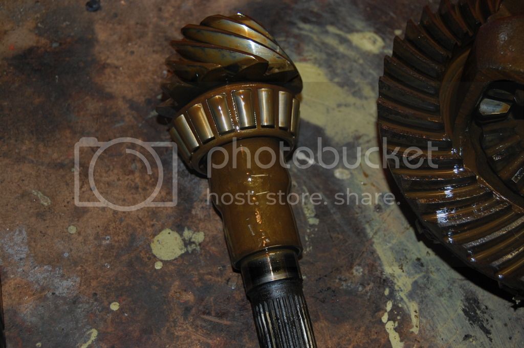

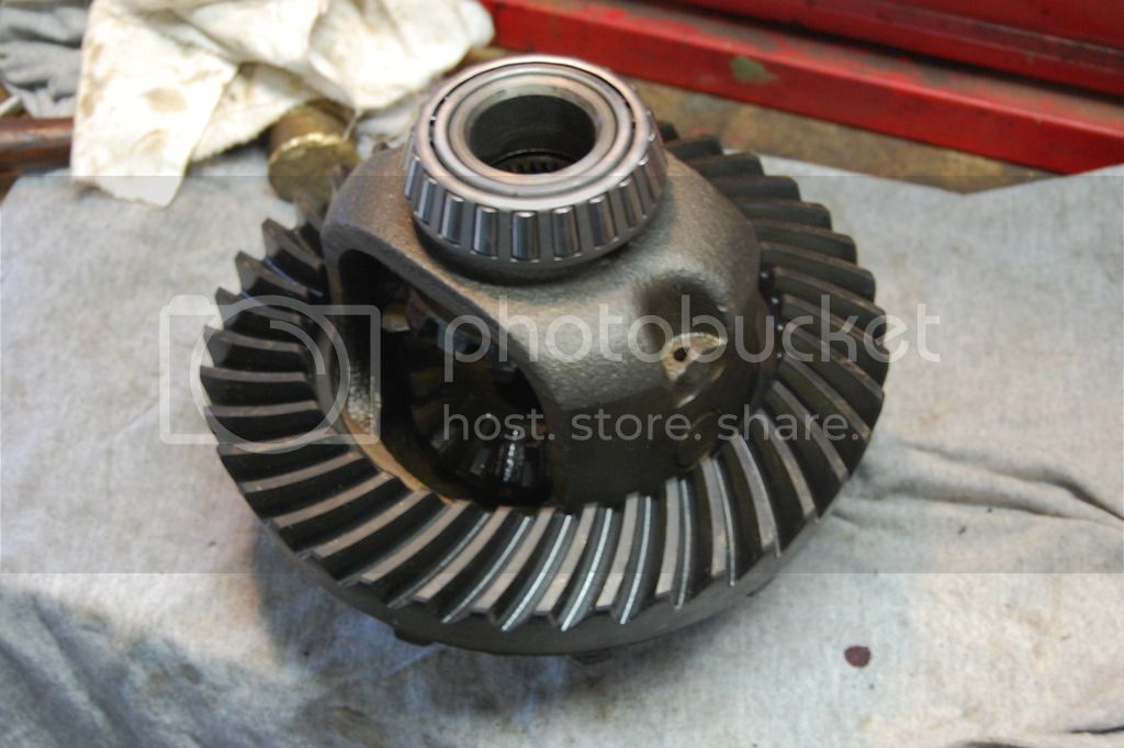

Carrier...

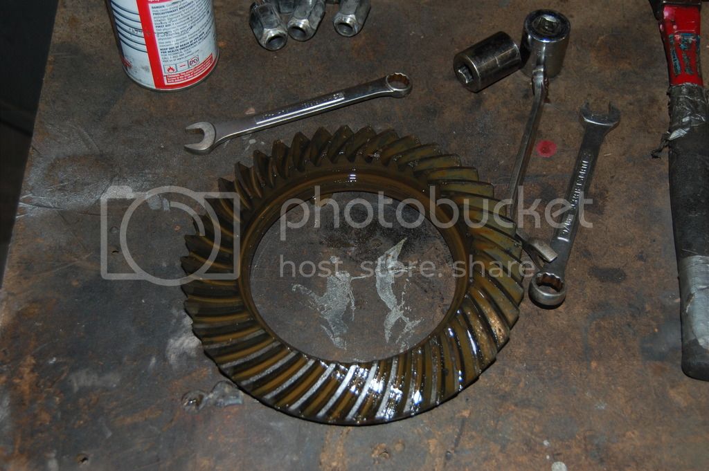

Crusty old 4.10's

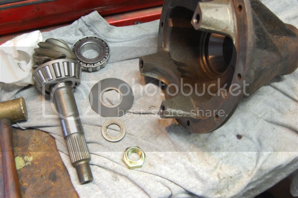

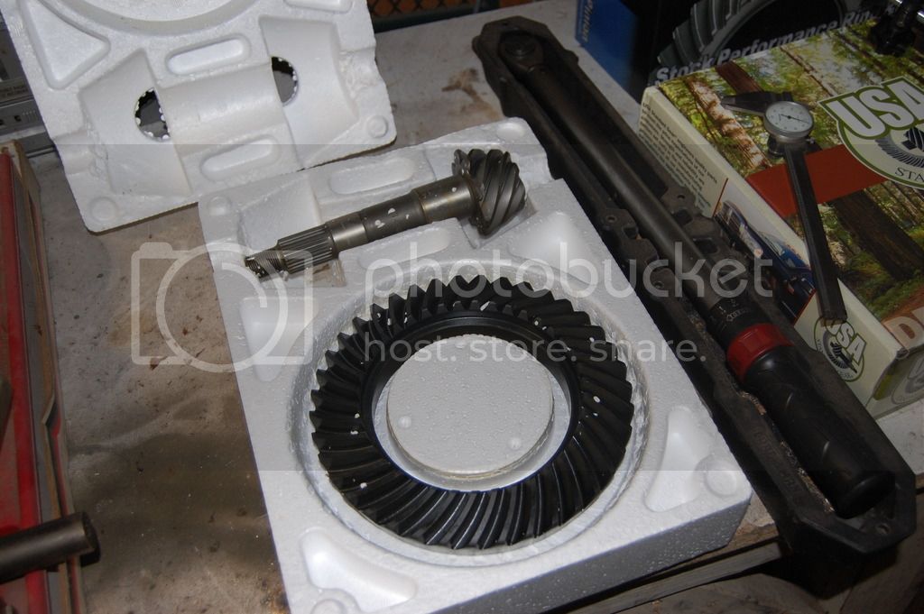

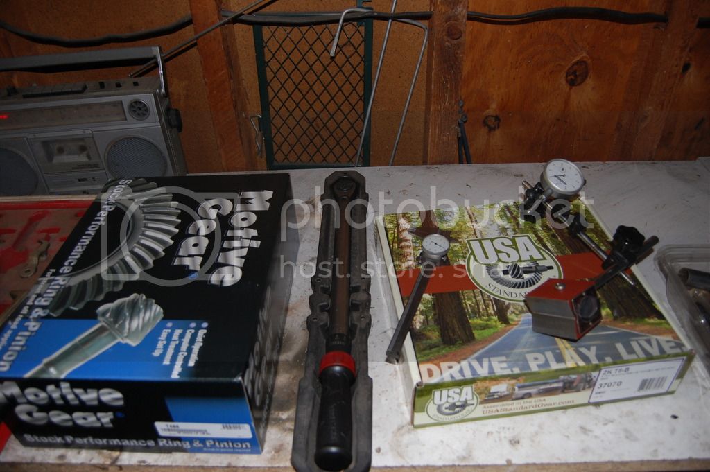

New parts!

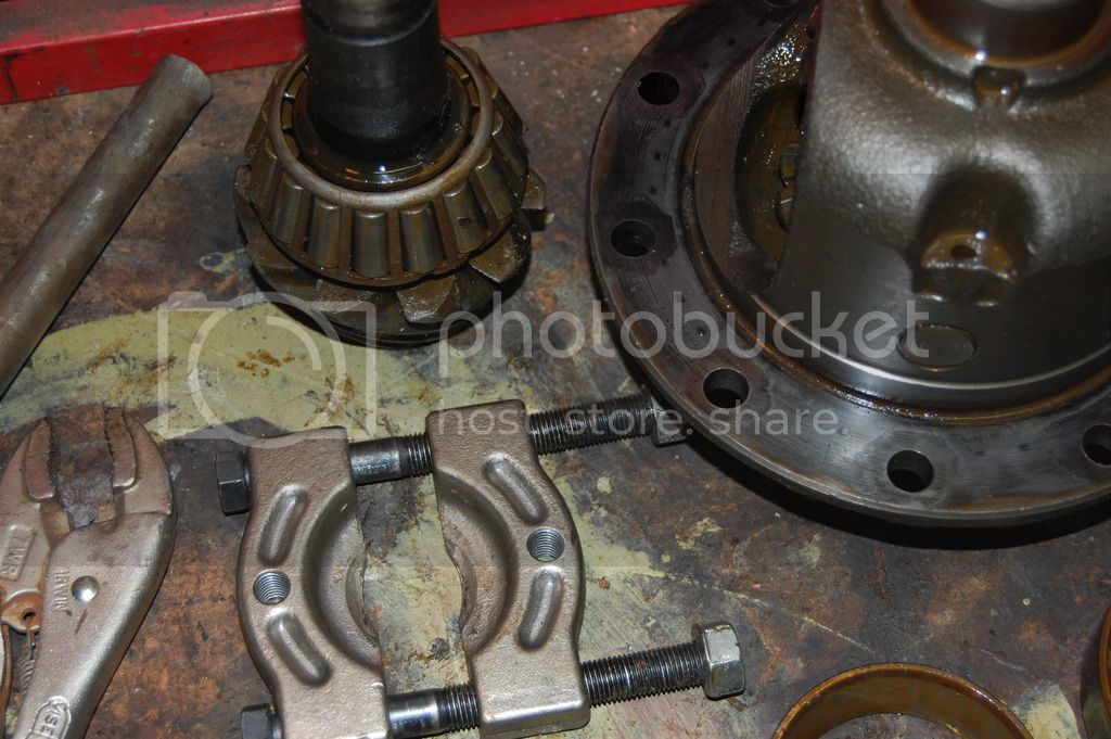

Borrowed pullers!

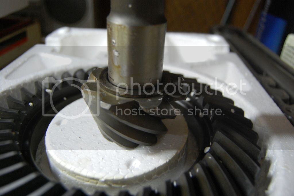

New Gears!

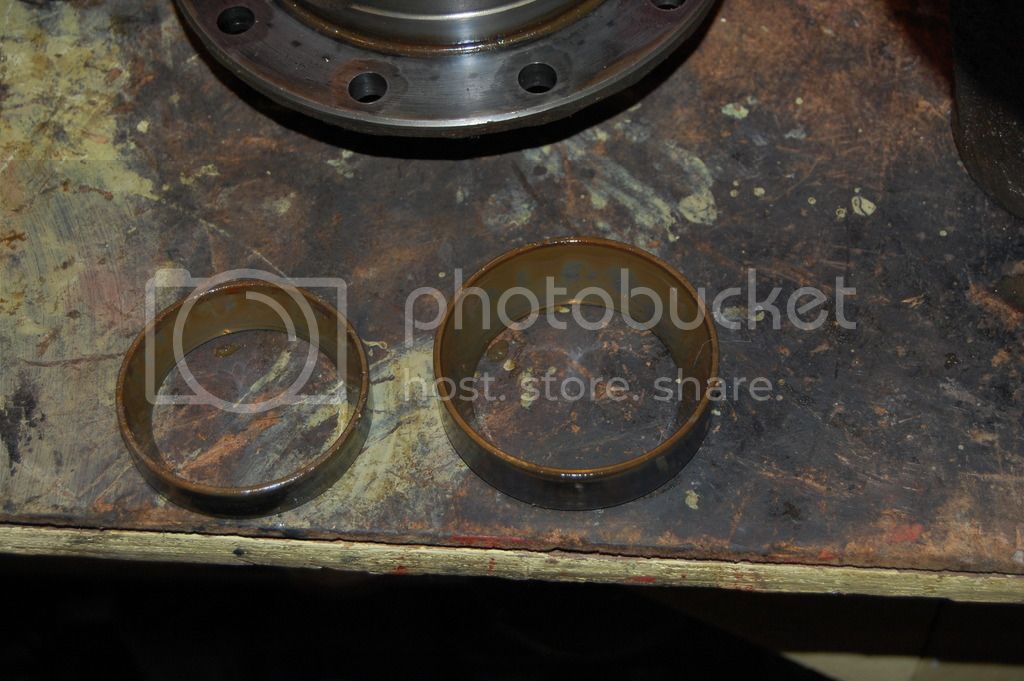

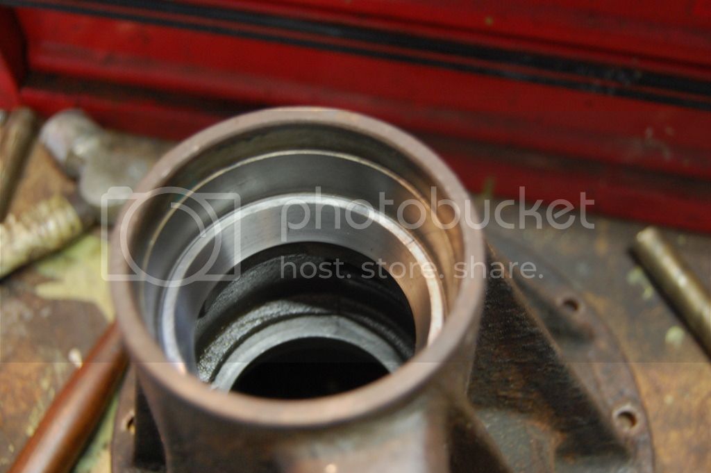

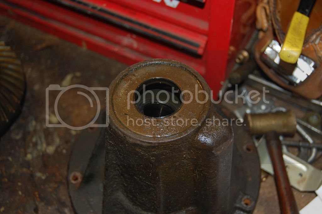

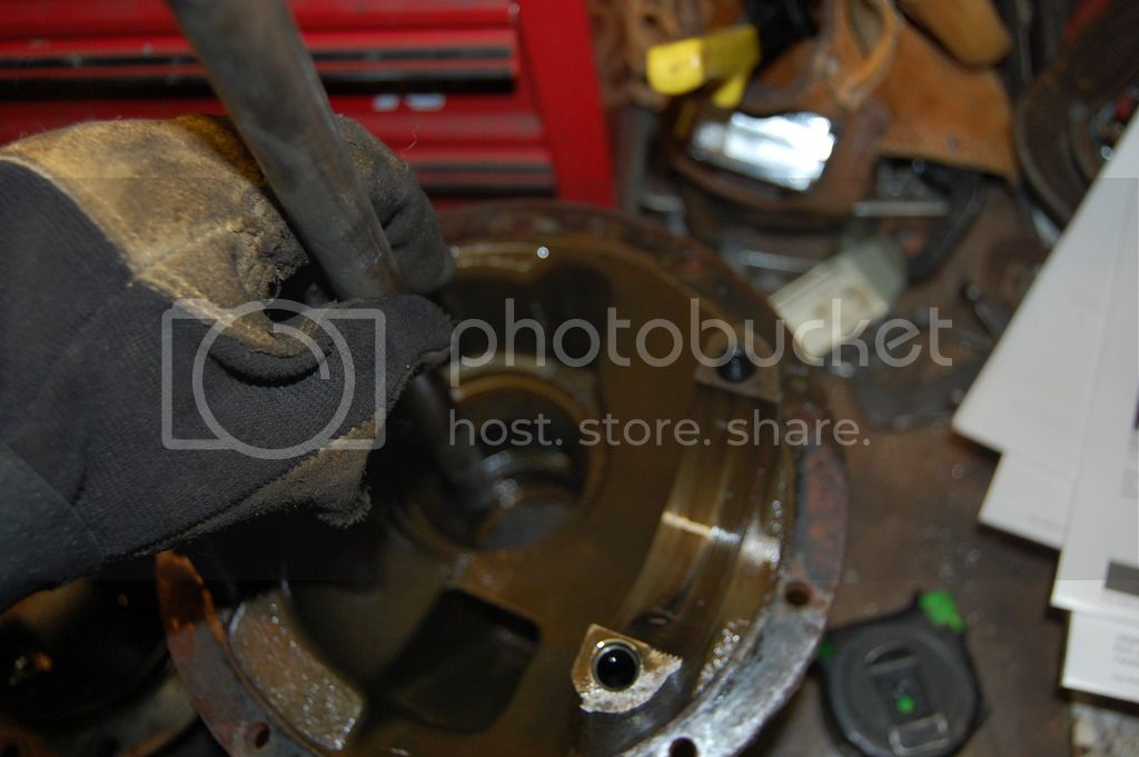

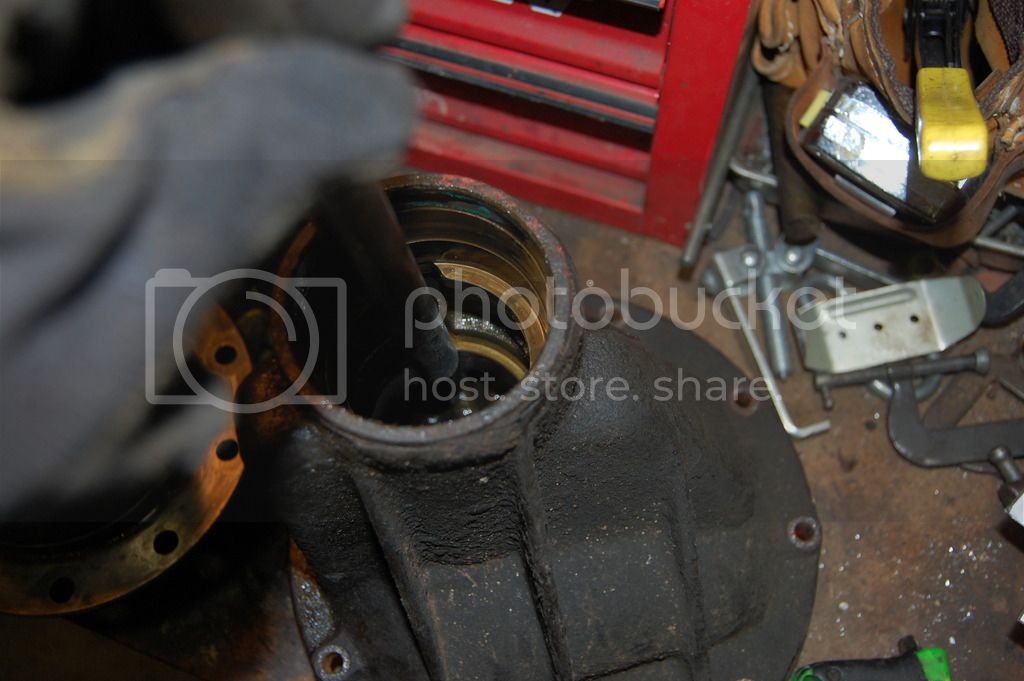

Driving out the old pinion bearing races with a 5/8 brass rod.

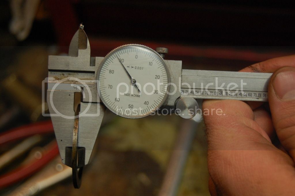

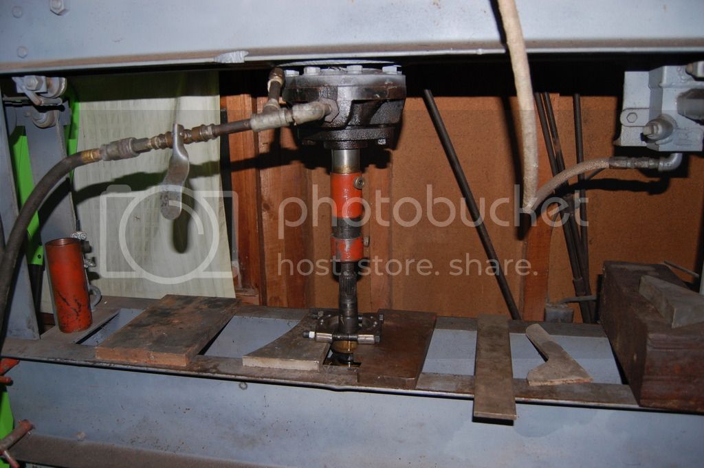

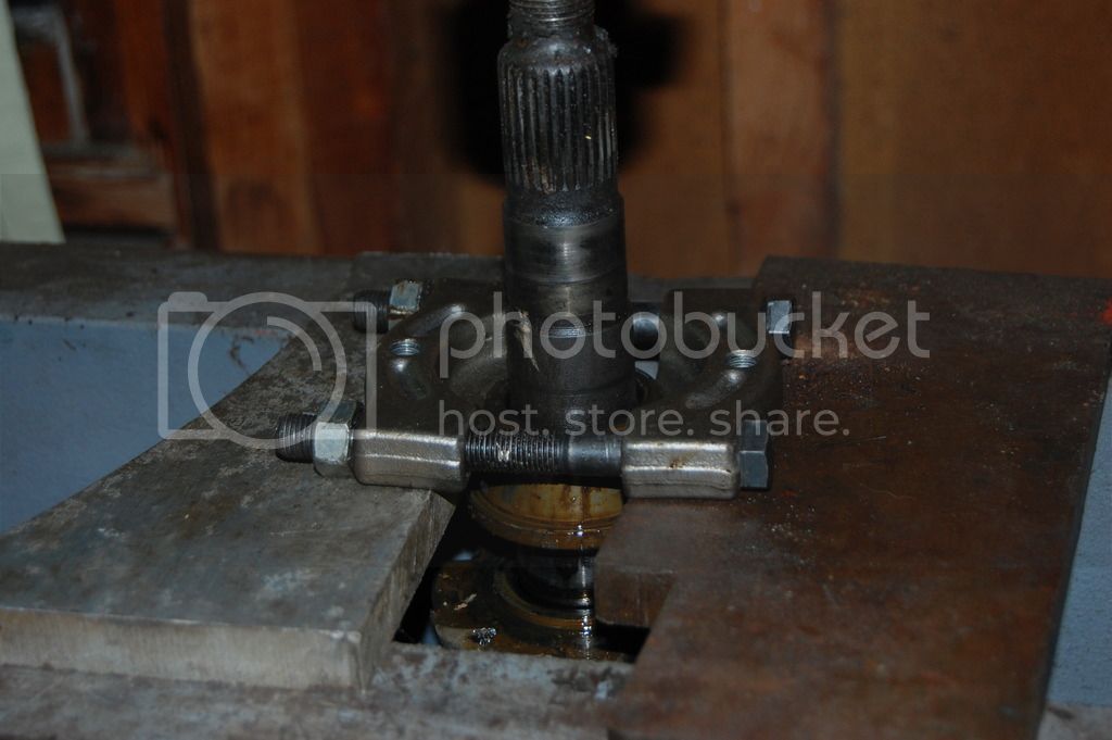

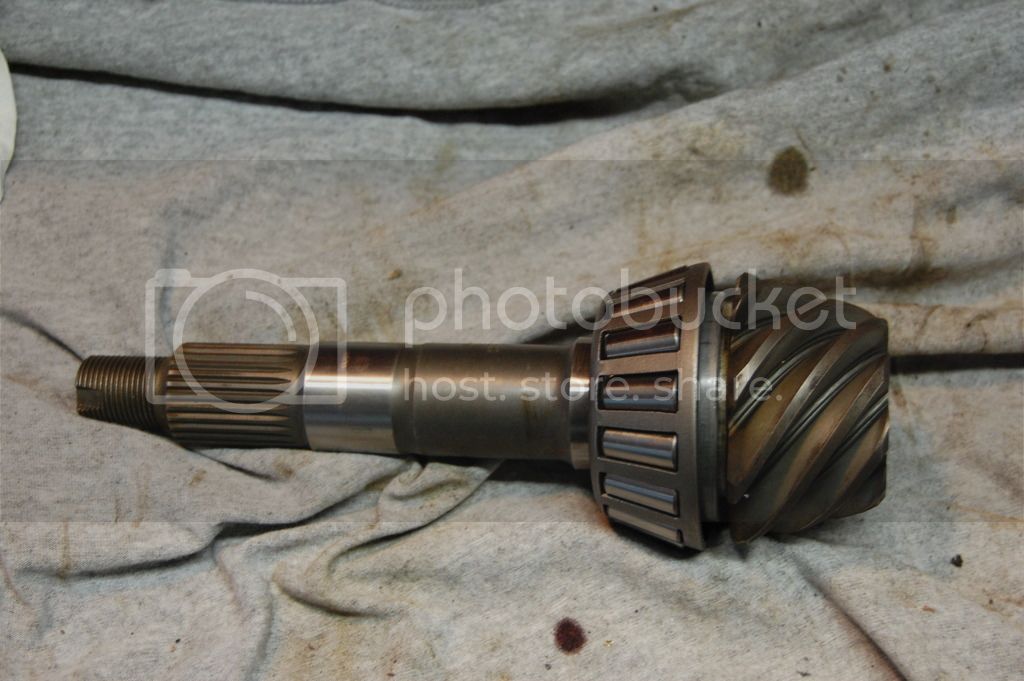

Pressing off the old pinion bearing so I can measure the old shim. (with my ancient homemade press)
Old shim was .089...
Slid it on the new pinion for fun.

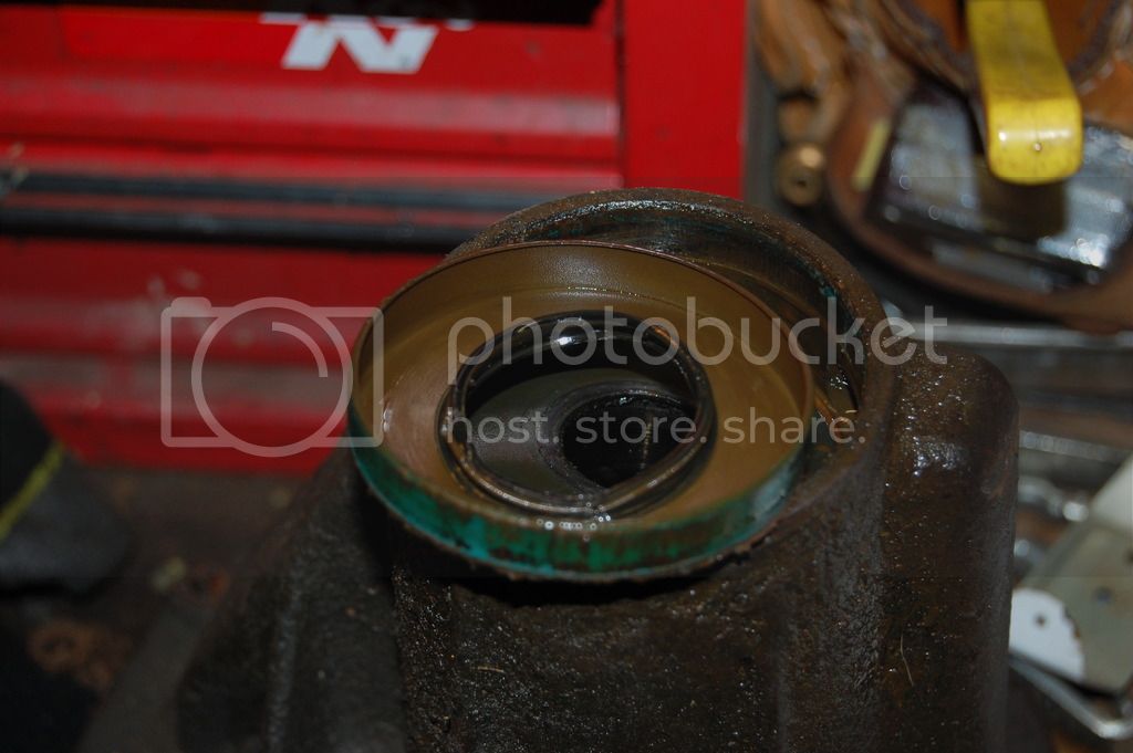

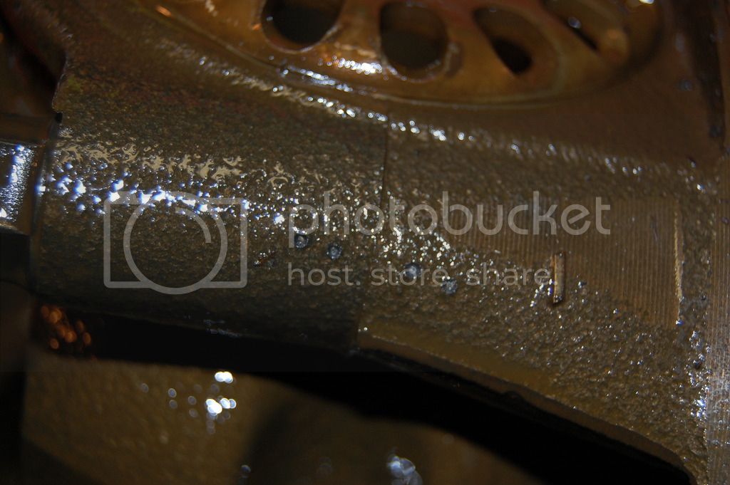

I thought the same thing when I saw the green goop.....So I asked my buddy.... PO of the truck and he said he replaced the seal when he bought the truck back in 99.... So i'm guessing the pinion drag was not properly re-set. But the wear on the gears look fine. I have another diff I could have regeared but it has a welded diff in it....I loved it off road but this truck is my dd now so I used the rear with the open carrier.
One question i have is......do you guys re-use the locking tabs on the ring bolts? the instructions with the gears did not specify. Thanks!

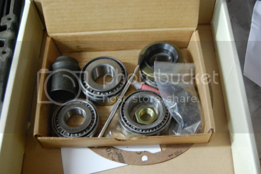

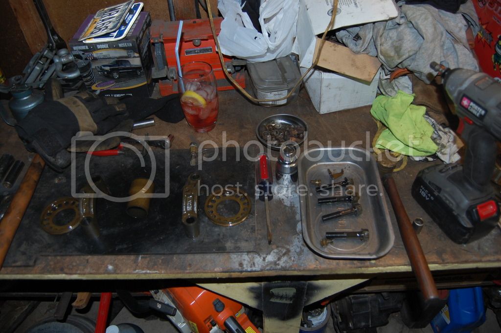

Here is the install kit.
New bearings and ring gear installed.

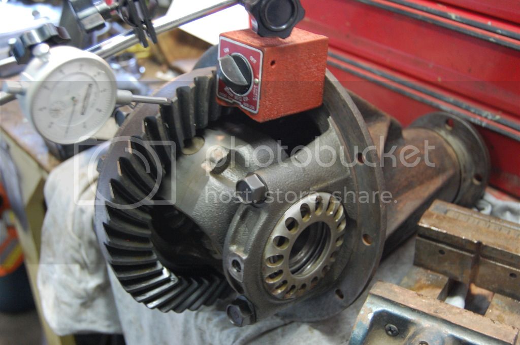

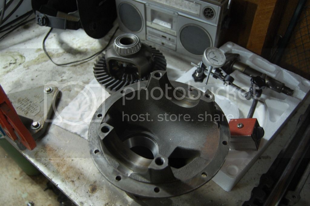

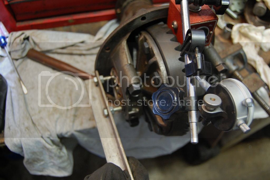

Checking backlash during temp install... I followed the instructions and set it to .008.

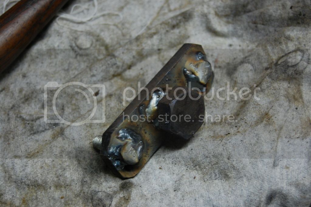

Custom adjuster tool
getting ready to check

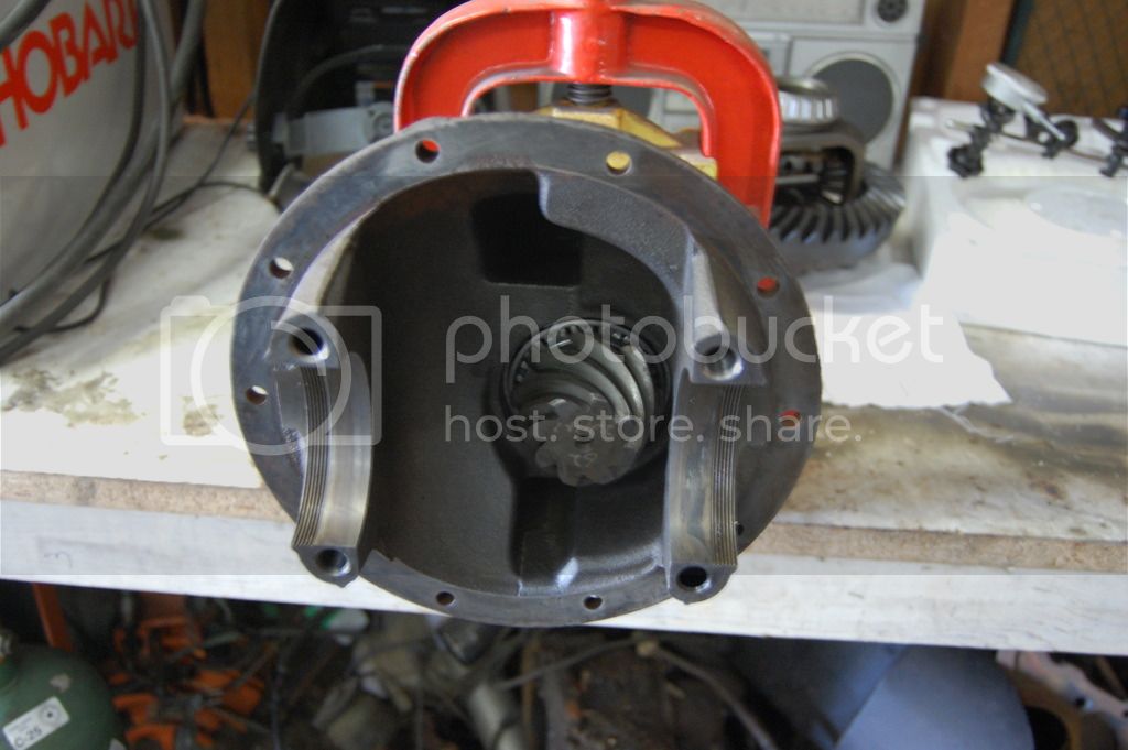

Something is way off..... Pinion doesn't rotate smoothly and makes a little tapping sound when rotating. What do you think is going on?
I always re-used the locking tabs.
Just curious how you got the ring gear over the carrier? I always set it in a water bath in an old electric skillet, monitoring the temp with a temp probe and a DVM.
Then the ring falls right onto the carrier and you can easily spin it to get the bolts installed, just gotta work fast before it cools.
You need more shim on the pinion. This is where a setup bearing comes in very handy.
My ring gear tapped on easily with a rubber hammer. I wish I had a setup bearing but i do not have one and I had to cut the cage of the old one to get my puller on it.....I am going to get a bigger puller tomorrow so I can pull the new bearing off to add more shims.

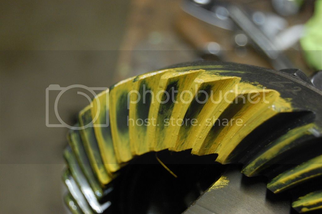

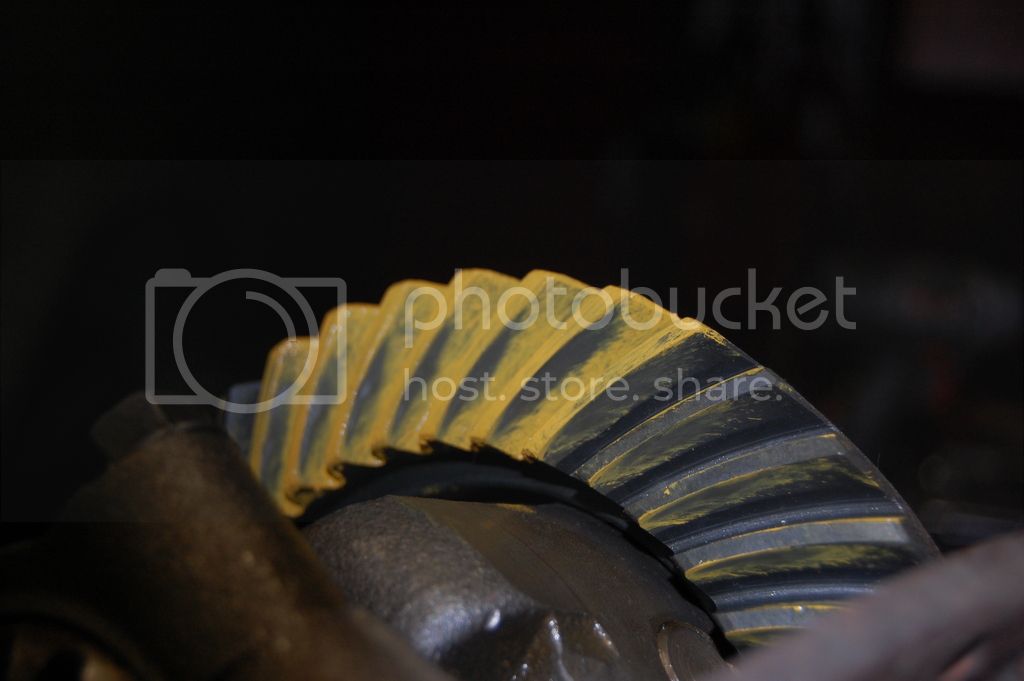

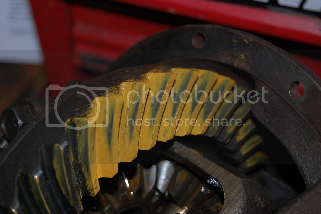

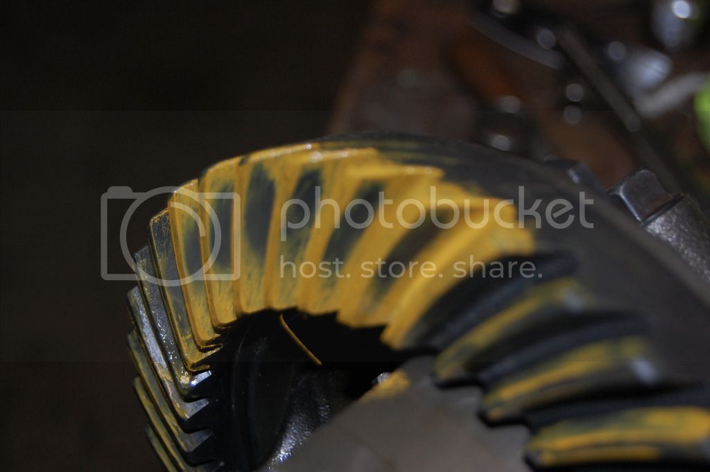

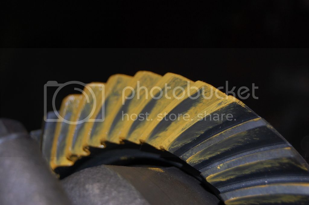

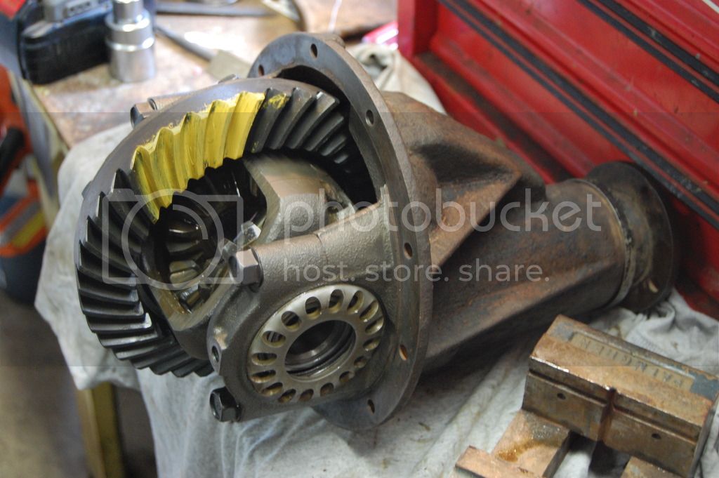

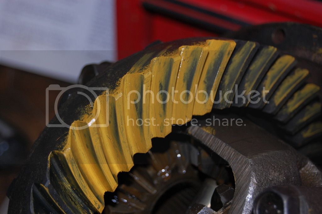

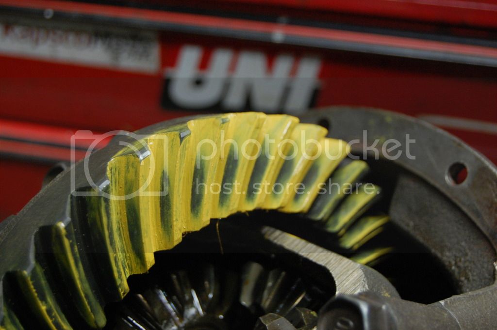

Thanks to the help of fellow members I bumped up to a .220 pinion spacer. rotation smoothed out and my pattern is light years better. I went with .220 and here is what I got. I am at .007 backlash
I found it hard to photograph so I hope you can see it well enough. :)

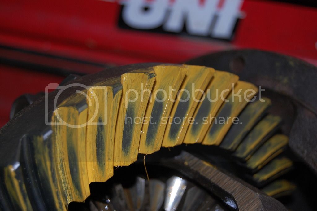

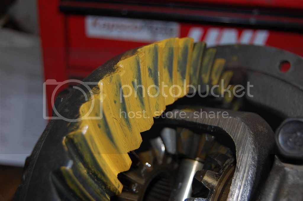

Ok, sorry for the delay! Here is what I have with .008 BL and .240 pinion shims. What do you think? I think it looks good....and I really don't want to press of the bearing another time. Also is it normal for the end of the pinion to come within a few thousands of the carrier? Im guessing its because I had to shim the pinion out so far.... do I need to do anything about that?
Looks good to me. I would run it. See... that wasn't so hard, was it?
Go very easy on it for the first 50 miles or so. It will run hot. Eventually the gears will get happy and you can start going a little harder on it. Change the lube after a few hundred miles, don't be surprised if it looks like silver paint.
Yeah I am happy with it... It was challenging but very rewarding! Not hard. Now I just have to install the seal and sleeve and set the pinion drag and put her back together!

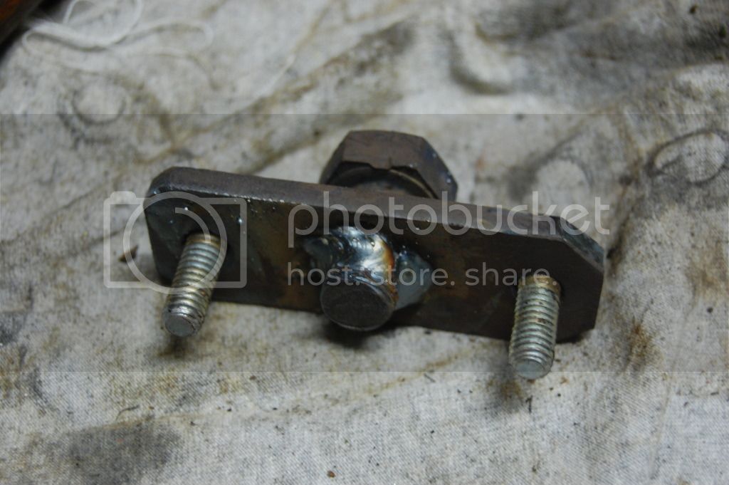

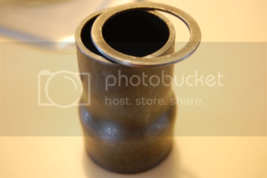

Here is a picture of the shim I made.... It brings my sleeve up to 2.440. thoughts? I dont have a solid spacer and the new one that came with my kit was shorter than the one I took out.
Did you try the crush sleeve like it is? It's been my experience that the bearings in the kits are "fatter" (if that makes sense).

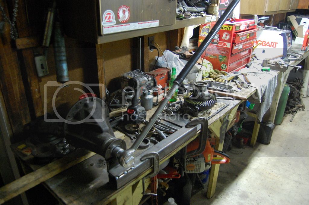

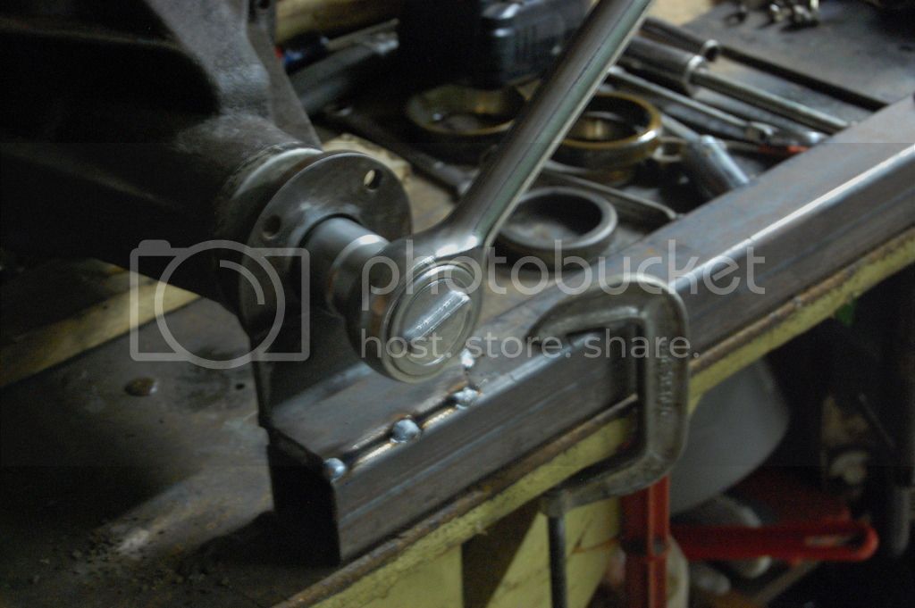

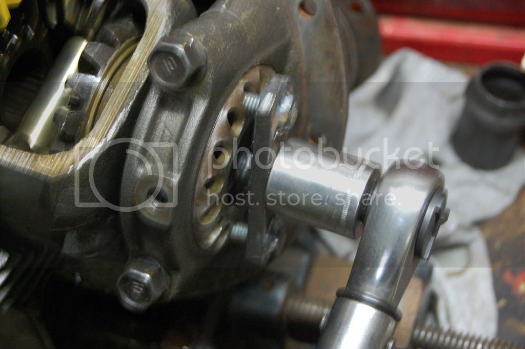

It's harder than you think to crush those sleeves, you will need something VERY stout to hold the flange and a long wrench on the 30mm socket. I have a piece of 2x2 x 48" angle steel that is drilled at one end for a pair of the flange bolts. I clamp it to my workbench (that is bolted to the wall), then put a cheater on my breaker handle. Still... I swear I'm about to have a stroke sometimes trying to get that thing to crush.
I got a little time to work on the diff tonight.... I spent about an hour making some stuff that made my life much easier! I made a jig to hold the flange while I crushed my sleeve. :) It wasnt nearly as bad as I thought. Once the bearing pressed on I felt it get really hard and then i could feel it give once the sleeve started to crush then it turned hard but smooth. It took forever but once all the slop was out of the bearings I would tighten the nut about a 1/16th of a turn then I would check the Pinion preload then I would put it back in the jig and go some more. I did that about 15 times until I got it right. I really wanted to make sure I didn't go too far and have to get a new sleeve. It wasn't bad at all. Then I popped the carrier in and started setting the back lash. I am a little unclear on how to set the preload on the carrier bearings without changing the BL. I set my BL to .008 then I snugged up the adjuster wheels until they were tight.....then my instructions say to turn the wheels 2-2.5 holes then torque the bearing caps to 58lbs. Does that sound right?
Flange holding jig!
Adjuster wheel tool so I can use my torque wrench.

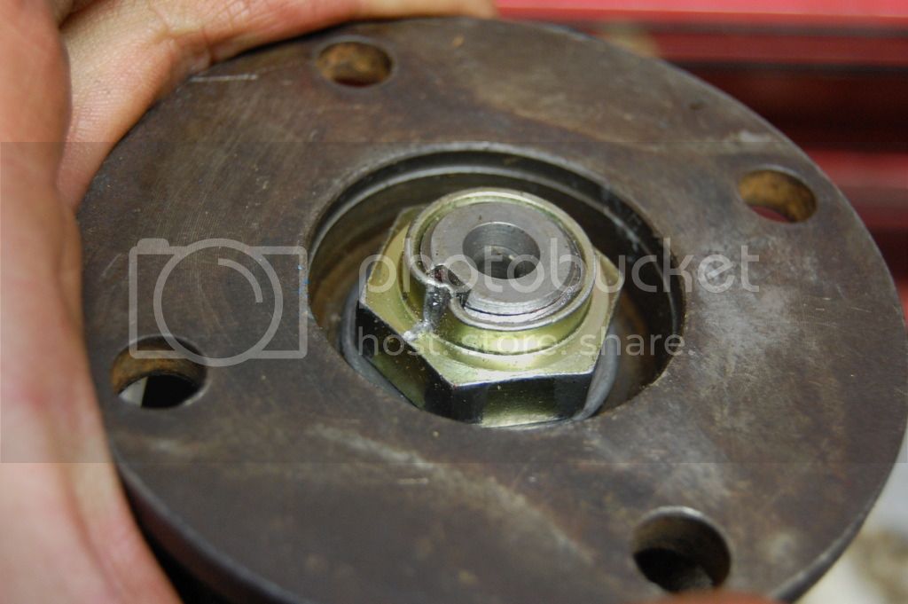

Nut "dinged" and red lock-tite.
