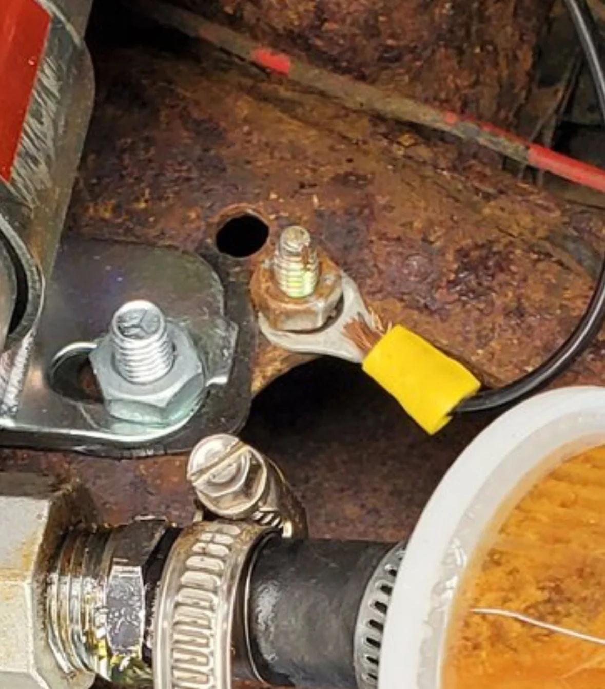

So!!! Yesterday around 1 i went out to move Red (was in wife's parking spot.) Naturally with the tractor 🚜 because it wouldn't start. So me tries to start it and gets da click again 😳. Then me 🧠 kicks in wit never happens, i remember it died at hardware store couple years ago. I look under and touched this white wire a boom fires off. So i investigates and what do i find!!

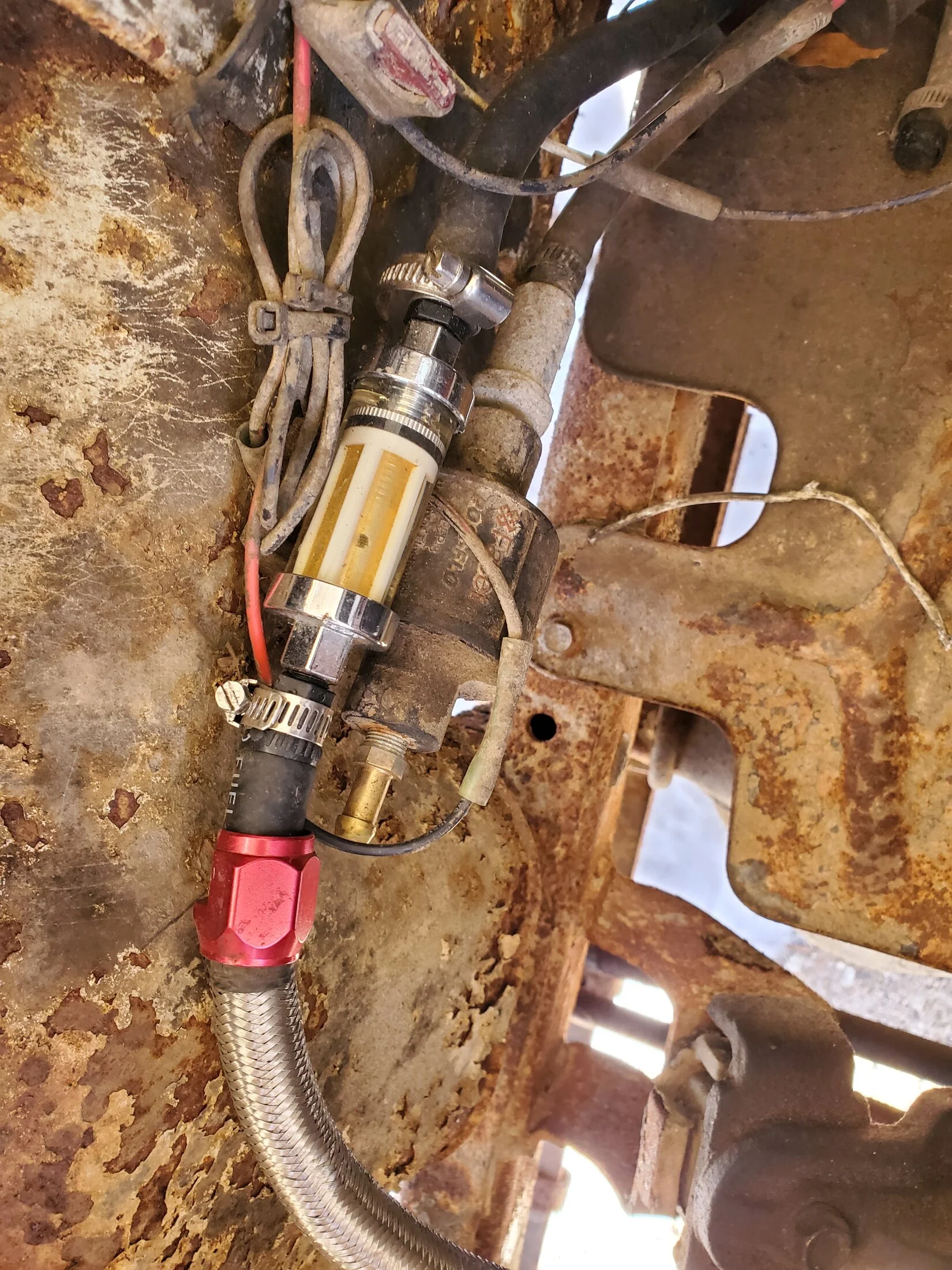

I find this broke in half it goes from positive across firewall under dash somewhere. I gets my electrical connectors (electrical tape 😳😉.) and makes a strong connection. The 🐷🔥s right up. So i moves it 🐖👈 Ford. Then i tries da Projection lamps 👀 da all good to go. Moving on to the fuel. The pump is leaking at the barbed fitting and was'nt before. I did seal 1 fitting and the 1 that's leaking now is the 1 that did'nt. View attachment 3825916
Ya can see all da 💩 in da filter but it's not going past that point. So i goes out 5 hours later no choke no gas pedal turn da key 🐷🔥s right off no problem. Checked lights again good to go. Next step is clean filter and reinstall or replace. Didn't touch it today because of 🌎 quake this morning 😲😳🤔🧐😉

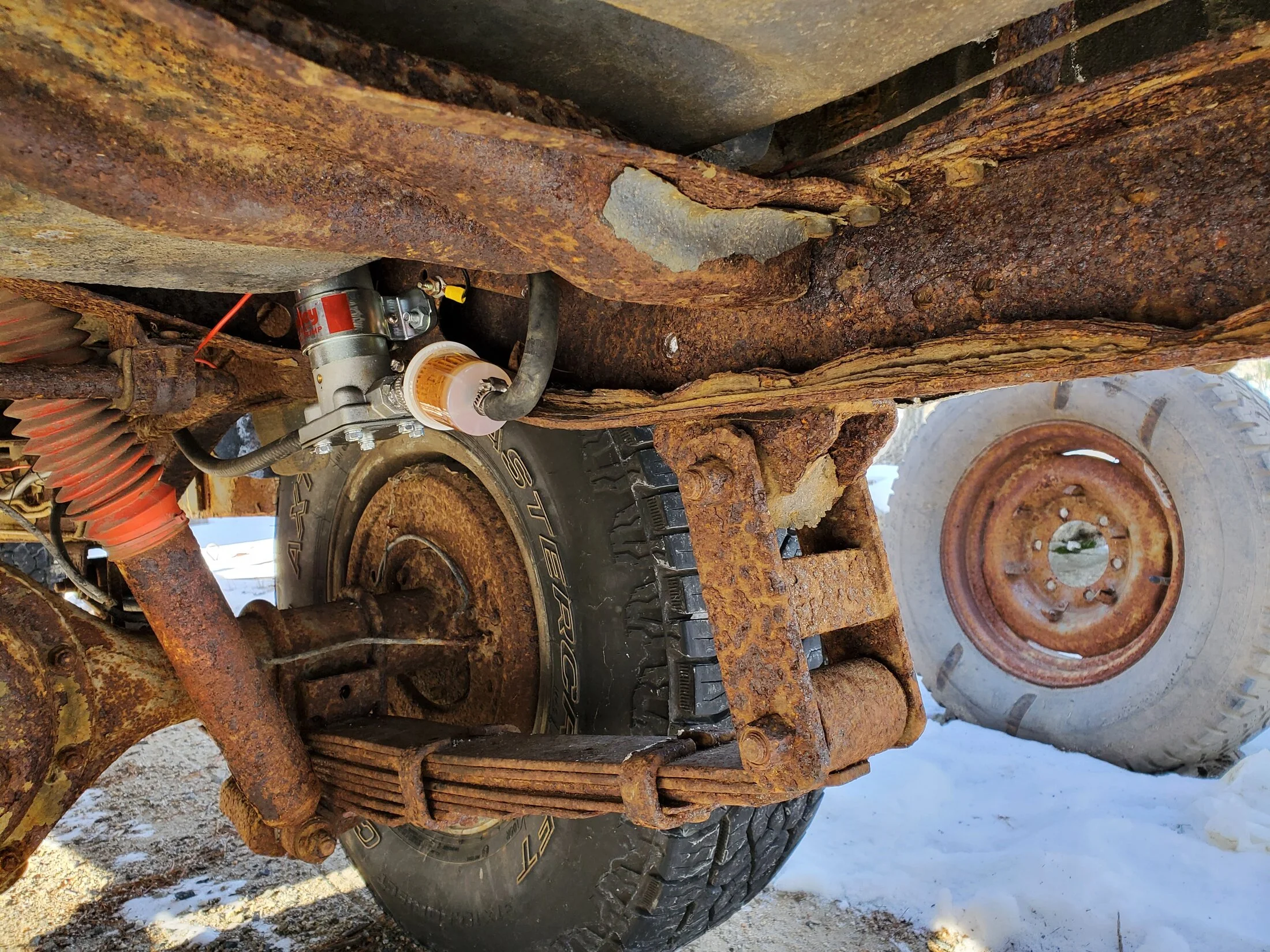

Have you considered 2 filters before da fuel pump? If you haven't already of course :cool:
In series that wouldn't help. In parallel then you get 2x the area so that would help but more or less just like using a larger filter. Just FYI.

Cleared and temp dropped from 30s to teens. Nothing like cold gas and carb cleaner on bare hands in this weather laying in Snow ❄️🌨. Got filter and barb fitting remove and sealed barb reinstall and cleaned filter. Wouldnt believe 💩 in that.
Think I'm good to go. Inspection in morning 😘.
