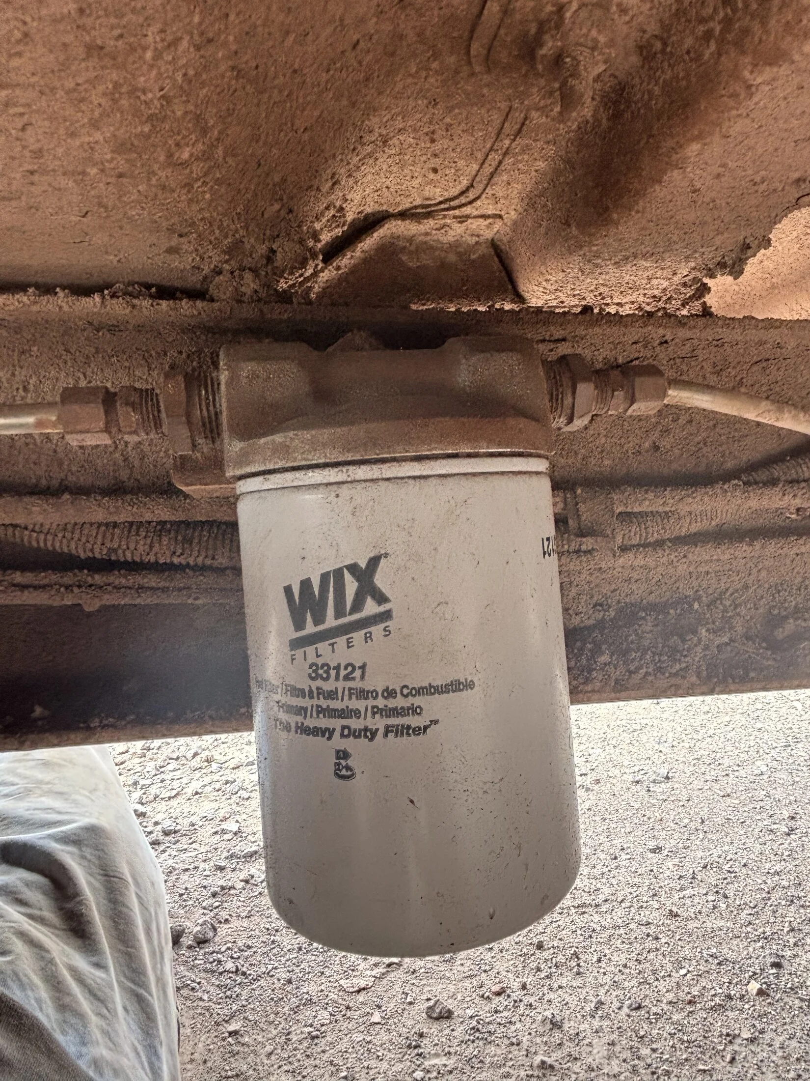

Found a couple things you might consider Bob.

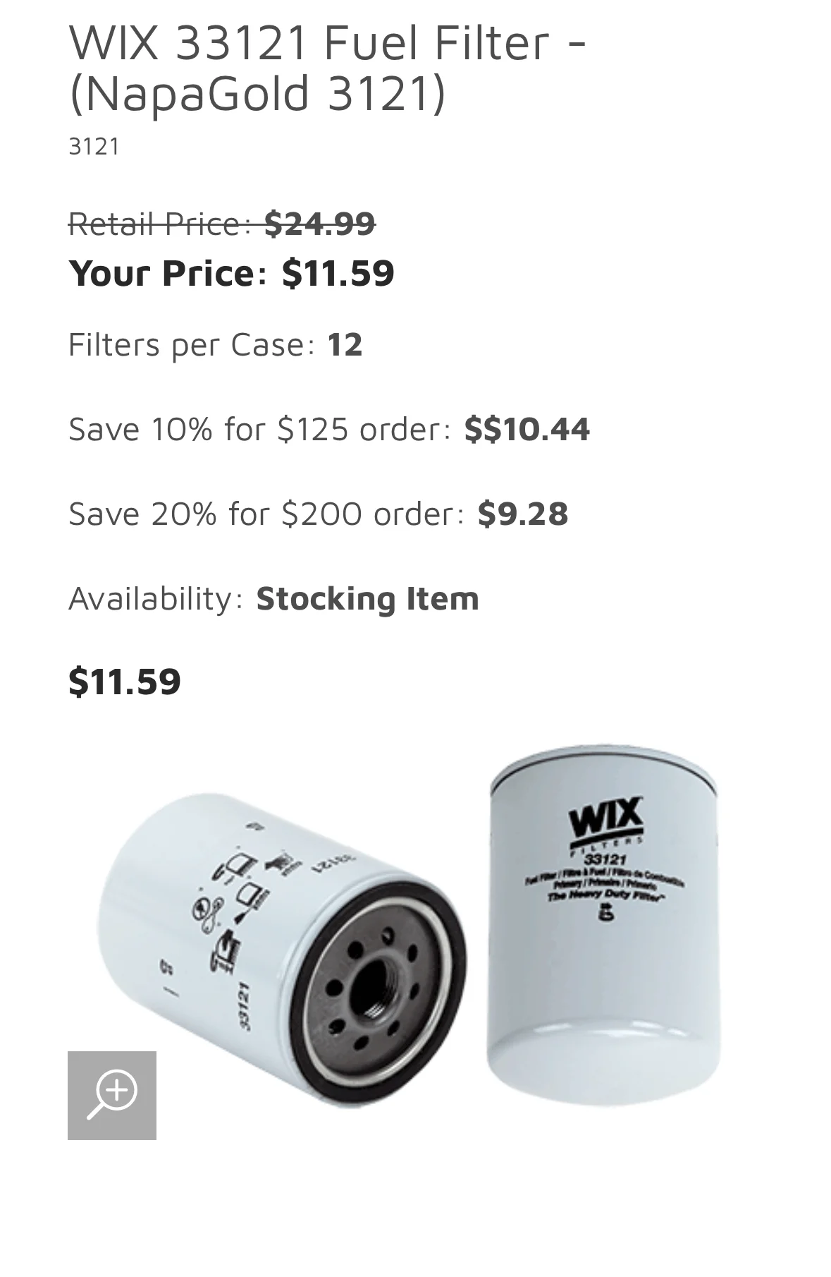

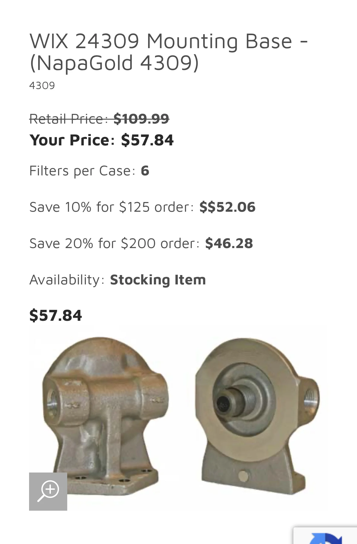

You could recirculate fuel through your 3/8” fuel filters back to the tank, and change them out as they plug up, or try this.
WIX has a universal fuel filter head (WIX 24309 or NAPA 4309) that uses a spin-on fuel filter (WIX 33121 or NAPA 3121).
Both versions are available all over the place.
Bigger filter, capture more junk.
I’m thinking about 10 gallons in the tank, and just let the pump run for at least an hour.

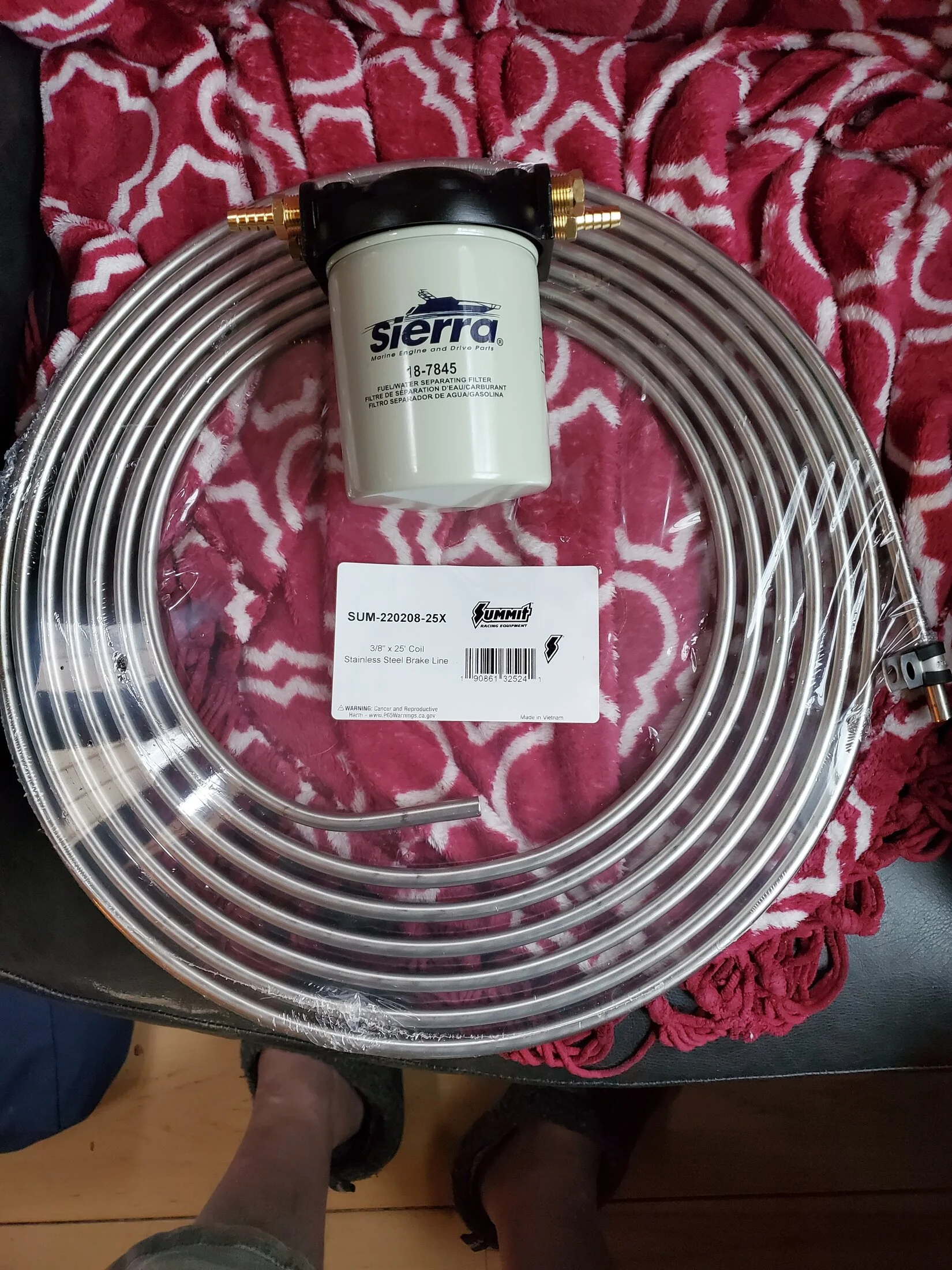

Ordered 2 marine water separator filters from Summit a couple hours ago 😘 great minds😘 and a mechanical fuel pump and filter from @cruiseroutfit 😘.
