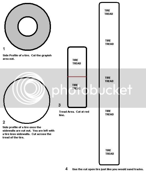

Here is what we do overseas.
Get a large tire with some tread on it, flotation size. Cut the sidewalls off. You will be left with just the tread in a circle. Cut the tread in half and you have just created a traction device. You can cut the tread in half again to make it easier to store and stack. It's a mess to carry once used, but can be very effective.
I've used this for mud and sand.

can you elaborate on this "cut in half" bit please.

I hope my crude diagram explains this. Once you have this made, you would use it like sand tracks. You can cut the tread again so that it's easier to store or have a matching pair. The wider the tire, the better the track.
Cut tires like this can also be used as a poor mans speed bump.
