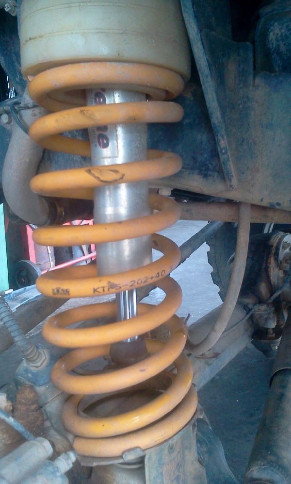

1. Shocks were not DEGASSED and in fact still sitting on 100psi so the leaking issue with AMADA appears to be gone on the newer models.
2. Left front shock not installed correctly and bottom bolt was undone
Problem found see the pic

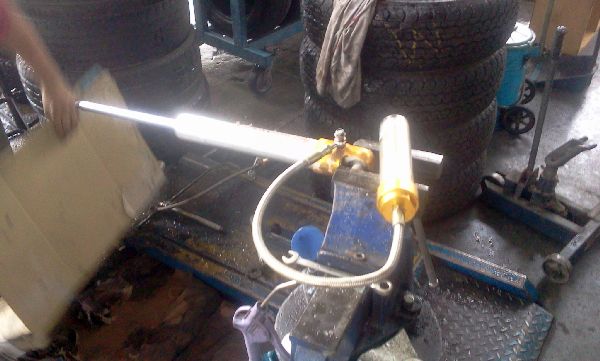

Mervin pulls the shock and I learn how to rebuild.
and it is redampened to a stiffer damping and rebound is changed and I refill it to 100PSI of Nitrogen lesson over.

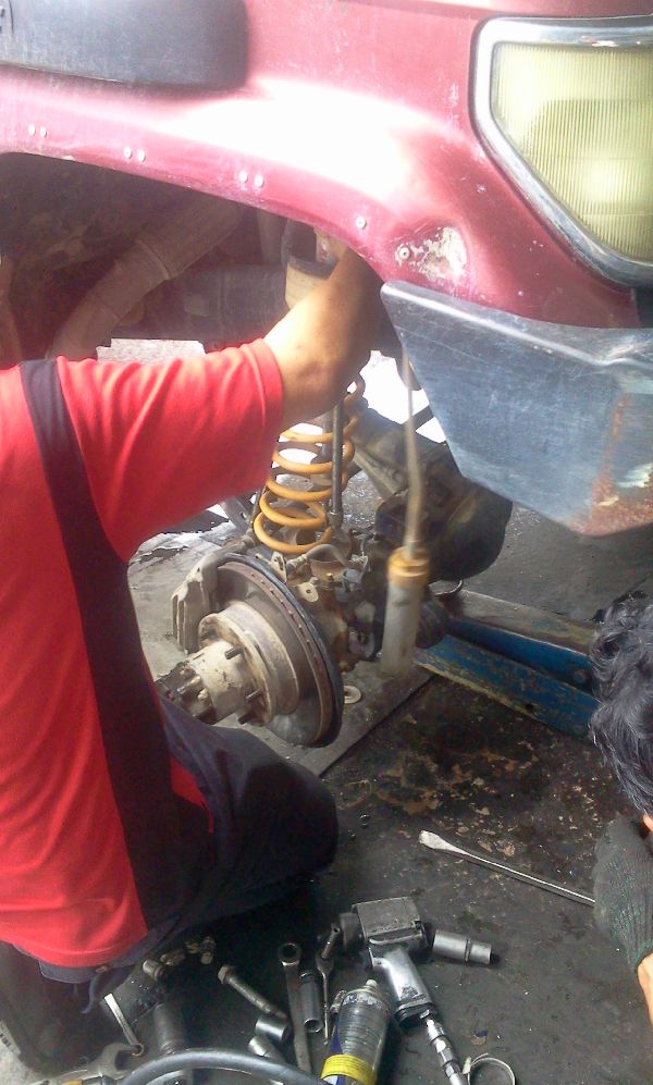

Then the right shock is removed
