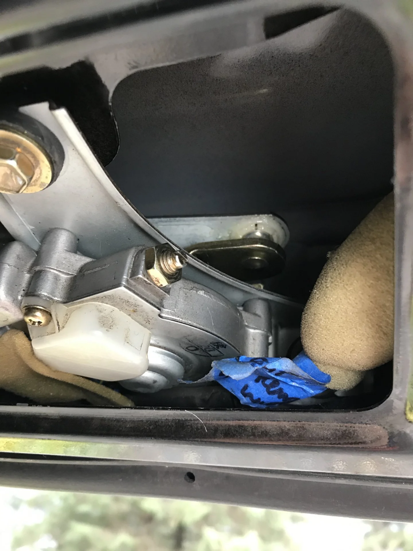

Can anyone help out a dummy with setting this up? I've got it wrong three times so far. Either the blade sweeps the entire window but returns standing straight up at 90 degree angle to window or it sweeps down onto tailgate,-no good- and then not far enough along window. At least it returns to proper place then!
Edit: OK, now I'm thinking that it requires cycling the motor with linkage disconnected to properly set?

Note to self: Take photo BEFORE disassemble next time. Linkage needs to be extended max distance towards driver's side.
That's the wiper arm attachment side of linkage. Here's the motor side. Works properly now.
