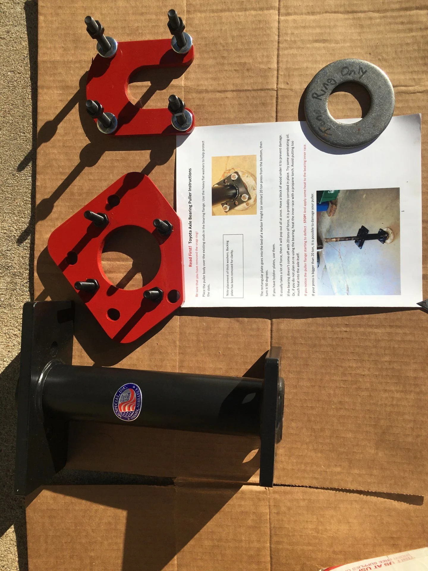

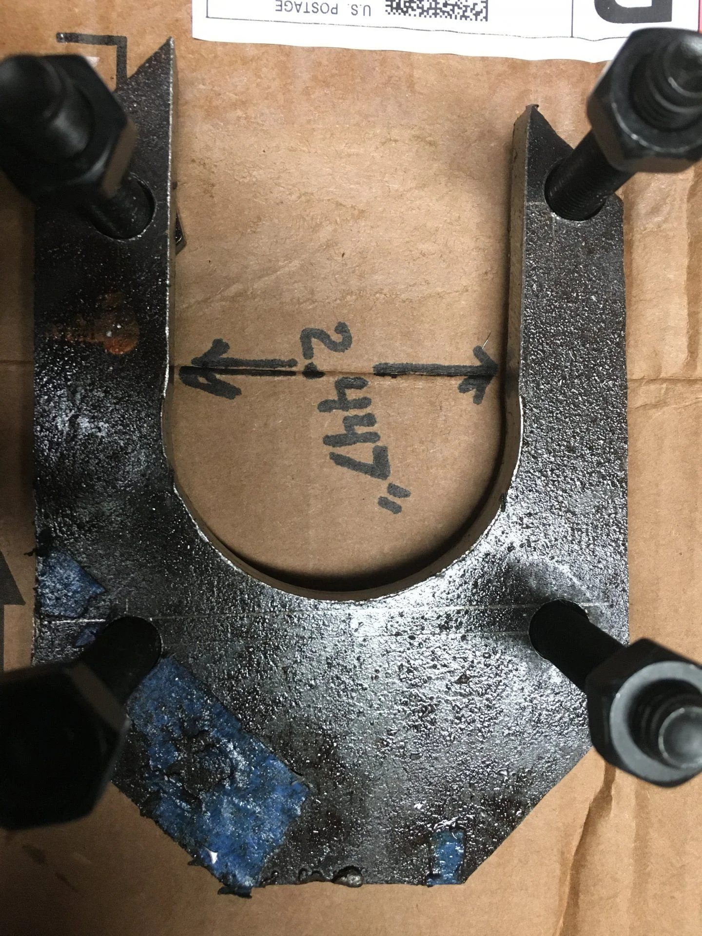

I just got through replacing a rear axle bearing on my son's 100 a couple weeks ago. To remove the outboard inner bearing race from the axle we made a crows foot plate and used it with a prototype Toyota axle bearing puller tool for 100 series LCs that I got from a guy on Ebay named Duane Bier who has a company called MCSPECIAL, INC. out of Omaha Nebraska. The plate I made is the same concept as the crows foot plate used to pull the ABS tone ring off the axle. Attached is a picture of the crows foot plate I made and the inside dimension along with a photo of the prototype tool from Duane we used. I used some 3/8" steel for fabricating the plate which just gave enough room for the heads of the bolts from the kit to clear. Duane may be able to supply this additional crows foot plate with his tool in the future to make the job easier. Also, heating that bearing race with a propane torch just before trying to pull it off will help loosen the interference fit some. If you decide to grind or cut the race off, just be very very careful not damage the seal surface on the axle which is right behind that bearing race. I hope to get around to doing a full write up on the rear axle bearing replacement in the future. Best of Luck

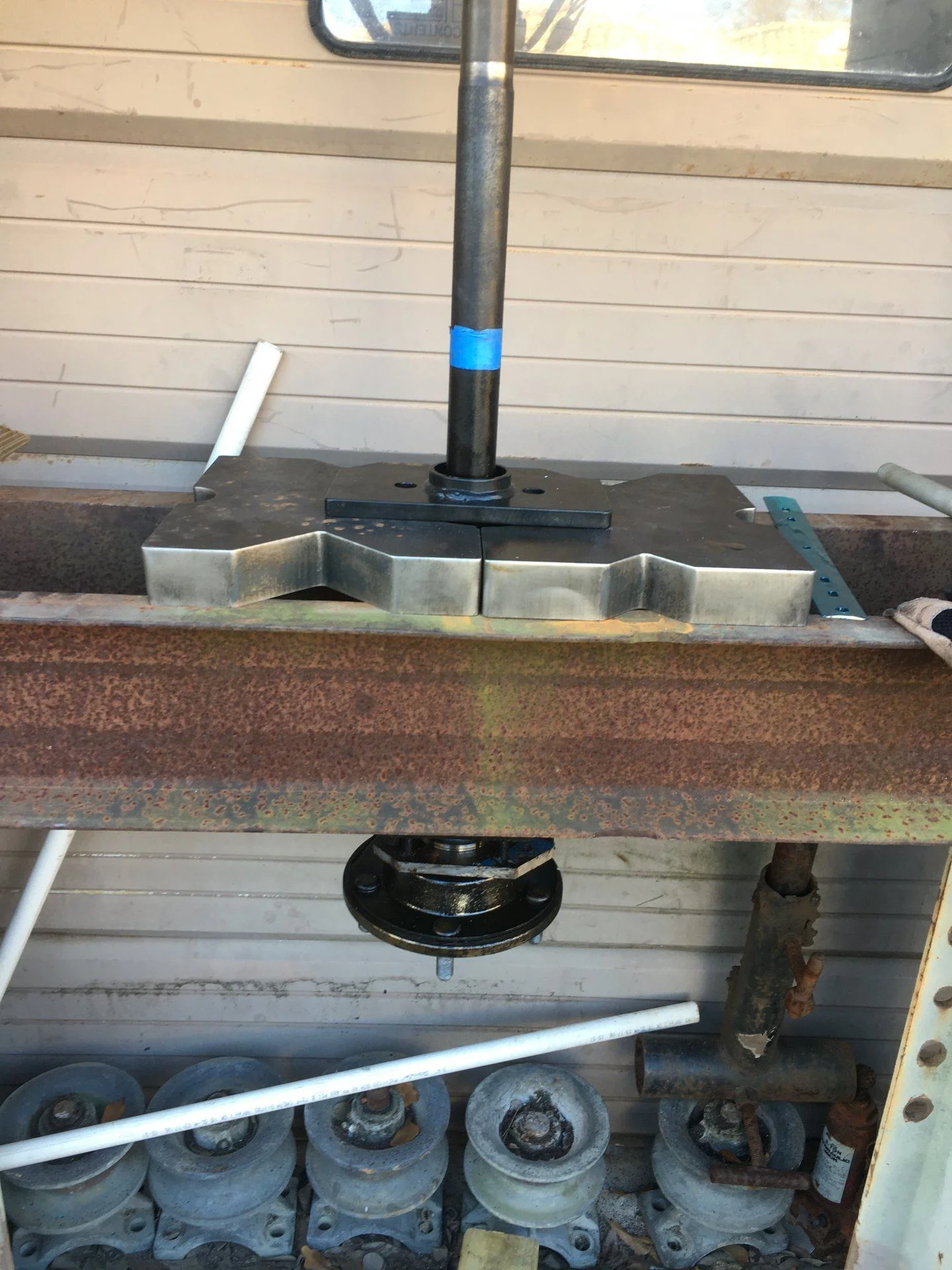

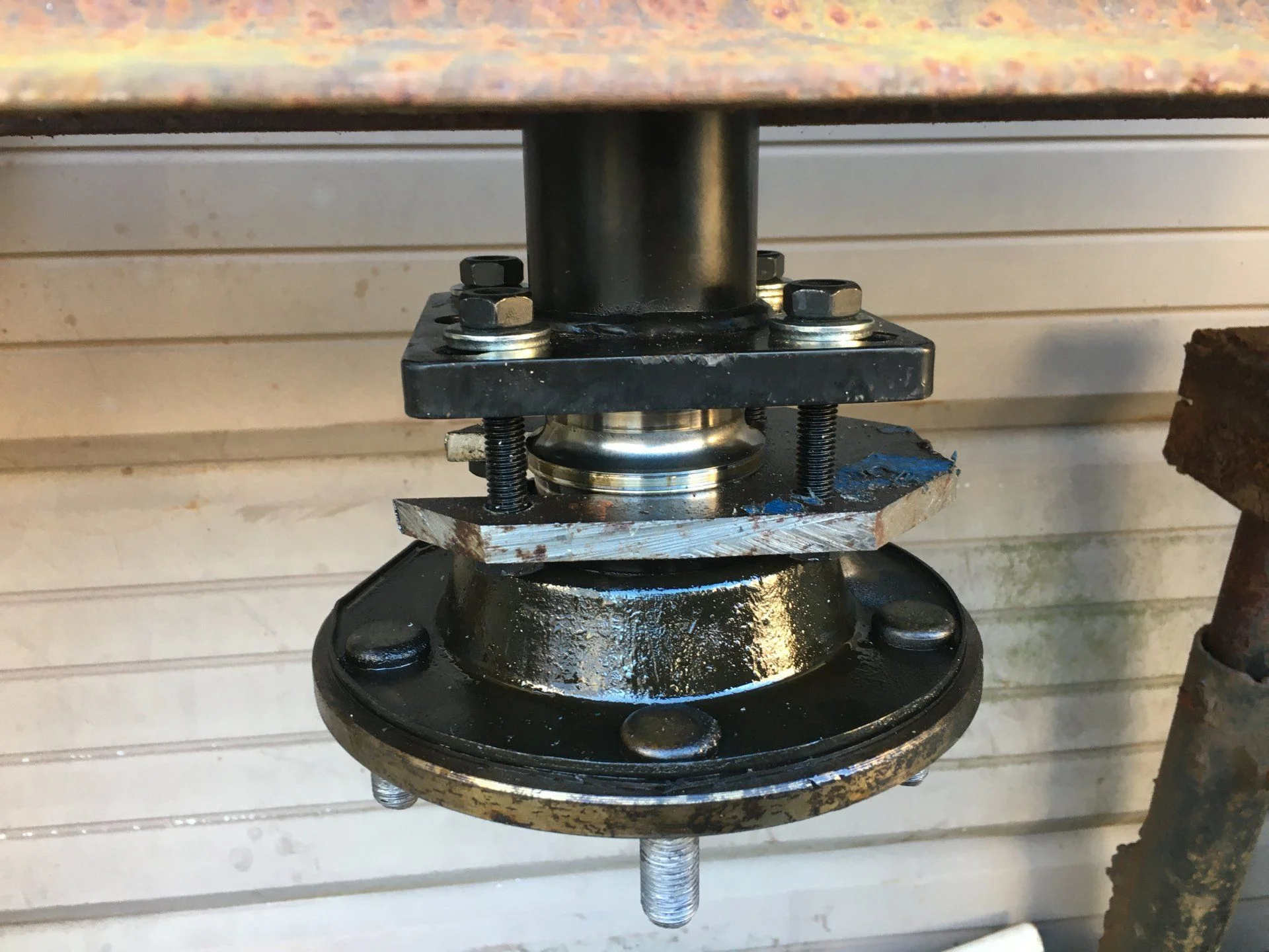

Here are two additional pictures showing just how we used the crows foot plate for pulling the outboard inner bearing race off in conjunction with Duane's tool and a hydraulic press. With a little pre-heat the race came off pretty easy when compared to the first part of the bearing and retainer we removed. Best of Luck

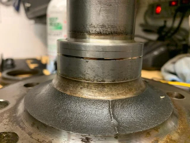

The wheel bearing inner race has been removed as well as the seal that sits outboard of that. Noticed a decent groove where that outer oil seal sits. I can feel it with my finger. There was a little oil residue on the bottom (outside edge) of the inner race.
Any concerns? Can I polish it down at all? Let it be?

It is a bit hard to tell the actual depth of the groove, but from the photo is looks more than just the typical seal burnish mark. Also, if you can feel the groove with your fingernail, then it is likely at least a couple thousandths deep. I would not recommend trying to polish it down, unless there are any sections with material raised higher than the unworn section next to it. There are some ways to build up worn surfaces on shafts and then machine them down, such as hard chroming, HVOF or sleeving, but they might end up costing near as much as a new axle shaft. One possible budget minded option could be to install the new seal in a slightly different location such that the lip of the seal rides on the unworn seal surface adjacent the groove. To help position the seal in a new location you could consider making a spacer/washer so that the seal could be installed to shoulder against it. A spacer with a thickness of about .08" might be enough to get it positioned on the unworn surface. One thing to keep in mind is that this is the outboard seal, so any oil that gets to it, will have had to go past the inboard seal and the seals on either side of the wheel bearing. However, it does provide a barrier to prevent any escaped oil from getting into the emergency brake drum area. Below are some photos with arrows depicting a potential location where a spacer for the seal could be installed. Best of luck
