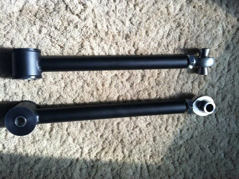

I want to make some new adjustable UCA's for the 80 since my driveline angle is a bit off. I know Slee sells the DIY adjusters, but I dont want to pay that much and still have the stock ends and tubing...
I'd like to just buy some new joints, but Im having trouble finding 2.25 wide joints. I'd like to just stick with rubber bushings instead of hiems or other similiar joints that wear out in the elements.
If there's an adjuster out there that fits 3/4" ID tubing (thats what the stock UCA's are on the truck) then I can go that route, just not for $230 like Slee wants...
PM Ali. He found some cheap weld in adjusters that he used.

yup, they're on the truck. Pretty beefy, and nice quality too! :clap:
Basically you rotate the joint in to shorten or lengthen it to the correct length. The joint is threaded into the shaft of the UCA. To rotate your pinion down, shorten the length of the UCA. To rotate your pinion up and back, lengthen the UCA. I adjusted the UCA until the output flange on the T case and the pinion flange where parallel. The truck drives nice and smooth now. A standard two u joint driveshaft should run in parallel. A DC driveshaft with a CV joint should run in line with the pinion. The UCA's allow you to adjust your pinion angle where the stock ones dont.
