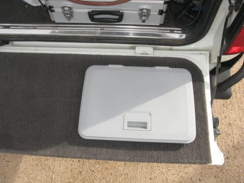

Rear tailgate storage solution on $100 budget.. my FAQ attempt #4

I like the idea of metal. This is one area I don't care about weight savings as the tailgate supports a lot of weight while loading/unloading and using it as seating.
Thinking outloud here. If I go with 2fpower's route, I'd probably remove all the carpet/trim and skin the tailgate with some thin gauge sheet metal, like 10~11ga? Then add these marine doors. I'm sure that would help strengthen the whole thing.
I like where you are going.... maybe some diamond plate aluminum. Easy, light, and never rusts.
With mine full of gear, I am amazed with how much heavier it is. I don't want to add to much more weight.
I just sat on the tailgate and feel no difference before the doors; however, I have 6" of more material than YOUR tailgate with my truck tailgate mod.

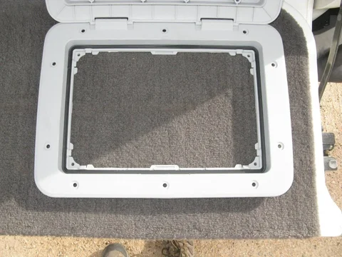

I like it, BUT, would like to find a boat hatch just like the one you show here but that is flush mount? it would be nice to still be able to sit on the tailgate without the plastic "hump" being there. I am guessing there has to be a flush mount recessed type of boat hatch? I already have an aluminum plate that is cut out to the rear 80 tailgate so 2 of these hatches wold work perfect if I could find something in aluminum that is flush mounted?
any ideas where to look?
Bought this a few months ago 30 x 13 but decided the build my own... a great solution and priced right
Here's the best link I found to get these

I guess you gain some clearance with the boat hatch but probably only 1/2".
As for strength I am not at all worried about where I kneel or step and I had to cut out a support for my hatch. I think 13" is the magic number for width to retain the interor braces. Had I not cut a brace I would have installed a second hatch.
This one is only !/2 and Bluetribal is giving good advise regarding size..if you cut a big hole in your tailgate you have zero support from below..
Ask me how I know
