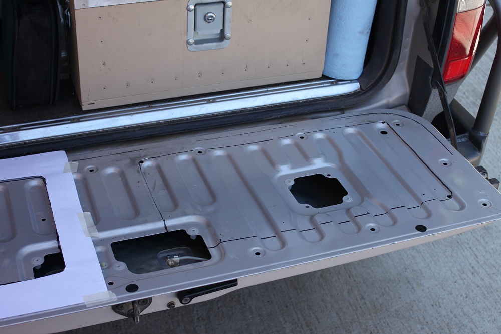

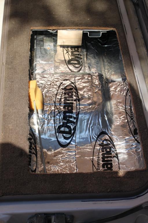

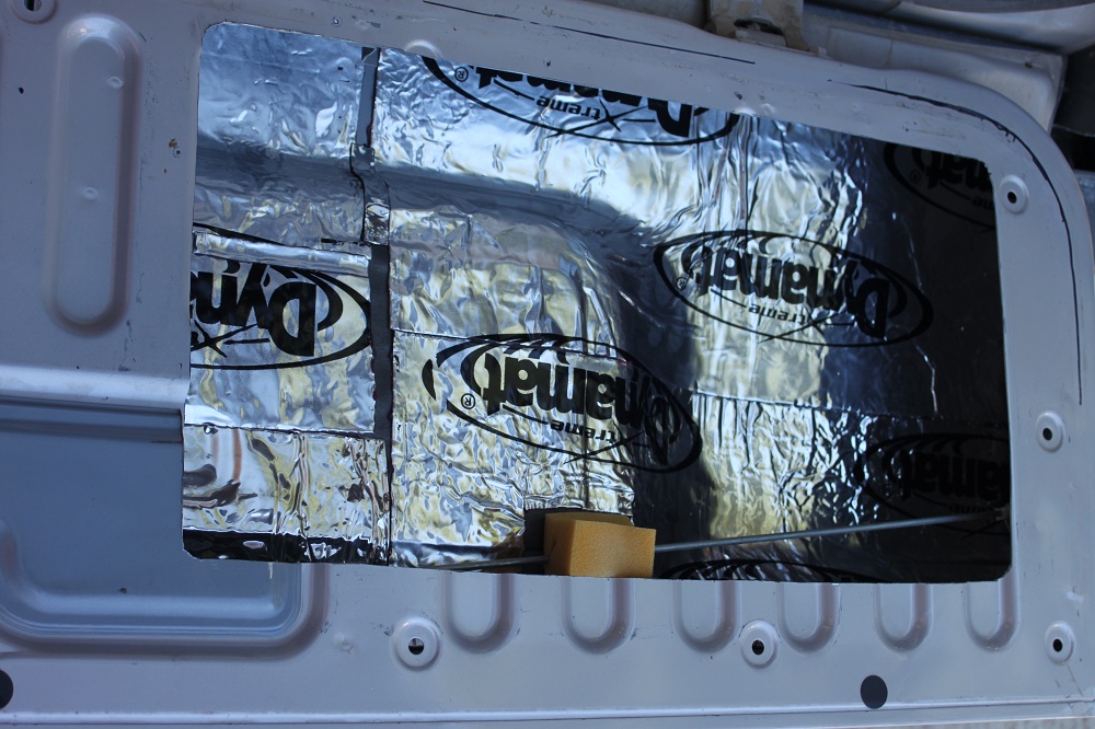

Since I can't seem to win the lottery I have to continue on my Cruiser Budget ways. Everything I have done on my cruiser has been on the cheap or used but done with enough diligence that hopefully it will only need to be done once.
So with that being said, I have had this idea for a boat hatch in my tailgate for almost a year and the other week I was bored and on my Amazon app and I bought a hatch. So here it is and if I were to do it again I would go with the 17" wide hatch and not the 23" so you can keep the supports in the the tailgate.
Not too shabby for $59 and an afternoon.

I would go with the small hatch so you don't have to cut the brace inside the tailgate like I did. I would say 17" wide is your absolute max and 13" tall otherwise you get in the way of the latch mechanism. Even at 13" tall mine overhangs the carpet a little in the bottom corner.

Very nice! I'm not so sure I could just jump into cutting a hole in my tailgate...
That does make me curious about a new part we've designed for truck bed build outs. Might be too big though:hhmm:
Like I said, it might be too big, don't have my LC here to check. Maybe one of you can.
Exterior dimensions are 11 7/8" X 48"
Mounting hole dimensions are 10 1/2" X 46 3/8"

Not too big of a deal, lot's of people are ordering WagonGears full hatch almost identical to what you have pictured.
That should work, what stock holes are you trying to use? I was planning to put two 23" wide hatches in my gate with 5-6" separating them.
I am using the stock plastic fastener holes, going to use nutserts into them with countersunk screws to hold it in place.
