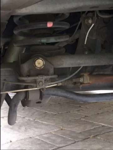

image.webp Hi:
Lately I feel like the rear end is bottoming out on bumps, with no excessive load in the car. The attached picture shows the spring the way it sits with the car on flat ground. It almost feels like the bump stop gap is quite small. Is this a sign that I need new springs?

Measure from the fender lip to the center of the wheels, all four corners, and post up. That will give other forum members sufficient information on how your suspension is sitting to provide advice.

Ok, so finally got around to doing this. The distance from the fender lip to the center of the bub is:
Front 19 1/4 inches
Rear 20 1/24
Does this help?
Thanks
My stock truck is 19.5" front and 19.75" rear measured center of hub to fender. It's a 2003 w/115k with what I assume to be original springs/shocks.

Ok, so I decided to try something else first. I had replaced my Bilstein's at 180K. Replacement shocks were Monroe Reflex. Just replaced all 4 with new Bilstein's, and what can I say, except, such a huge difference in dampening. Truck is almost back to where it was 100K miles ago. Learned lessons, Bilsteoin shocks do soften up over use, and nothing like Blue and Yellow!! Love my Billy's!
