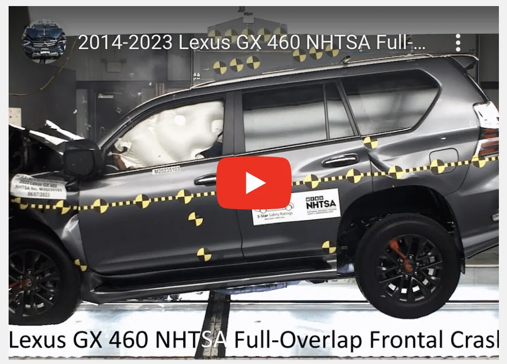

I haven't seen the airbags deployed on a 250, but assuming they are similar to the 150 - there is 1 side curtain airbag per side, which covers front, rear, and 3rd row (if equipped), so there is no need for rear seat occupant detection. The 200 has rear seat mounted additional side airbags. The 150, at least, only has those on the front seats.
200:
150:
460 has second row side airbags as well
2014-2023 Lexus GX 460 NHTSA MDB Side Crash Test - https://youtu.be/yxqsQyY4vyo?si=Dn8nUahEXp9cv5bx
