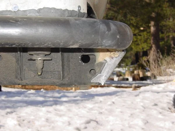

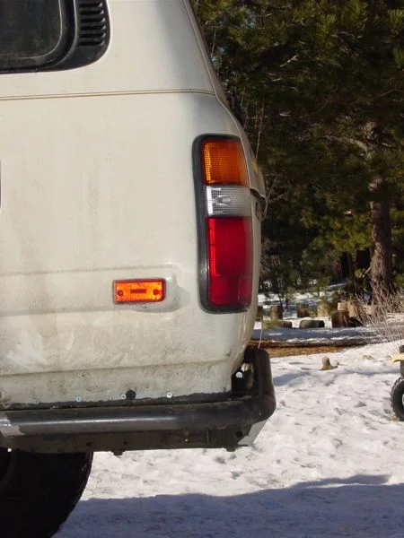

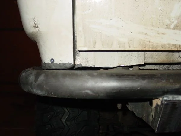

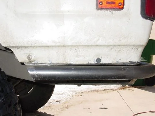

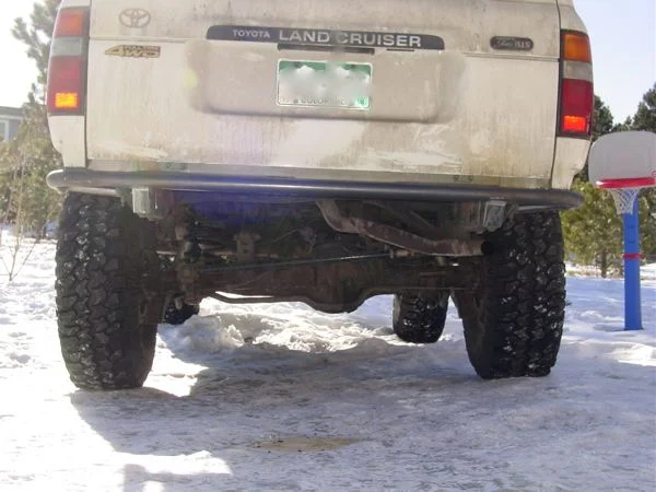

As a part of my rear bumper build at SROR, I cut the rear quarter panel bumperette mounts for clearance. My concern from the start had been that by cutting then off entirely and going with a tube bumper that I'd end up with a bunch of empty space, so I decided to level them with the lines of the body. This meant cutting them about halfway through.

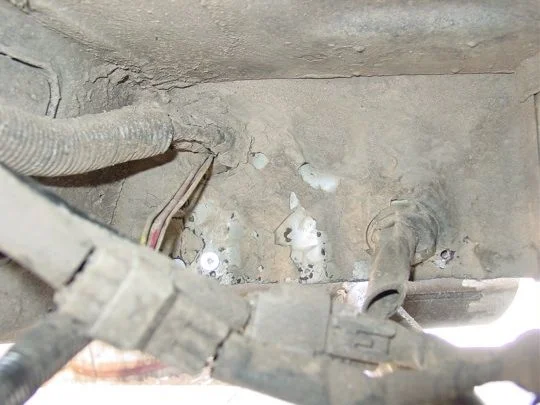

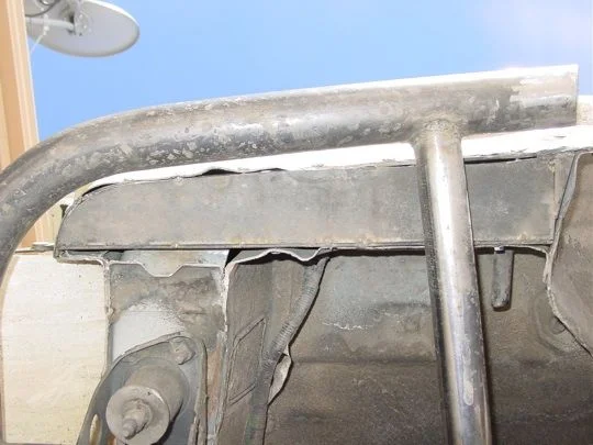

As you can see by the pics, cutting much more than this gets you into relocating the drain tubes on each side - at the halfway point you don't have to mess with that stuff. But you still have the seal them back up somehow.
My plan had been to bolt in some angle iron on the inside of the cut to the sheet metal (one on each side of the opening) and then have Jim (SROR) weld a plate over the angle iron and I'd deal with sealing what was left open. After some consideration during the project, we decided to maybe just bolt on a small plate to the sheet metal to create a thicker weld surface and then weld a 3" wide piece across to the bottom of the plate when Jim had a brilliant idea: bend 1/8" thick 3/4" width stick to the shape of the opening, tack the 3 sides together and pull them out of the opening, weld on a 1/8" thick plate and cut/grind it to the shape of the "mold" created by bending/tacking the 3/4", and then insert the entire thing back in to be bolted together with the self tapping screws I had bought.
It worked brilliantly. The new "floors" fit back in so snugly that they stayed in on their own. I tapped 6 screws through the sheet metal and the side of the new floor on the outside and 2-3 on the inside. The net result is a perfectly level 1/8" thick floor to the cut panels that is now structurally part of the quarter panels. It's not indestructible, but pretty damn sturdy and protected by the bumper.
There is a lot of waffled angle in the inside wall when you cut it off that needs to be filled after the new floor is bolted in. I used a little bit of expanding foam in a couple of these areas and then caulk to create a flat edge. Then I have sealed all of the edges, most of which are very tight to begin with and have very little gap, with "Fast Steel", which is a putty epoxy metal filler that cures in minutes. It is now fully sealed with the new rigid floor and metal filler around the entire perimeter.
The net result is an extremely clean look that is much stronger than attempting to seal with sheet metal. I'll take more pics of the finished job along with the bumper so you can see how the final product follows the lines of the rear of the body.
Kudos yet again to SROR for the extra mile and quality fab work. I was really concerned about how to gain the clearance for a good tube design without butchering the panels and/or ending up with a mess that was difficult to reseal. We nailed both of them. :cheers: to SROR! I hope to see Jim be able to market and sell these for DIY cut and seal jobs because this is such a barrier to a custom rear bumper.
The first pic shows the side view, the second shows the passenger side view from underneath, and the third shows what you have to deal with by cutting much more (drain tube, etc on the driver's side - the passenger side is cleaner but also has a drain tube).

Nice work Nay and Jim! I am just wondering why there are so many extra bends in your rear quarter where you did the cutting?:hhmm:;)
That's the way the inner wall is formed. I have no idea why :hhmm:
It gets worse the more you cut, there's an inner piece as well that you have to deal with that starts right about where I cut.
The sheet metal in the rear is way too thin to effectively weld. Now, the "floor" we built is welded to create that 3/4" tall wall that we bolted the sheet metal to. I'm not sure how you'd clearance for 42" IROKs (:eek::D) and not do some welding.
Think 3/4" width 1/8" thickness as a good insert piece as you scope it out. That stuff bends around the various body lines easily once you open it up.

I pulled my 80 in the garage last night to start cutting the 1/4s... Any more pics of how you did this would be appreciated!
Here are pics of the basic sealing job using the Fast Steel. This stuff is great to work with - you knead it in your hands to mix the two elements and then you have 3-5 minutes of working life where it is putty. Then in an hour its fully cured and hard as, well, steel :hillbilly:
From the first pic you can see that I kept the cut essentially level with the body line from the rear so it wouldn't be a visual gap. I just marked a start point and then used a level with a sharpie to mark the cut line. Those panels slope downward as they approach the tire, so the cut is not entirely level to the body line that remains.
I used a grinder with cutting disc, which is a lot of work because the disc wasn't big enough to do a single cut. I had to remove the outer side first, clearance as needed stuff inside, and then do the inside cut. I was conservative on the first cut so I could grind it level later. I still cut a bit high in spots, but the floor solution we built leveled it all back out, and you can see the Fast Steel covering the seam where the sheet metal hits the new floor.
It would be a ton easier with a sawzall for sure :hhmm:
Fast Steel is sandable, grindable, drillable, paintable, so even though the putty strips on the larger gap areas look a bit :hillbilly:, it's the underside and the stuff is completely rigid and bonded. I have some leftover and am going to give those larger gaps a final surface coat, but I doubt I'll bother with any kind of sanding. Just going to prime and paint. I did use some caulk in the larger gaps, but upon retrospect, it would take maybe 6 sticks of the fast steel to do it all and they cost $2.50 each. Kind of a no brainer to have a fill of that strength.
Hope that helps.

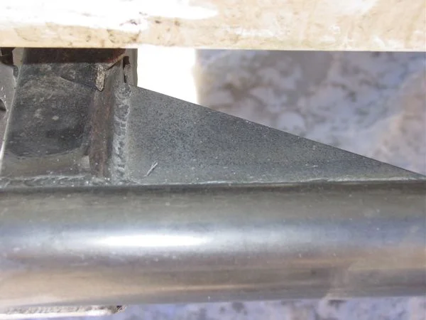

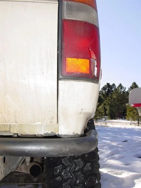

Here are some pics of the initial design (sorry the first pic isn't level due the the glacier that I call a driveway :D)
In terms of frame length, we simply cut the stock stuff off at the points it mounts to the bumper, leaving the frame alone. The bumper tube is set into the top of the frame (welded), and then the frame is cut at an angle and sealed.
The reason I did not want to pull it in any tighter you can see in the third picture - if you run a level against the outermost point of the hatch (the middle of the upper hatch) down to the bumper, the result is the bumper is just outward of that point by about 3/4". If it was any tighter, then backing into a pole would mean the hatch would take impact before the bumper.
With the "slider" angled trim, the underside of the frame has a rear point that is probably 4" shorter than stock.
One additional point that becomes pretty glaring is the crappy placement of the exhaust. I now have room to run it over the frame rail and into the open corner pointing downward at the level of the bumper. When that is done, it will disappear from view (and impact placement).

There is not a crossmember in the same way the stock setup does not have a crossmember but is triangulated. On initial design, we added gussets from the frame inward (first pic) to create that triangulation. When we do the d-ring mounts, which will be right at the frame mount, we are also going to add gussets from the frame out to the corner.
I am thinking a simple sheet of 3" wide 3/16" across the entire length (frame to frame) would provide final reinforcement, with the existing gussets providing triangulation both to that piece as well as the tube. That would be nice visually when looking down on the bumper (tube) as it will fill the gap between body and tube. Although that might add 7 or 8 lbs :eek::rolleyes::D.
As far as side protection, I am not planning wings or hoops right now. The bend is tight around the corner to follow the body lines, and we did not do a 90 degree angle. The body line goes out as you approach the wheel well, and the bumper line follows this. I could still get some denting from a low angle lean, but the bumper will stop any damage more than a "pop-in" unless I am leaned it up high on a tree or rock, which no bumper will stop.
Again, if you use a level against the widest point of the rear quarter panel, the wing almost protects it along the entire length, but that part of the body is not a straight line and it's a balance between tucking and protection. I had nothing out there for over a year, not even plastic, so in the generally more wide open Western wheeling this was the balance I wanted.
In the picture it may look like the bumper extends out past the tire, but that's just the angle I took it at. It is fully contained behind the tire tread.
