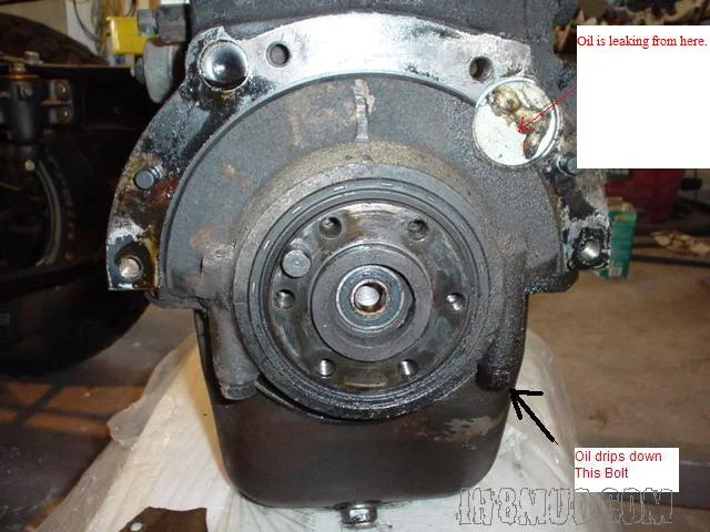

I hijacked someone else's picture, but I am trying to show where my leak is. The drip comes down the bolt shown. I replaced the oilpan gasket and still have the leak (hopefully the permatex gasket is not still leaking). The bolt is tight, I checked it. I was thinking its the rear main seal, but wouldnt the leak be below the seal and not to the right. The 1976 2F motor is still mounted, so any suggestions would be appreciated.
You can remove the bolt and add some sealant and re-torque it..... just to help narrow down leak possibilities.........
I agree that the cam plug is often the culprit, but since I have Ed's motor (the one pictured) I can tell you it was the oil galley on the opposite side and the side cover gasket (same side) that were leaking the most.
That engine doesn't leak at all anymore! :D
I doubt your leak is coming from the crank cap bolt itself, but as Grant says, it can't hurt to torque it.
Oil tends to travel a lot and can end up dripping quite a way from where it exits.
I assume I have to pull the motor to fix it?:mad:
Attack it from the rear....
remove trans & bell housing......
reseal all possibilities to eliminate future problems.....
I agree that the cam plug is often the culprit, but since I have Ed's motor (the one pictured)Good eye;) I can tell you it was the oil galley on the opposite side and the side cover gasket (same side) that were leaking the most.
Because you KILLED IT!!!:D
I doubt your leak is coming from the crank cap bolt itself, but as Grant says, it can't hurt to torque it.X2
Oil tends to travel a lot and can end up dripping quite a way from where it exits.Roger that, I'd bet on the side cover
How much is it leaking anyway?

Mark, it will be difficult to remove the bellhousing as Grant suggests without pulling the motor.

Bell housing removal
After trans is removed .......
lower supported engine till back of the head rest on firewall....
remove flywheel and starter wires....
remove 6 bell housing retaining bolts and it'll fall off.......no biggie

You have to remove the rear engine mounts too, right?
I'll try that next time I'm messin'
Its not bad, mayber 5 drops per day.
That's the Toyota oil level gauge. When it stops leaking, you know you're out of oil.
I would not mess with it then. Wait until you're doing a clutch and address it then. JMO
I think the first step in locating an oil leak is a trip to the carwash. All leaks get blown to the rear.
