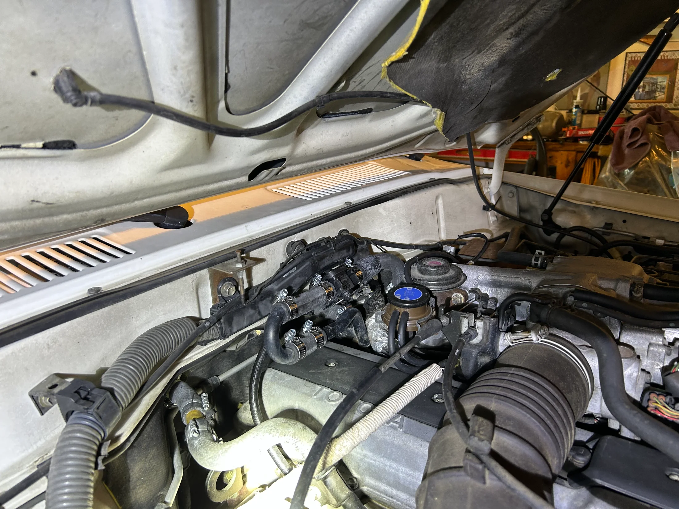

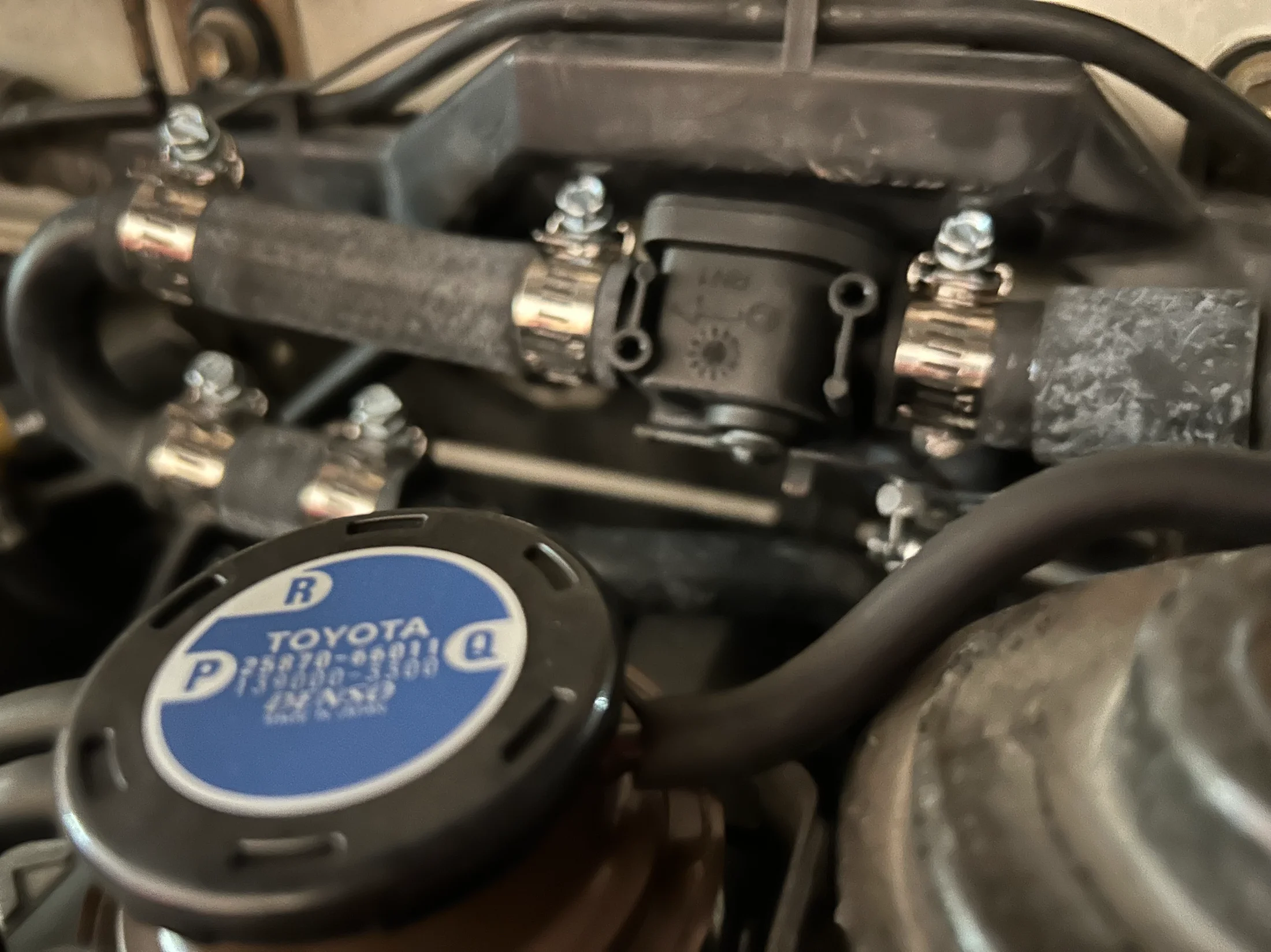

Might help to take a photo or two of the heat control valve and the hoses/pipes in that area (from a few feet away) and post them up.
Thank you Kernal. I believe the system is as designed. All of the heater hoses were replaced recently as a part of normal maintenance that I do. The problem existed before that as well though. The cable is connected to the water valve and it is moving up and down as you change the temperature setting on the dash. When on cold, the lever is in the UP position and when on warm, the lever moves down towards the motor.
General view
Temperature lever on cool below: - lever is in 'UP' position
Temperature lever on warm below - lever has moved towards the motor/firewall:

Yes, I am asking about how to adjust the cable running from the temp slider on the control panel to the water valve directly above the rear of the engine on the firewall. I pulled the little clip off that holds the cable, but the sheathing doesn't want to move easily. Don't want to break anything. Cable is detached per picture and I need to pull it out a little more. Just making sure there is not something holding the other end of the cable down or something else that I need to disconnect. The cable itself moves freely in the sheathing, and it is fully extended in the picture.
I was able to pull the sheathing out of the firewall grommet about a half an inch or so and reseat the spring clamp. Now the valve is traveling all the way to the stop. Test drive this evening. Thanks to all for your help.
