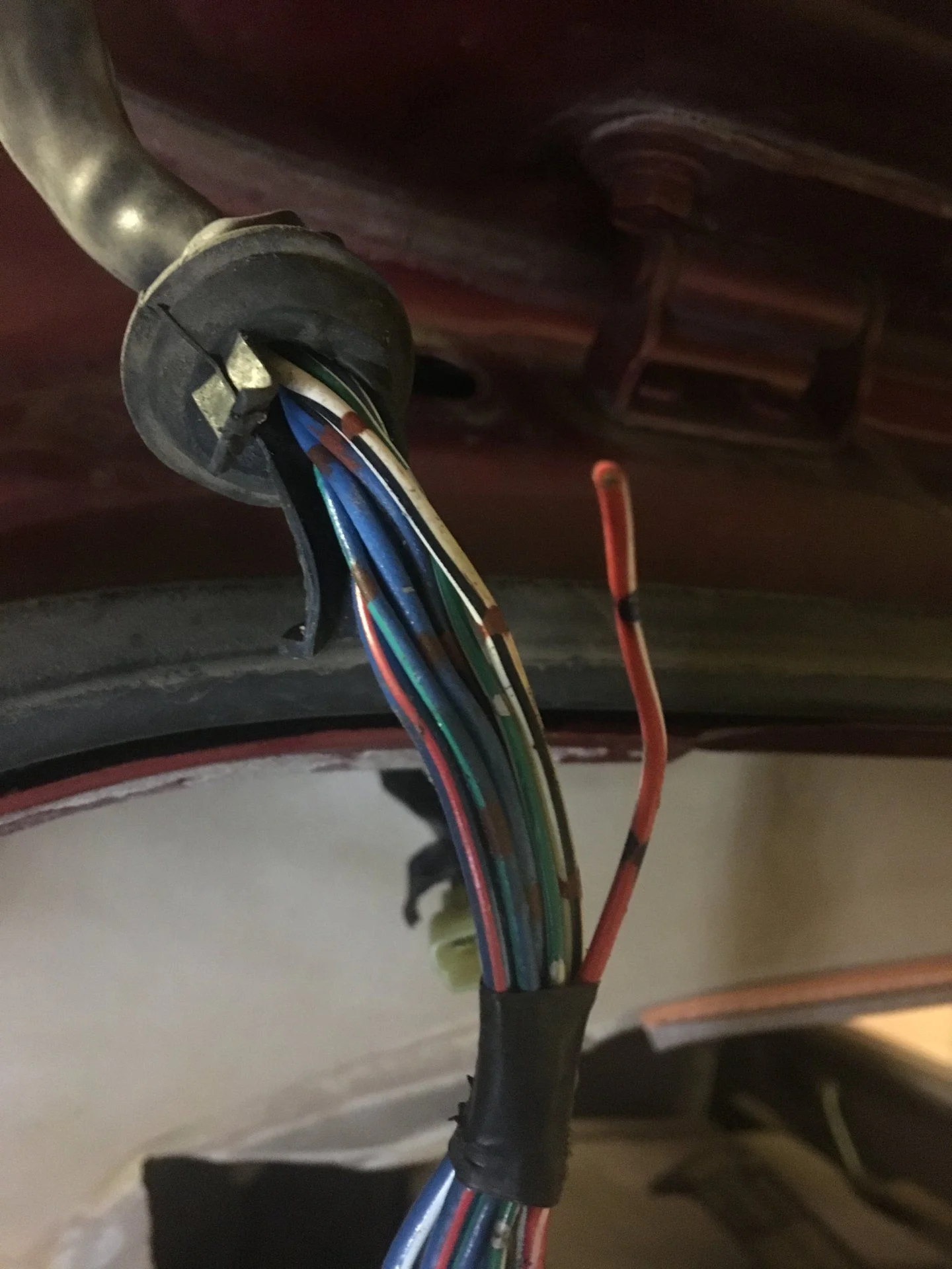

Mine was also intermittent, it ended up being the harness. The wires work hardened where they go through the door to body rubber boot. There was also corrosion in the door harness plug.
