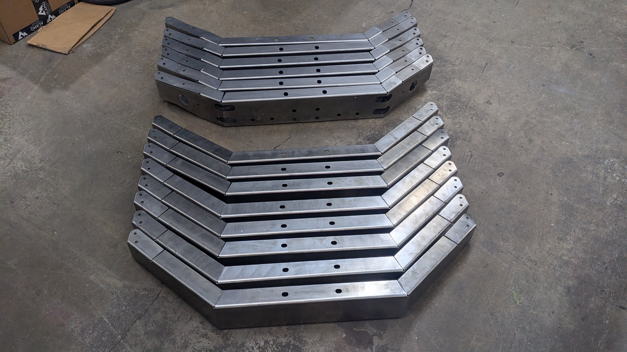

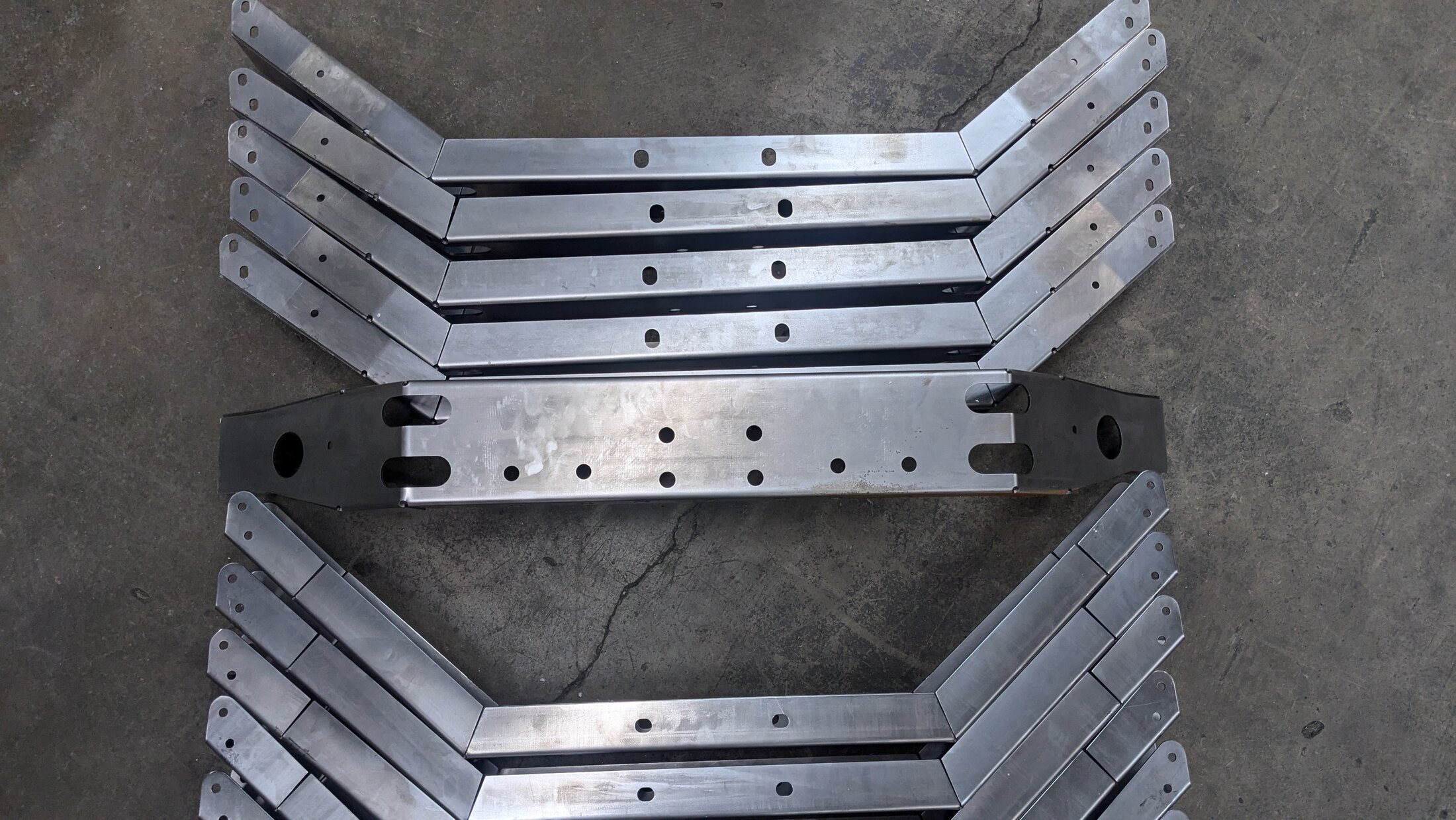

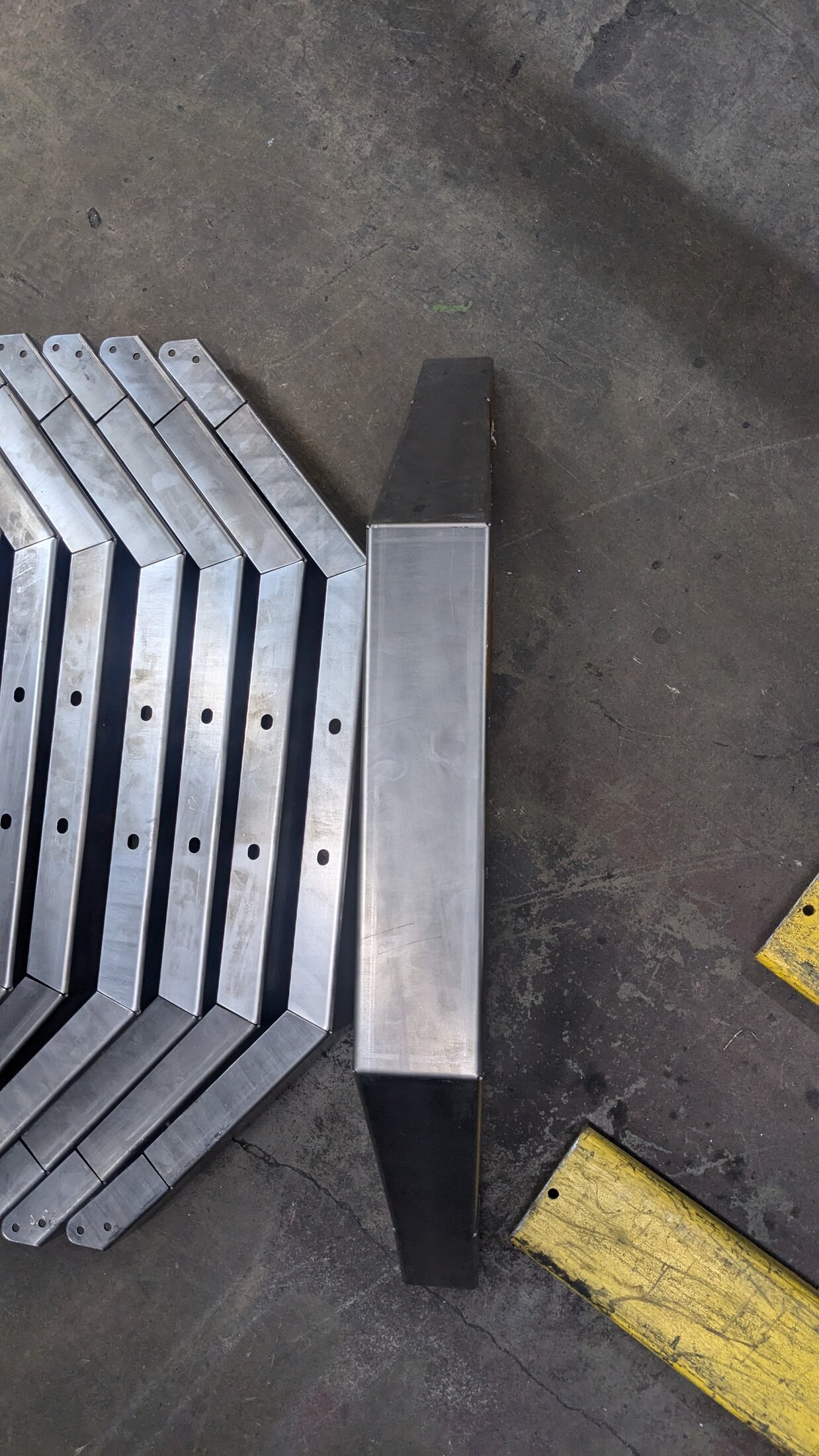

It would be a challenge to find a replacement section in good shape worthy of a transfer. I know @TRAIL TAILOR made these at one point but not sure if he's still making them. He definitely has the C-Channels in stock and I just replaced mine. Pretty straightforward, especially since you have the frame out.
