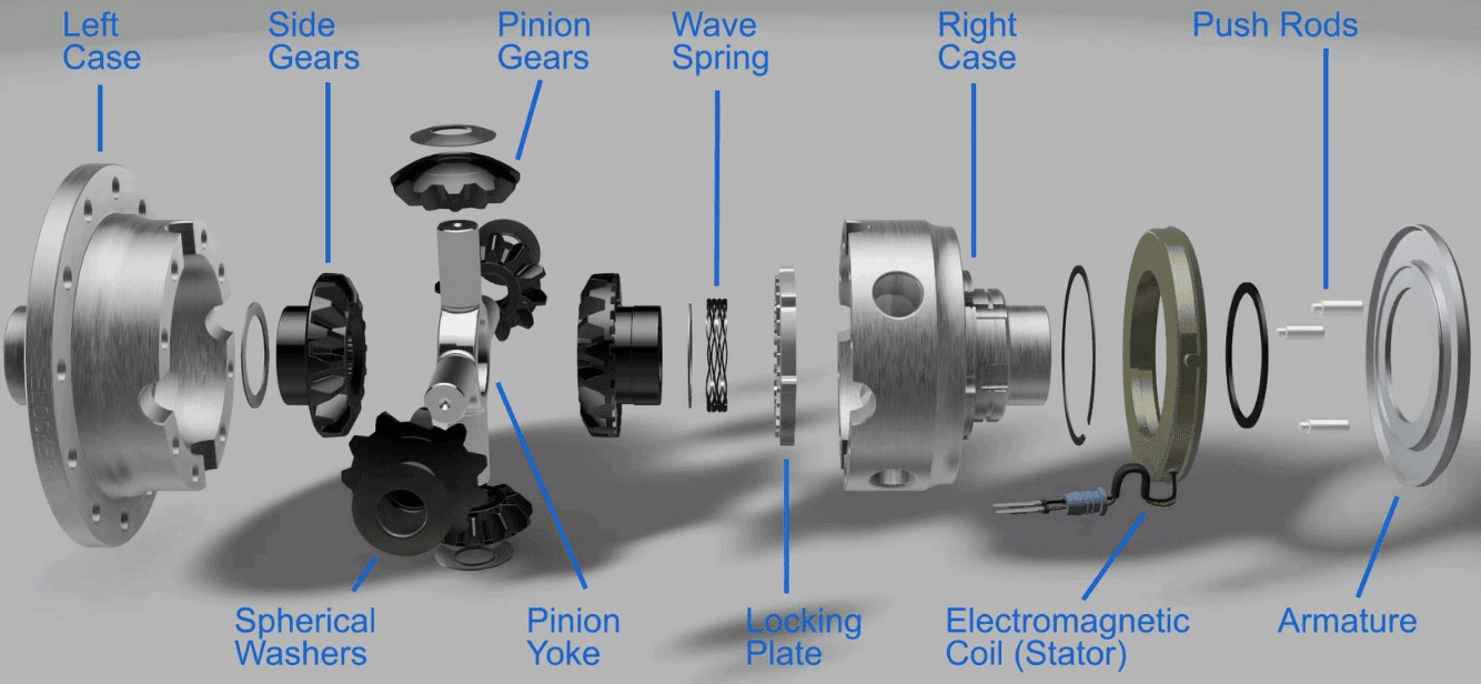

I looked into this earlier this year right as the new Eaton LC fitment came out. What I found, talking to the Eaton engineer, is that the new Eaton part is actually largely the same, if not exactly the same design as the current Harrop. Just with US distribution and branding (which is a great thing for warranty and such). Harrop's design is actually licensed from Eaton originally. The Eaton can be found a tad cheaper without the import overhead.
I was also excited about the new positive locking design, known as the Elocker4 "direct acting" mechanism. As I understand it, it's only available for larger Dana 60 and 70 applications. Not available for the LC.
I do hope I'm wrong though! Looking forward to your findings.
Both Eaton and Harrop logos on my locker
I will certainly report out once I get them installed later in January. From talking with Just Differentials and reading the Eaton site, this new design does not experience the engage/disengagement. And they added the Land Cruiser application for the Elocker4 earlier this year. Hopefully it works out as stated. :) Oh, I pulled my unit out of the box just now and it is only stamped with Eaton. No reference to Harrop anywhere on it.

Hate to break it to you, but that is still the original Eaton ramp pin based design that Harrop licenses. The exterior visible ramp and pins give that away.
Personally, I don't think there's as much issue to the locking/unlocking as its been made out to be. When in drive, it locks in less than 1/10 of a turn differential if that.
The newest Eaton4 design has rods but they are internal. I could very well be wrong and the differences could be internal but I did do quite a bit of research.
Thanks for the pic.
Perfect....Errr I will reach out to Just Differentials and clarify. Definitely want the correct information being shared. Thank you for your help.
