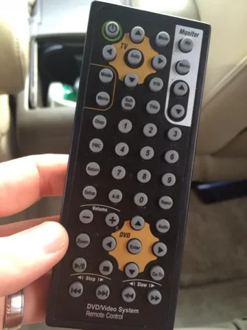

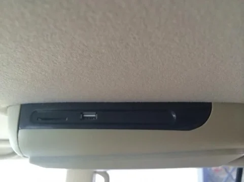

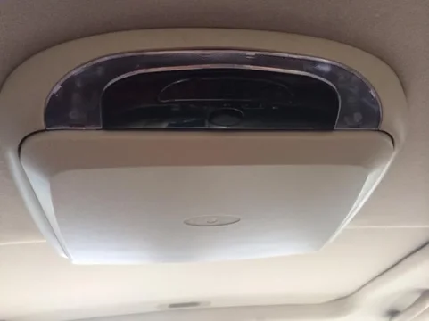

I just picked up this new to me Lexus GX and it has a pop down rear monitor. The video seems to work fine weather via USB or the DVD player, but I can't get any audio at all. I get no sound through the speakers into no sound through the headphones. My question is: does this look like a OEM monitor, or was this installed aftermarket? It looks nothing like what's in the manual and I suspect it is not original. There is no DVD changer in the console either. Either way any suggestions on how to diagnose the problem?
The rear screen / DVD is aftermarket, the rear audio control is OEM.
