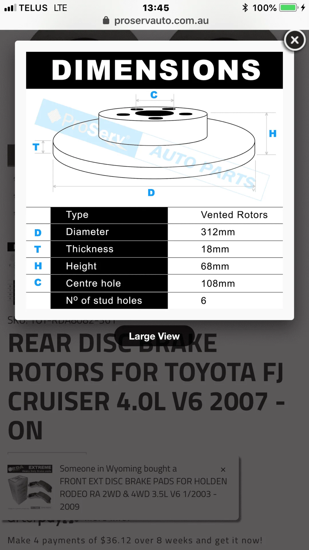

I did find rotor sizing specs to compare 79 series rear rotors to fj/pre99 70 series rear rotors. Same diameter while the overall height of them changes. Makes me question does the hub assembly change (yes I know they are 5bolt vs 6bolt) but what else could change this?

Is this true? 80 series rear rotors are ~335mm to the 7x 312mm, yet run the same calipers. I assume it's because the backing plate caliper mounting position is slightly different?

80 series rotors will work but have a deeper body, so you’ll need to source 80 series hubs otherwise it won’t work with 70 series hubs. So your track will get wider by about 1.25” on each side
