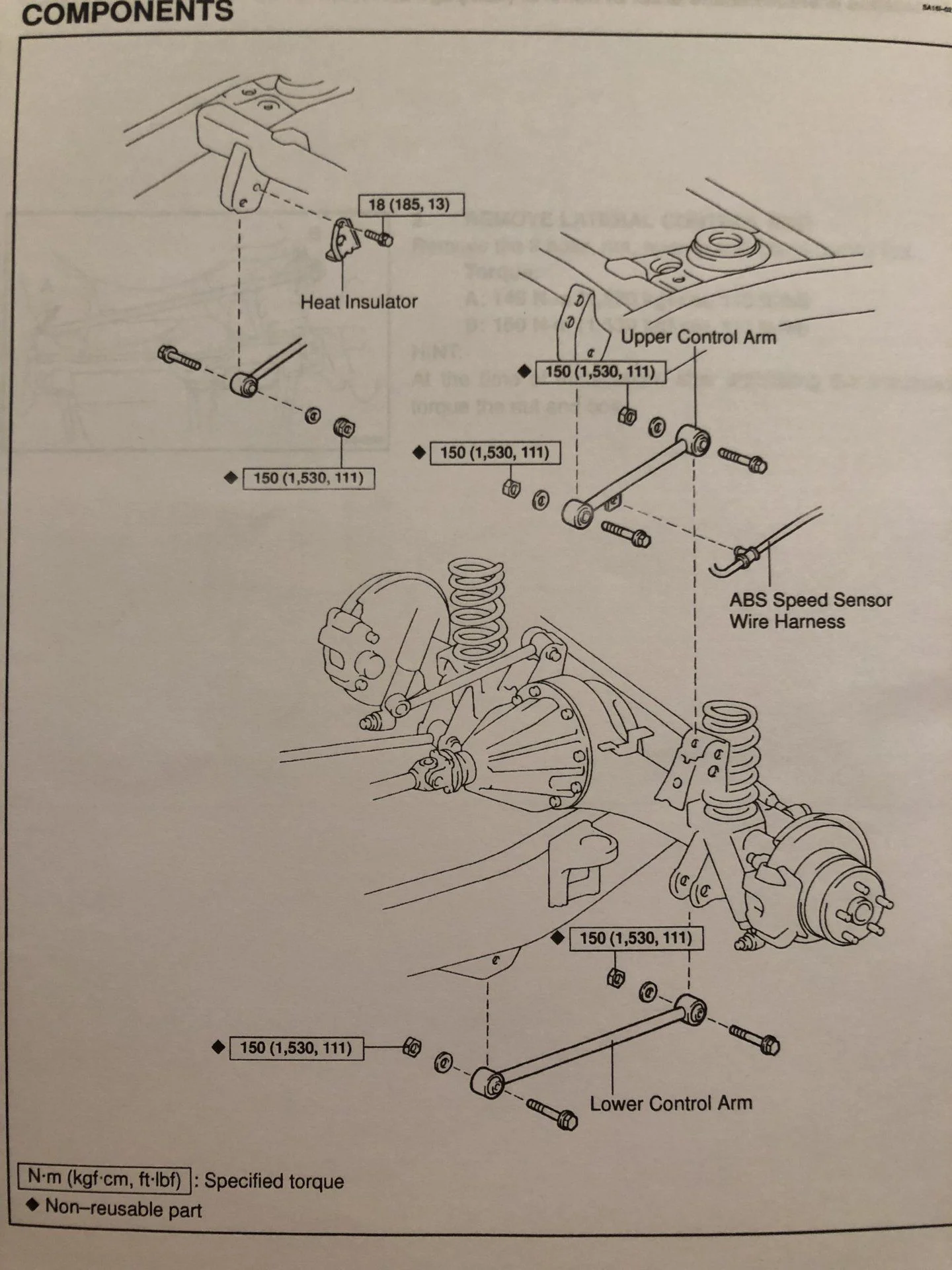

Got new bushings in the mail today for the rear upper and lower control arms. Could someone please post fsm instructions that includes the torque spec for both.
Many thanks
Woo f’n pig
Well the 80 sub forum indicated 130 foot pounds if i read it right but i believe that series lc had heavier duty control arms and possibly a larger bolt. Maybe i’ll just torque around 100 and use locktite blue.

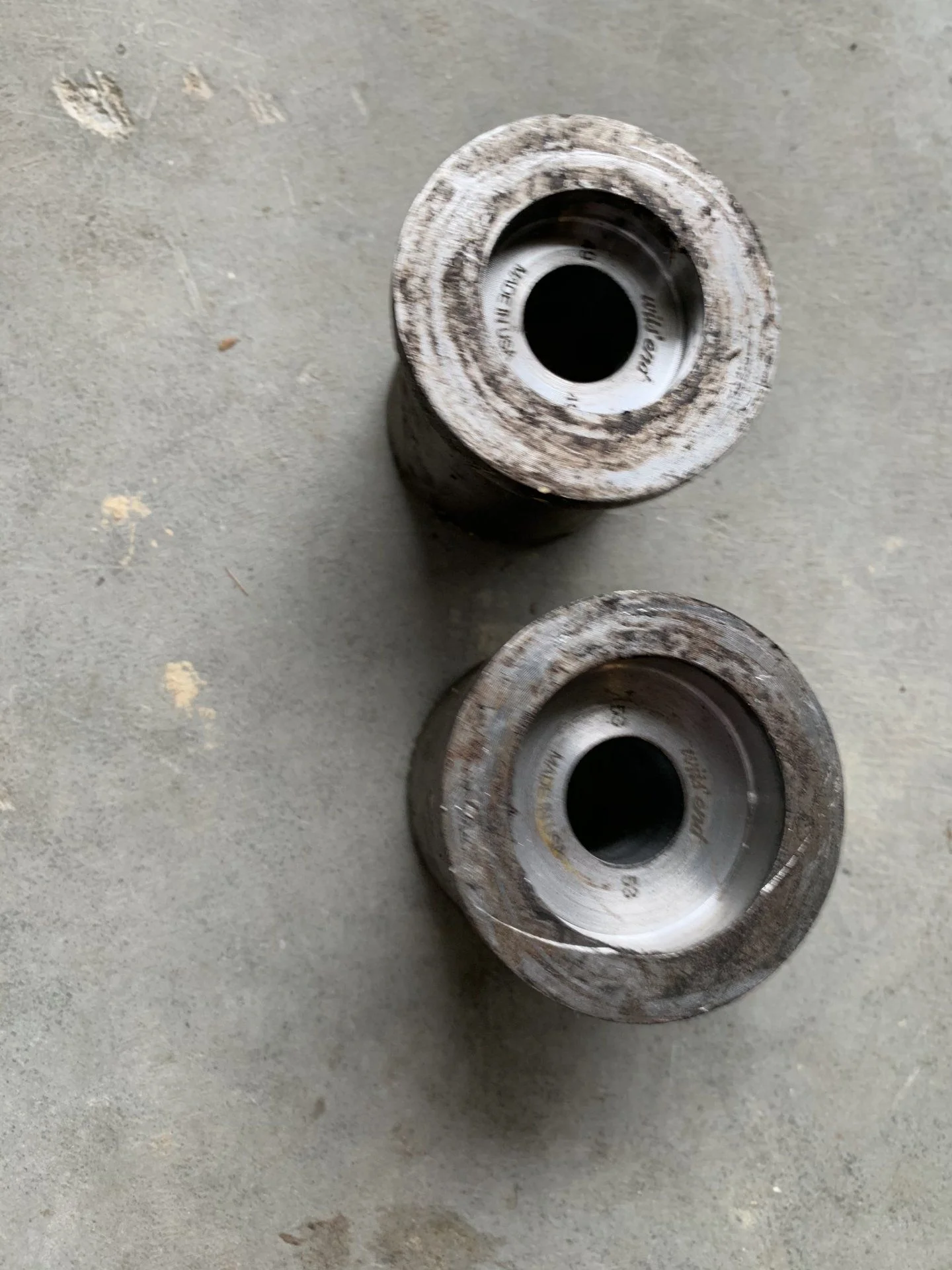

Got one of the lower arms off but the ball joint press i’m using doesn't have a suitable socket to match the bushings diameter. Does anyone know what size press i need?
Furthermore, I could run into this again with the upper arms and if anyone knows the size socket that would press those bushings out I could use that info as well.

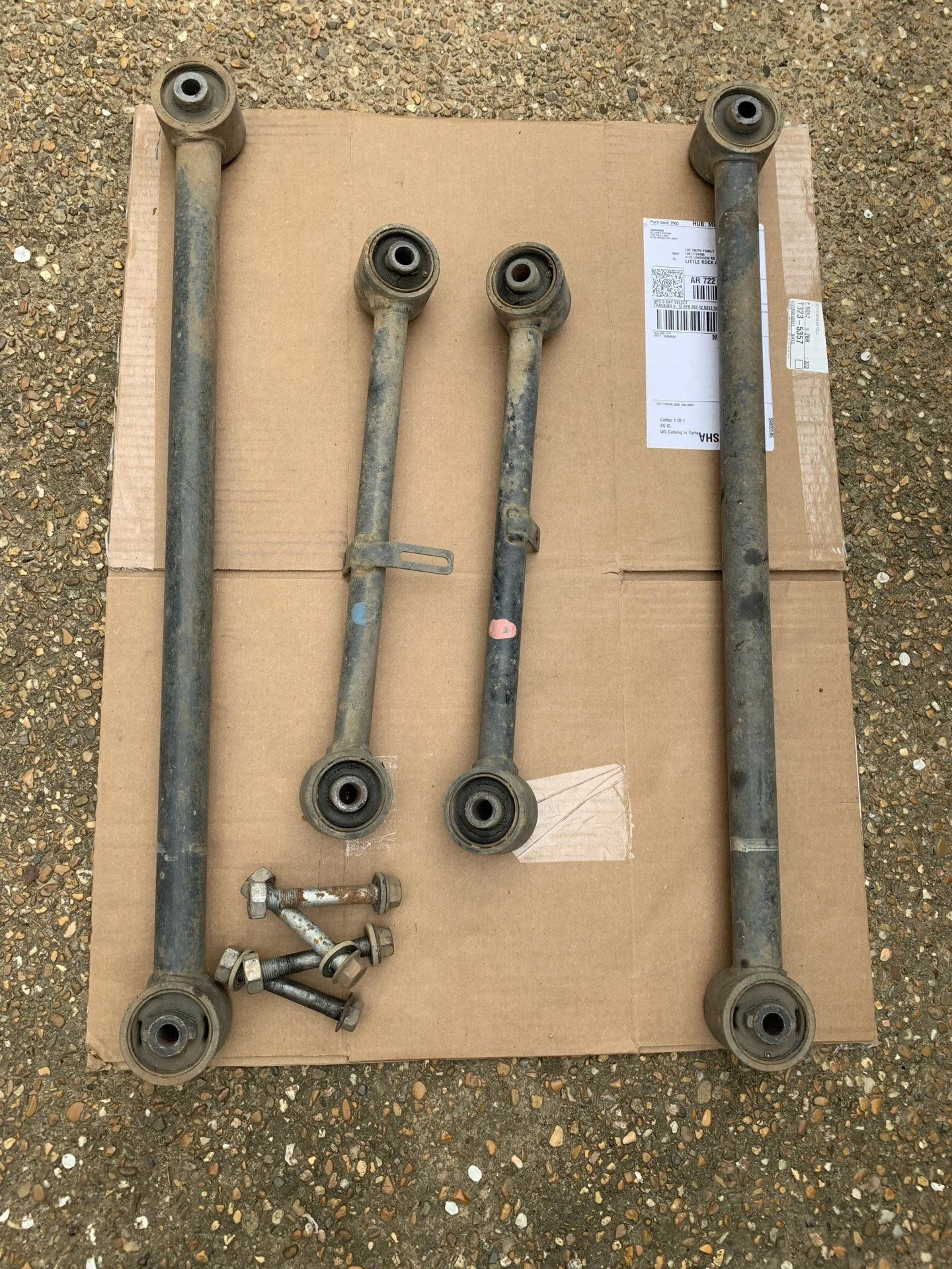

Finally got all 8 bushings replaced. I used wits end press to push out old bushings and to push the new ones in. (Used a large press)
The control arms come off easily (did in my driveway without jacking the vehicle up) and the reinstall wasnt bad. One bit of advice (for reinstall) is to have someone sit in the car to slightly compress the rear coil springs - this will allow you to get the bolt in. Otherwise you fight the spring.
After i reinstalled the uppers (i did those first), i noticed the axle had moved back and the lower arms were no longer lined up - it appeared to have moved about 2 inches. I used a ratcheting strap to pull the axle forward until the holes aligned and whalla. If i had the project to do over, i’d buy new control arms and do the whole project in one afternoon.
Pics show the old bushings, the lower control arms cleaned up with the new bushings, and the Wits end press.
