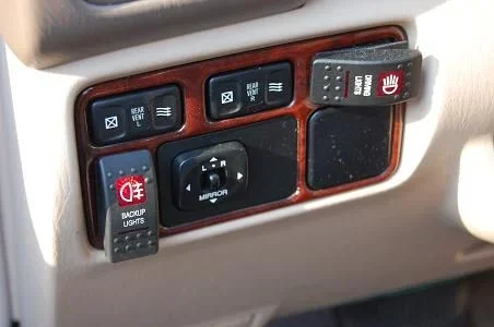

You might be able to tap into the reverse sense wire and add your own switch to trigger it. Then it'd come on when you are in reverse or when you switch it.

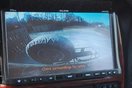

Mine has it's reverse signal line tied into a toggle switch, the reverse signal is not tied in so it does not go on in reverse. The P.O. did the install, but it works great:meh:
When the red light is on
The B/U screen is on;)
