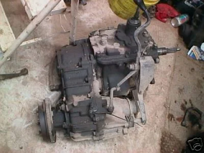

Some 45 series had a parking brake mounted on a split case starting in late 1980.
Never seen one .. but anycase I thought it's easy to adapt a small disc brake system on output shaft in any t-case. ( it cost .. ! but it's easy)

Here is one from an HJ47 troopy.

I hate this dude .. did you think how much problems I can save if I know /found one of this here .. :eek:

Don't kill the messenger :D
