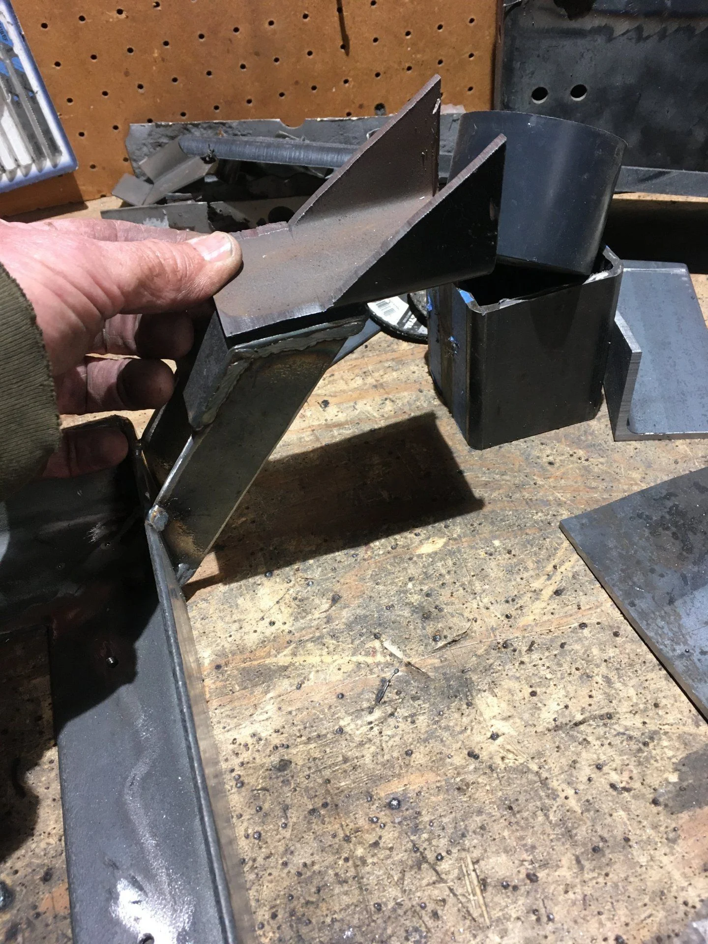

I think it’s called kurfing. I kurfed A line about 1/3 -1/2 of the thickness with a thin cutting wheel and then heated and bent

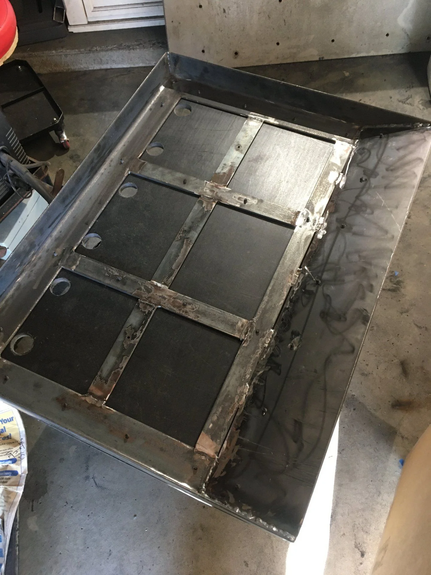

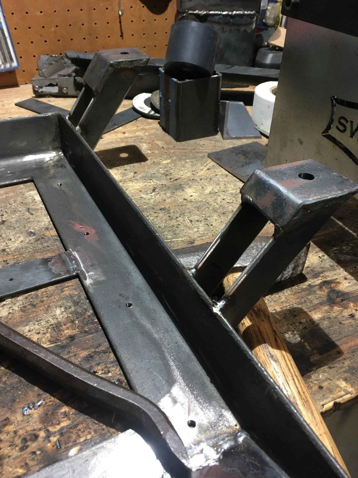

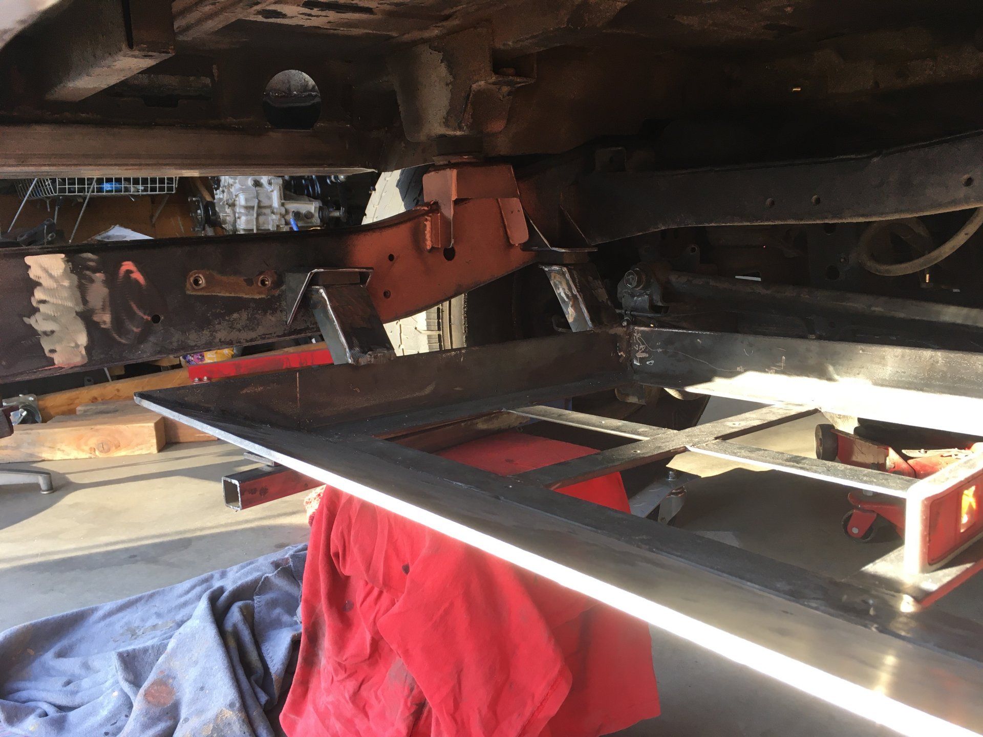

Now is to get to the mounts! I just can’t seem to fugure a way to make tank brackets rest on top of the frame brackets. I figure just bolt the tank up from the bottom. But worry the it will all ne supported by only the bolts.
tomorrow I start on that mystery.

Was worried about stress on the bolts and then breaking
I apologize if I’m a little slow this morning but I’m not getting what you are saying.
The bolts holding my tank in are 3/8” grade 8 (only because that’s what I have here) and from memory each bolt is 9000+ LB load rated clamping and 4000+ sheer. Don’t quote those numbers but you get the idea one 3/8” bolt would hold your fuel tank and never fail under normal circumstances, I’m assuming you’ll have four bolts holding a 300 LB tank to your frame rails and I don’t see a scenario where that fails without major damage to everything surrounding it.
Ya, I am with JMack. I have grade 8s holding my tank too. My Pig is the old style where the tank goes to the body, so the body will probably fail well before the bolts I used will.

Talk about over build, maybe.
Chalk it off to practice for engine mounts. That rubber is from the pads that cushioned the middle of the body. I was worried I was hoarding, but it was the perfect rubber for this.
That’s not going to hold a bird fart. Add more brackets. Belt and suspenders fella 👊😉
