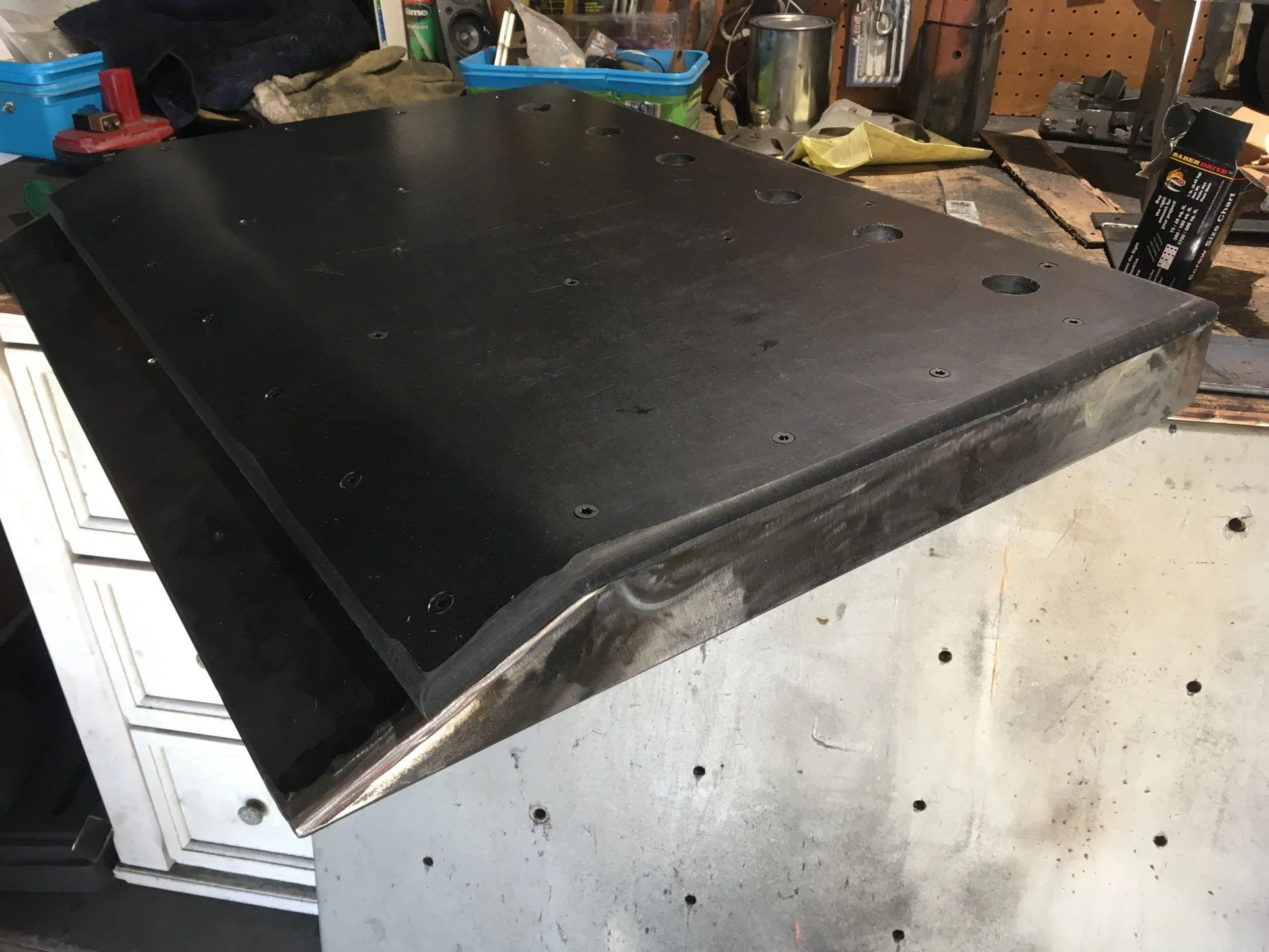

Really inexpensive at my local Plastic Supply and easy to work with using normal wood working tools
I used UHMW and glued it to the tank. I know that’s not hardcore enough for this group but it’s holding 2 years later.

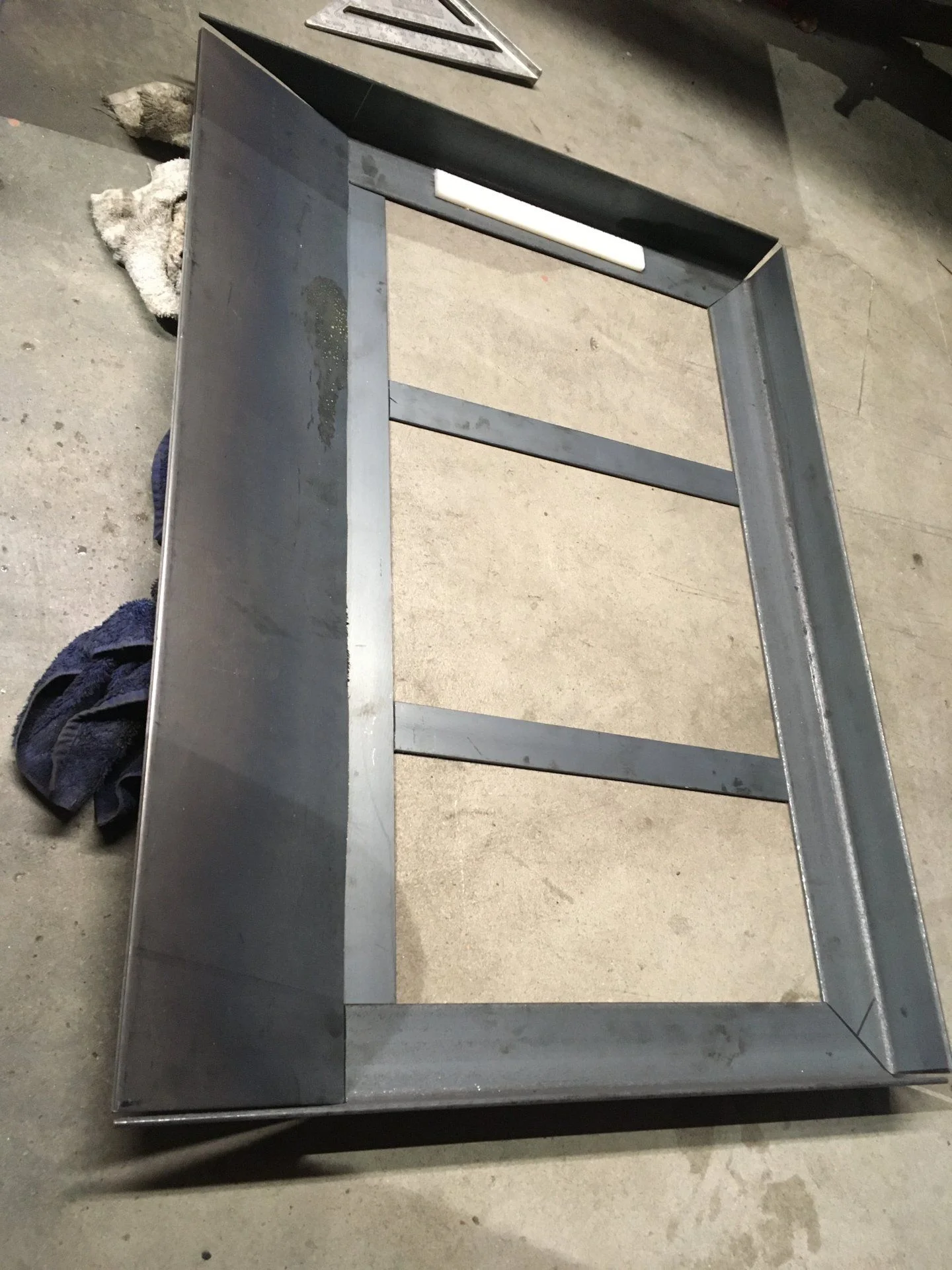

So I am thinking drill a bunch of holes on the floor of this thing, weld a bunch of nuts over those holes, and use that white stuff to create a pad on which the tank will sit, rather than on the nuts which are to attach the UHMW skid plate. Im thinking stuff a thin strip of the white stuff along the sides as well.
Weld it all together and then figure out the brackets to attach to the frame
What you all think?
I am thinking this is what Jmack was describing.
How much clearance should I leave on top. From what I’ve been seeing the iN tank pump is the way to go.
It would be nice to get this fitted and done rather than waiting tilI go and buy/install the tank pump.
