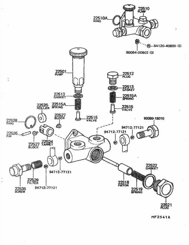

Fixing a failed primer pump involves replacing the primer pump cylinder(part #22501), the copper washer gasket (#22513) and the valve (22515). The Bosch kit does not come with the spring (22515A), so you have to reuse the one on the pump, which is fine. I did not have the proper size wrench to remove the old pump, but seeing as its going to be thrown away, I used vice grips. The threads have been bathed in diesel its whole life so it shouldn't be too hard to remove. Mine wasn't. The Bosch unit requires a 17mm wrench to install. Once that's installed, you must bleed the fuel system.

Primer pump diagram.
attachment.php

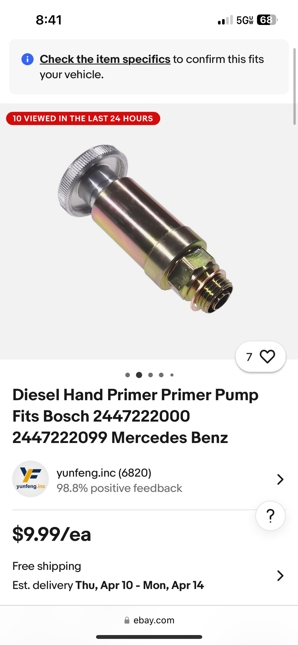

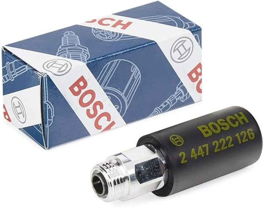

Is this the fuel pump that you used for your hj60 Land Cruiser?
It looks like that cheap chinese unit will work.. but I much prefer the genuine Bosch unit.. any good diesel shop can supply this.. or google this part number: "2 447 222 126"
