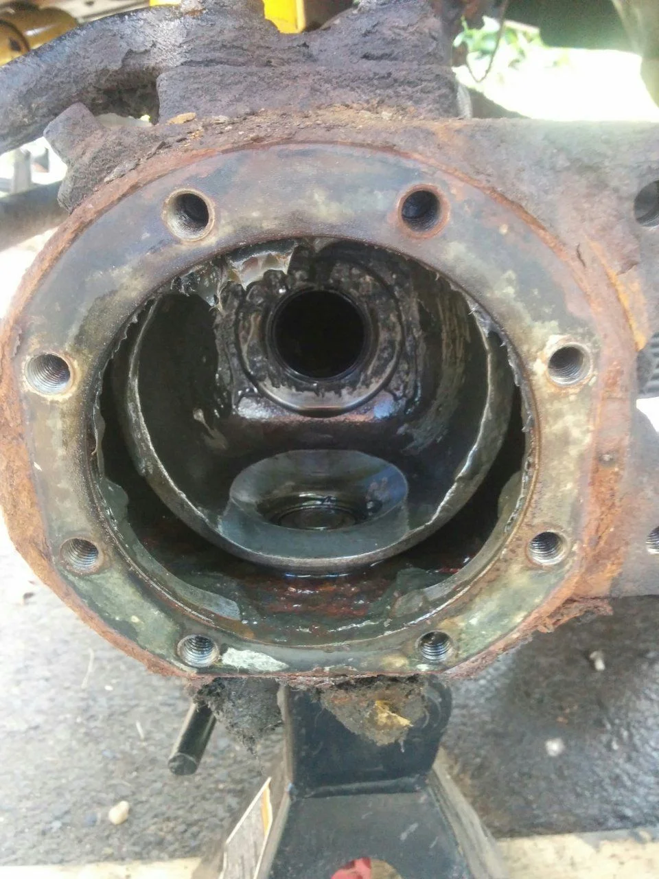

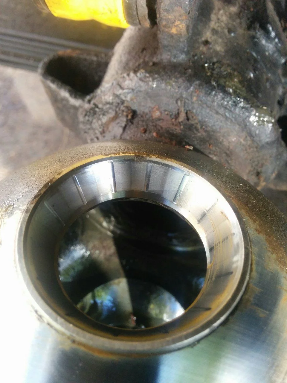

Since everyone else is doing knuckles I figured I'd post pics of the really bad ones I pulled apart today. I've never seen the outer hub seal rusted off of the spindle or the spindle bolts rusted off before. Finally got all of the bolts out and there was nothing in the knuckles. The only lubrication the birfs were getting was oil running down the leak on the inner shaft. To make it even sweeter the upper bearing on one side came out with the arm while the rollers stayed in the knuckle. I'm not even sure how that happens :(
