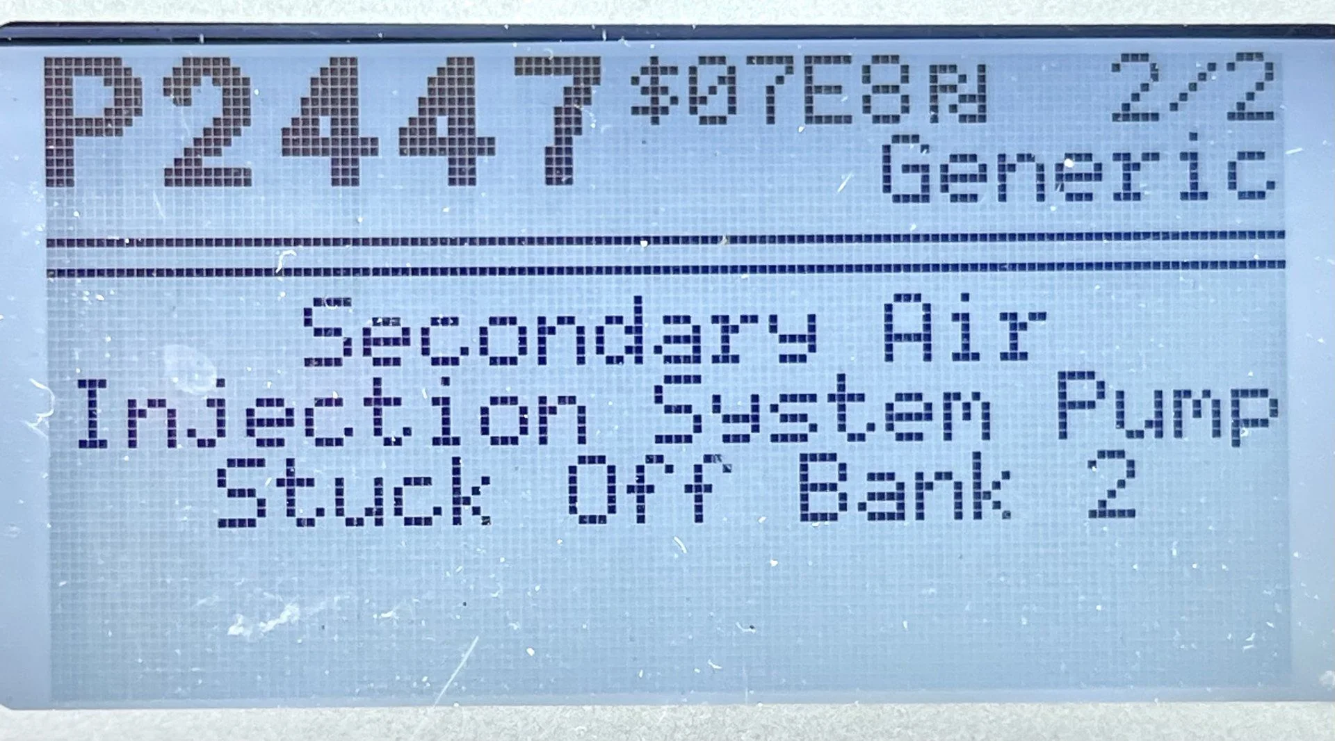

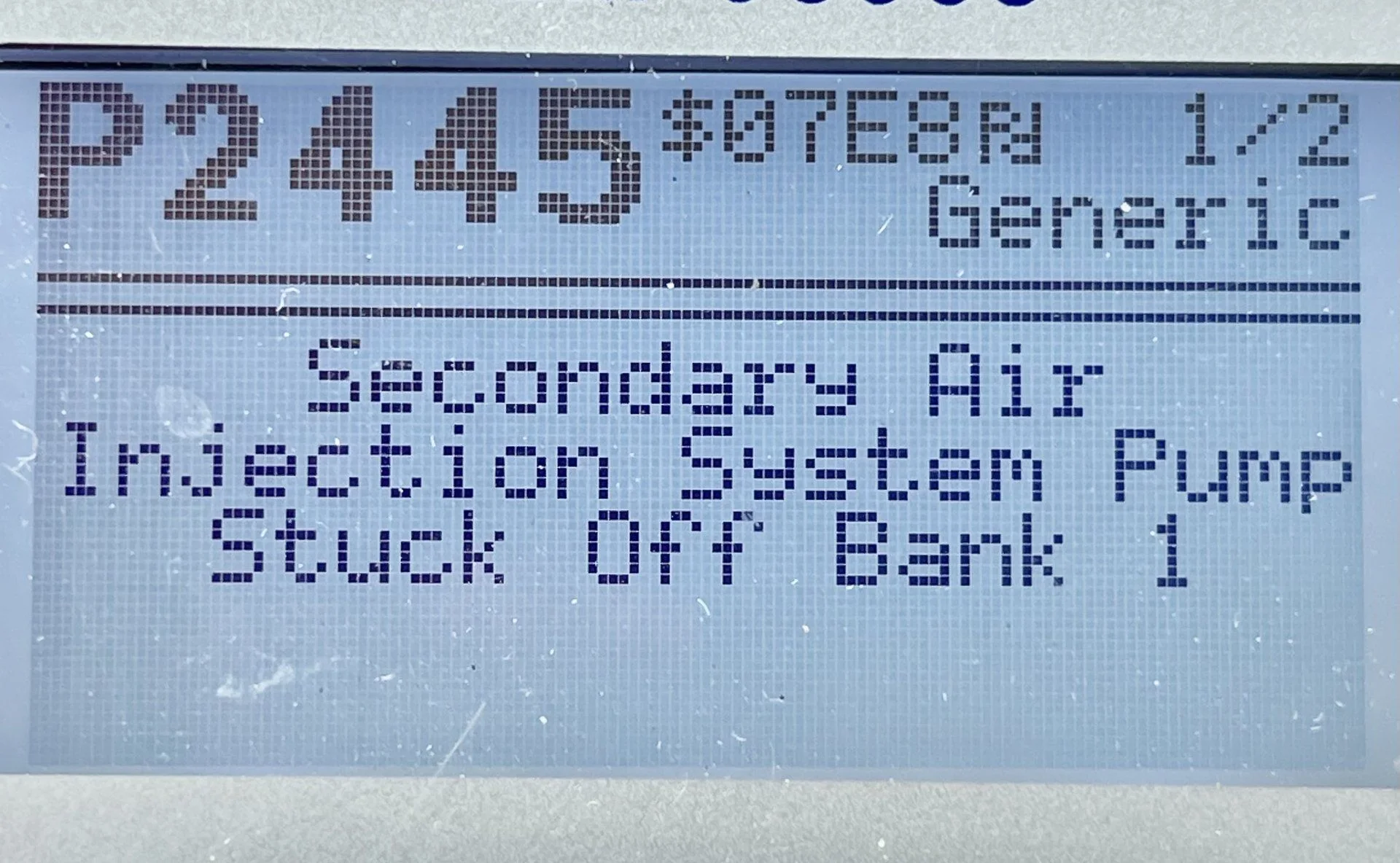

Never seen this one...
Anyone have insight on this?
And like any other thing... 4Lo blinking and center diff blinking.
Truck sat in driveway last 4 days. Just started it up and got these...
Quick update…
drove around a bit… Restarted… Center diff lock flashing still but for low indicator off again. Drove around a bit more… Stopped and started… And now both dash lights have disappeared… And it is no longer generating the codes.
So I am functioning normally again, including the ability to shift in and out of four low.
:meh:!
Still interested in any insight y’all might have…
