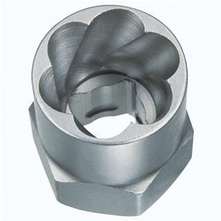

This just happened to me a few days ago! Irwin Bolt Grips will save your ass. My wheels had those stupid spline-drive tuner lugs. The lock tool split and I didn't realize it until it was too late and the lug was completely stripped (using impact gun). Tried welding another lug onto it but didn't have enough room since they're recessed. Went to the parts store and picked up a set of the Irwin Bolt Grips. These things grip like a mofo. Lug was out on the first attempt within seconds.
hmm...i've never heard of those Irwin Bolt Grips. they look like a handy item to have around!

They're a life saver! They have a unique reverse thread. You put your gun or ratchet in reverse and the threads bite and cut into the bolt head, backing it out.
