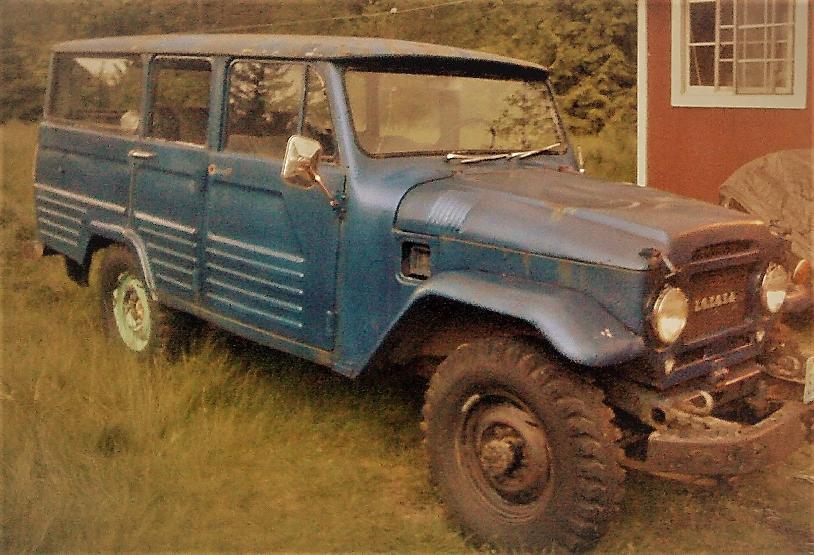

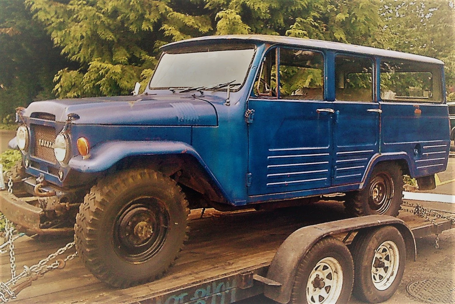

- I acquired my 1966 FJ45LV back in 2012.
- I found it located in Washington State, on Craigslist, and I was connected to it the minute I saw it in person.
- The gentleman who had it up for sale at the time accepted a "more than fair" price for the condition that it was in.
- The vehicle had sat pretty dormant in his yard for many years, but He had decided to put it up for sale because He wanted to see a better future than He was able to provide. Upon my first inspection I would have to say "She" was a little rusty in the floorboards so to speak, but by no means what I would call decrepit. -
This was the day when I first picked it up.
Pretty good starting point actually.

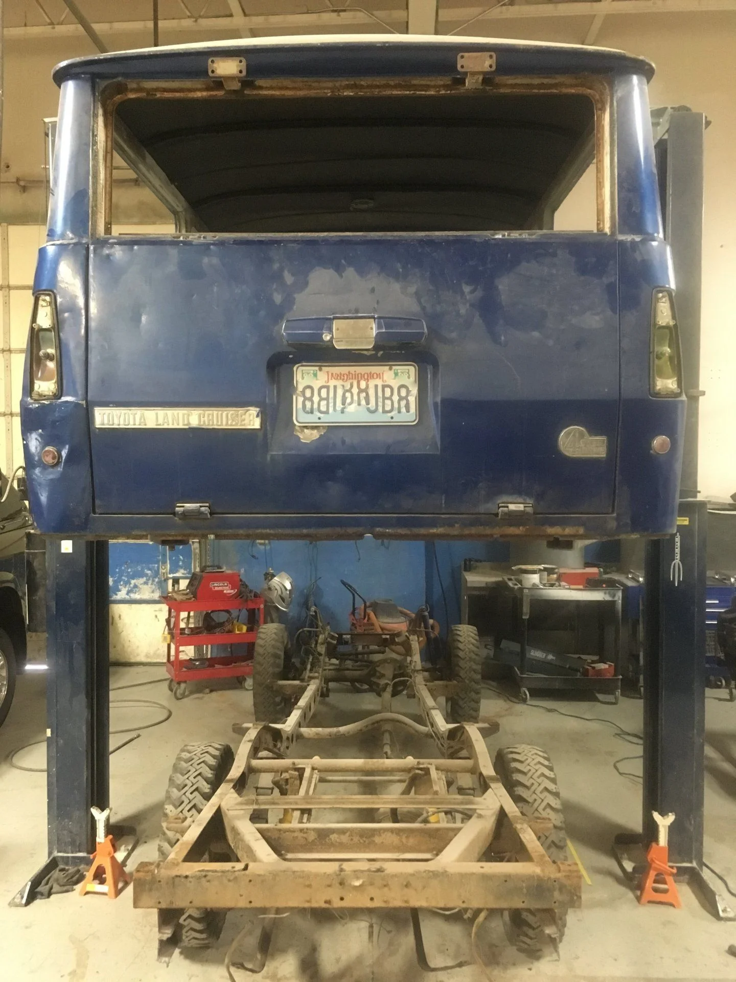

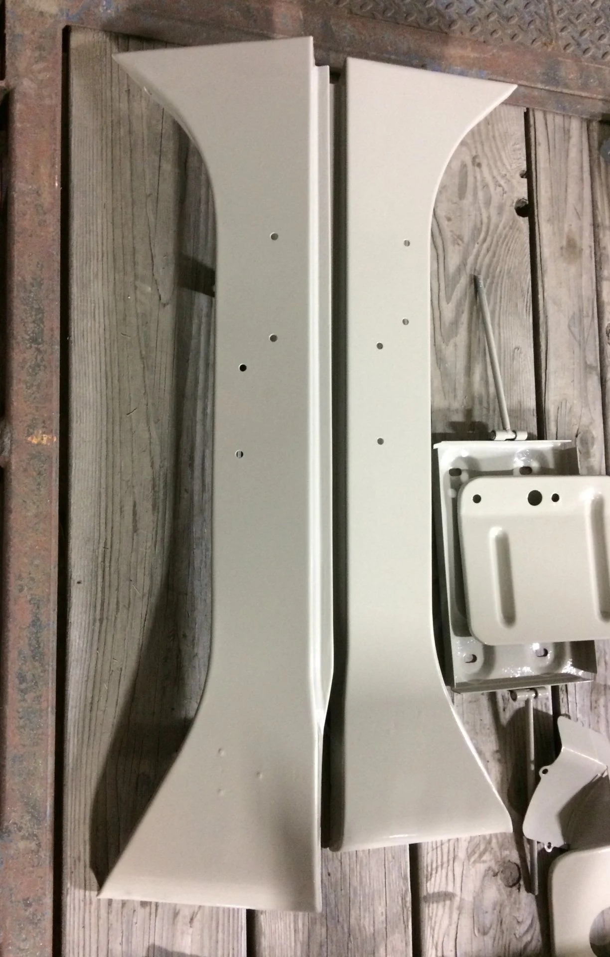

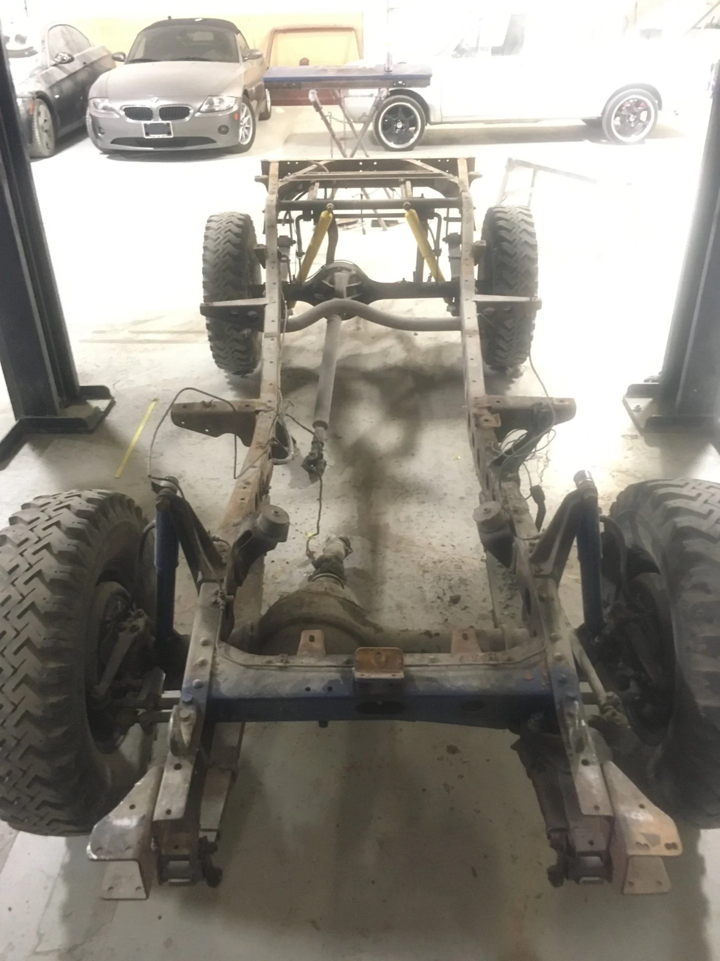

I pulled the motor and sent it to the machine shop - I pulled the body and have sent the frame to the powder coater - my large body panels have been sent out to be sand blasted. The ball is rolling … !!!

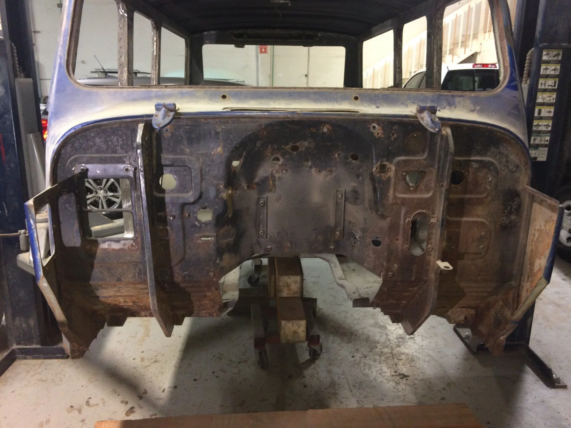

Stripping everything down and sending off to be sand blasted, as well as having the frame powder coated.
This old girl has seen better days, but I'm happy with the lack of rust.

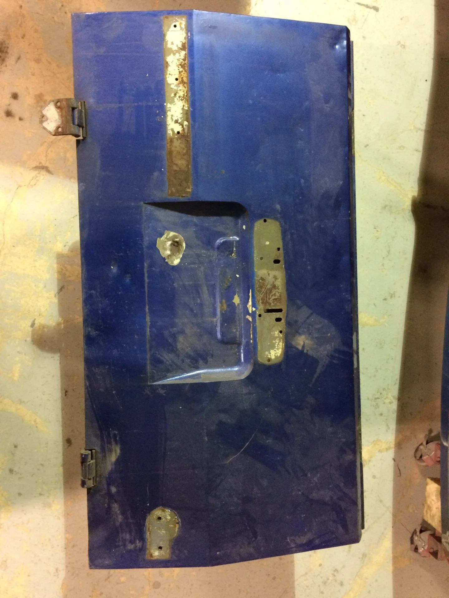

Can't say I have ever seen the hood latches on the front like that? Very interesting.....
That isn't correct for the hood latches, interesting modification. As noted the aprons have been cleaned of the latch.

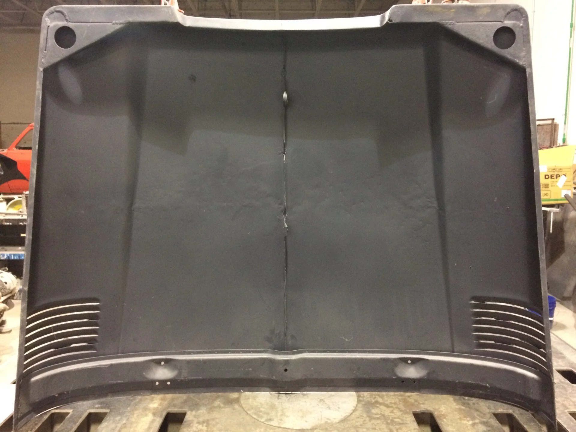

The hood looks to be a later model hood, it should have the split two piece hood with the hood speer.

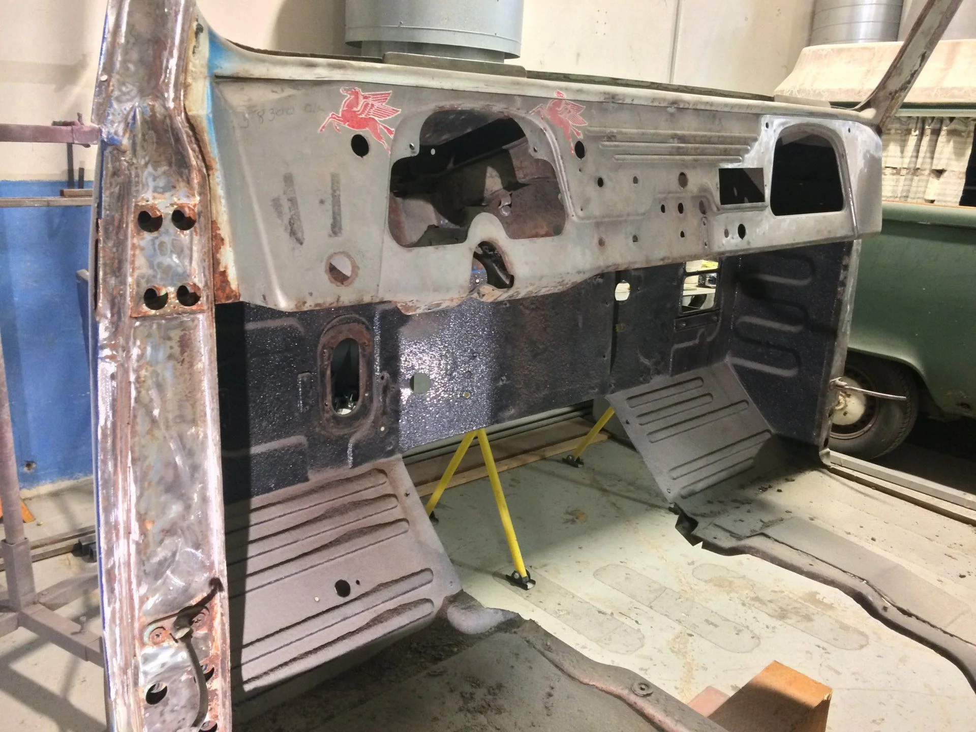

Thanks for looking guys - I appreciate your attention to details! Here are some more that I have now that these parts are back in my hands and I've applied some primer to the freshly exposed sheet metal:
So, there have definitely been some shenanigans in the past but you can still see the spot welds of the original catches. I'll have to round some up and put them back on. ( by the way, Any donors out there?! )

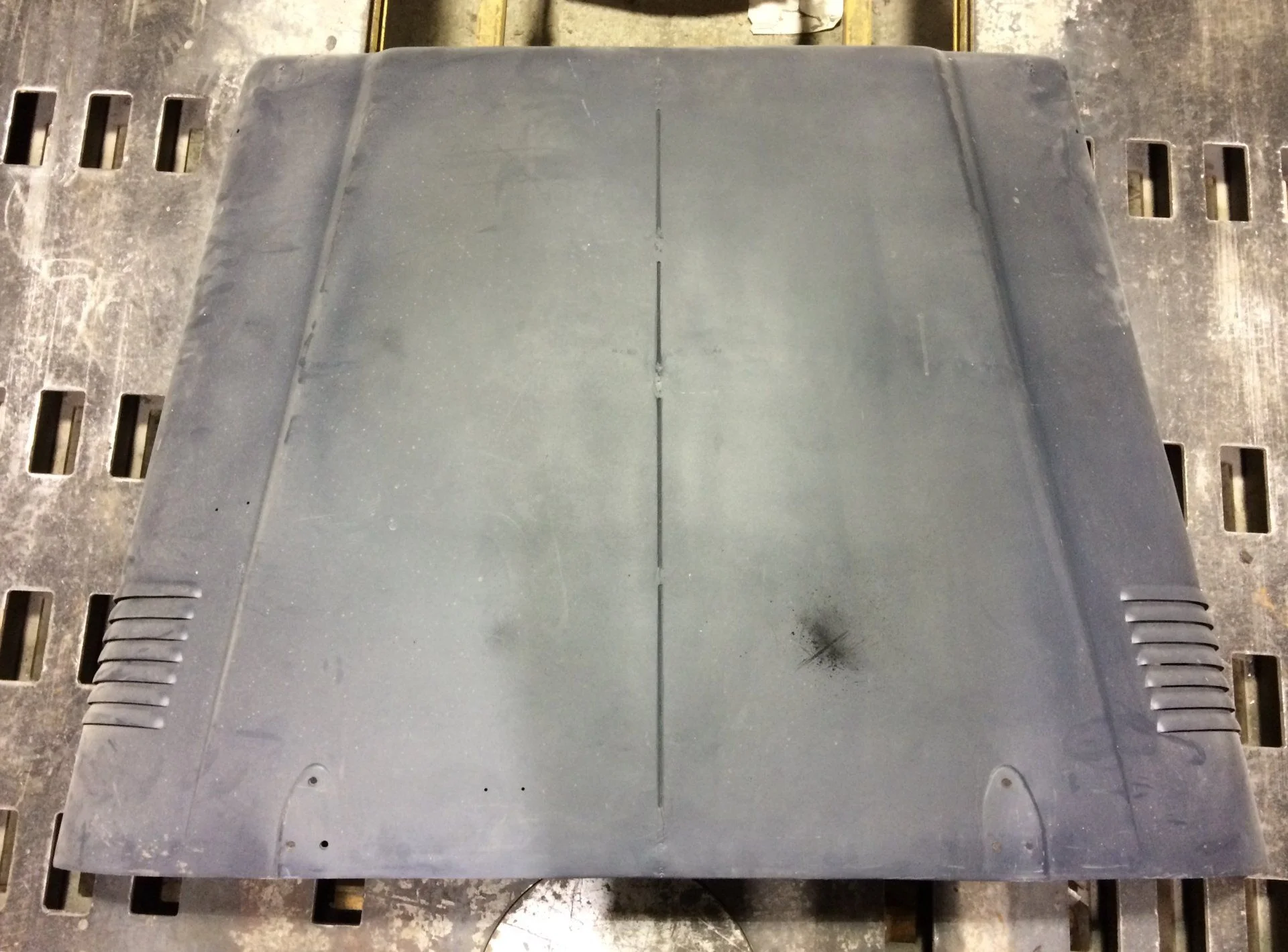

And here's the Hood panel. The previous pic was taken with a 12 pixel flip phone! There's a handful of dings and dents, with a nice crease that had been dollied back out, as well as some extra holes and welding scars but very little rust damage.

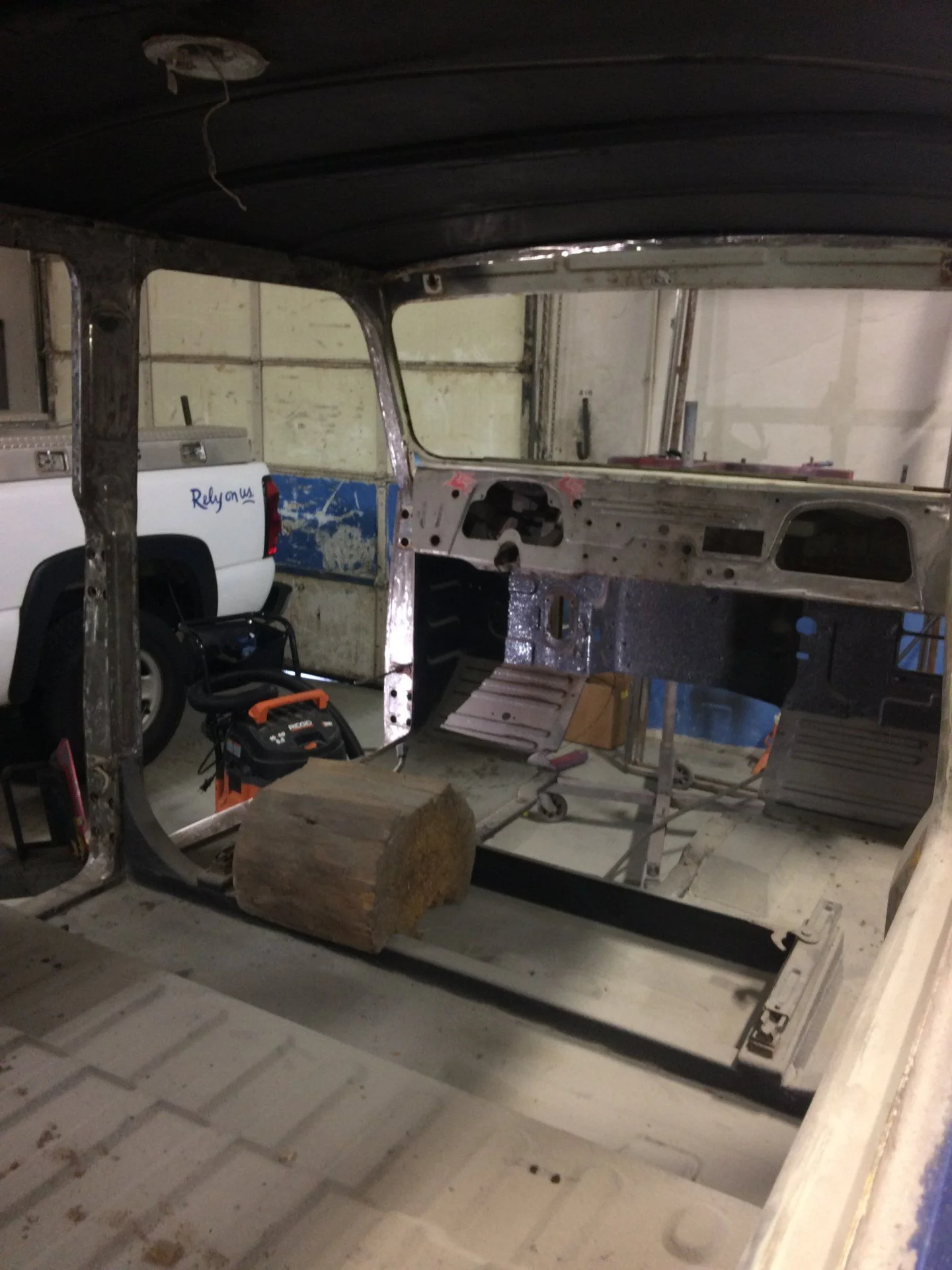

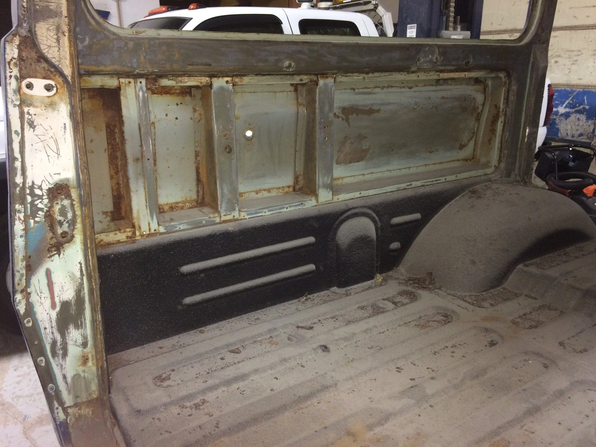

The interior has been recently gutted and I don't have any surviving pics of the interior from when I was driving it but there will me more to come as I progress:

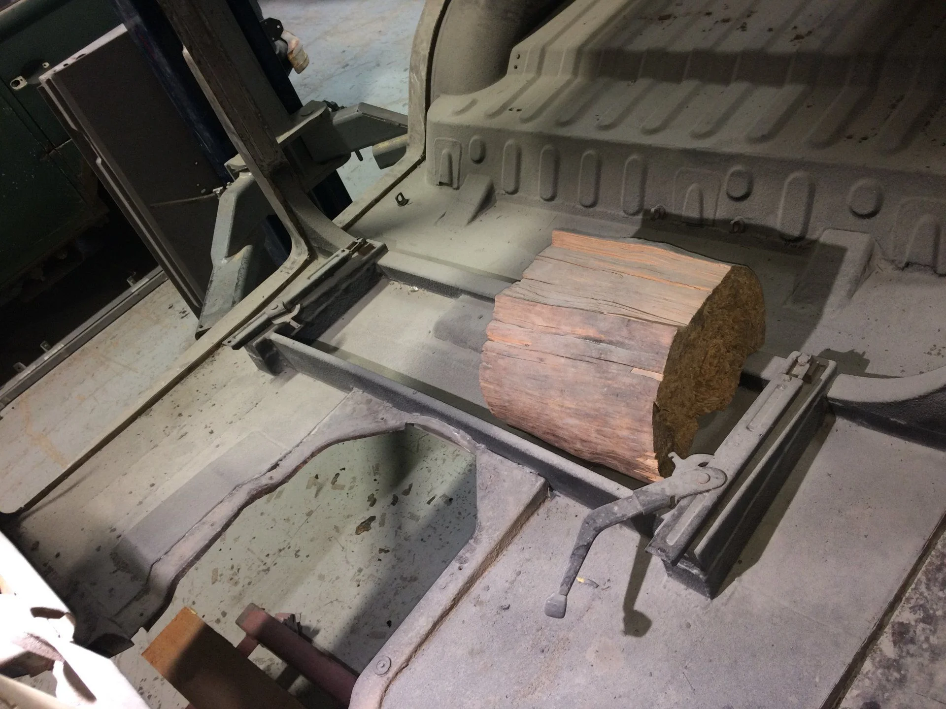

I had previously cut out some rust on the front floor boards and replaced with solid sheet metal so I could drive it. In these pics there is a lot of body shop dust covering the Arma Coat bedliner I had sprayed in to Protect it and help with some sound deadening.
