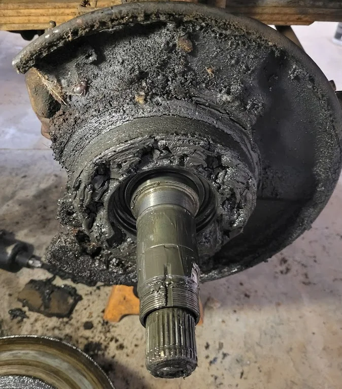

A well-intentioned previous service included a wheel seal installed backwards. Seal lip carrier had been worn off, which led to the lip getting yanked out, and then all the hub grease working its way out. Quite the mess. All sorted now.

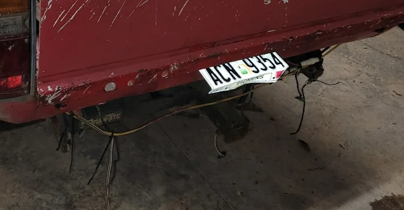

Assorted snips of wiring were hanging:
Unsurprisingly, none of the rear electrics worked. There were a total of three harnesses in some fashion or another under there, and a stretch of yellow extension cord added for who-knows-why. All but the factory wiring (which was totally unmolested somehow) is gone. Plugged the rest of the circuits up and bam, it all came alive. Love it.

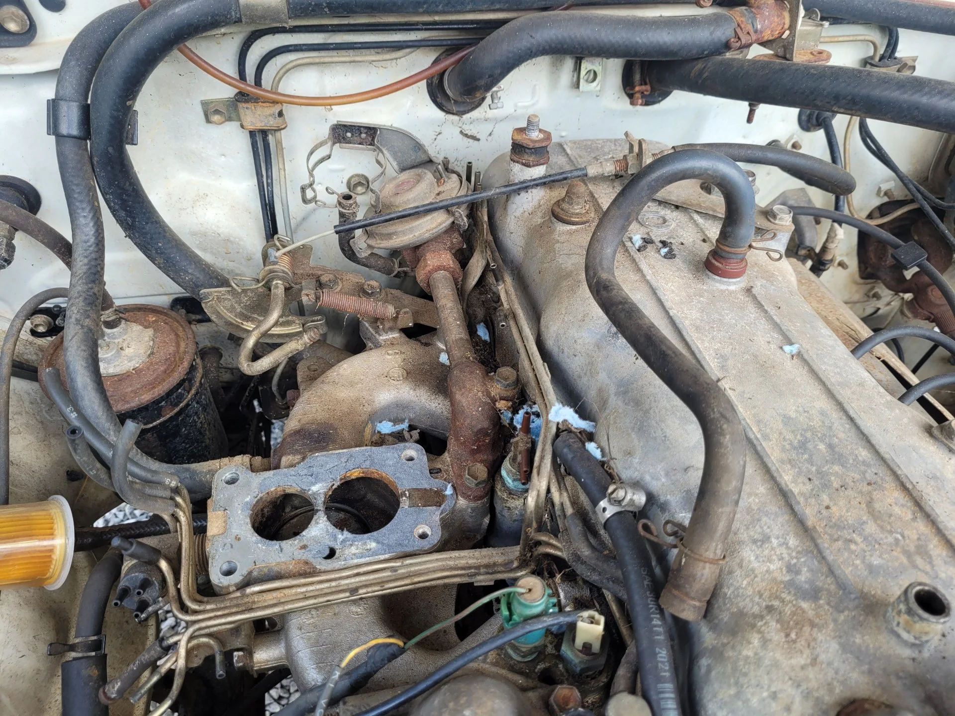

The PO's new ebay carb just would not adjust in to idle. Anything under about 1500rpm and it died. I threw in the towel and yanked it with plans to move to a known good weber I had on the shelf, then cleaned up the engine bay to see what else would need attn. That was at the beginning of summer...I popped the hood yesterday to find this:
Rodents. Dammit. Luckily it looks like this visit was either very recent or short lived. Found one little pile of turds, had a clean intake even sans the destroyed rags, and one de-insulated ground. No damage inside the cab, thankfully.
However, it's got wicked blowby now. As in the oil cap wants to jump off the VC. Gonna douse the cylinders with some ATF and see if I can free up that ring. Otherwise, I'm gonna have to put my thinking cap on for what to do with the project...rebuild or swap...TBD.

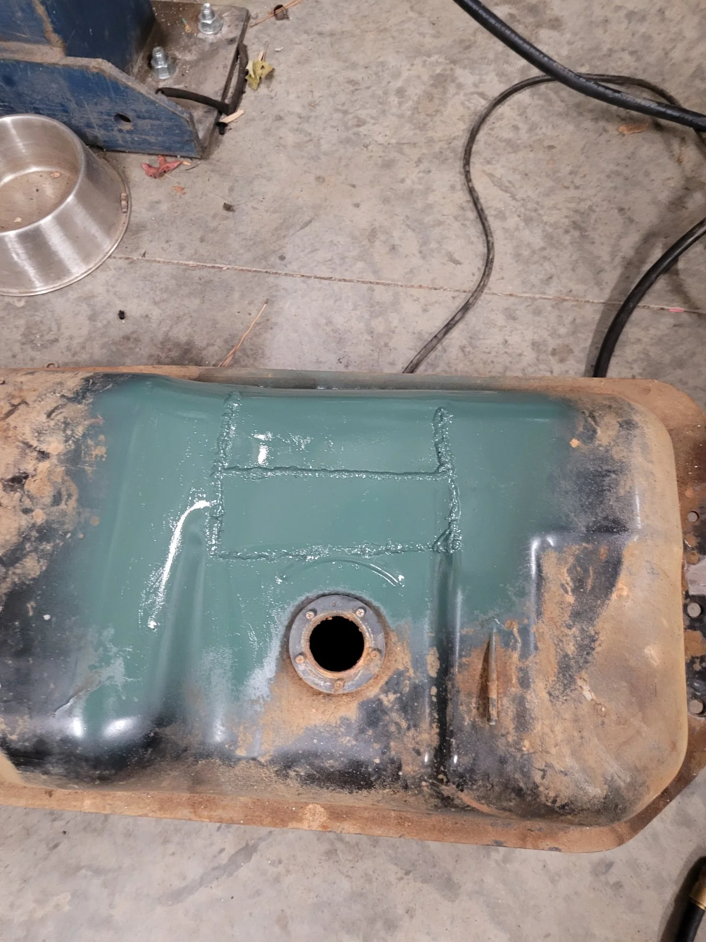

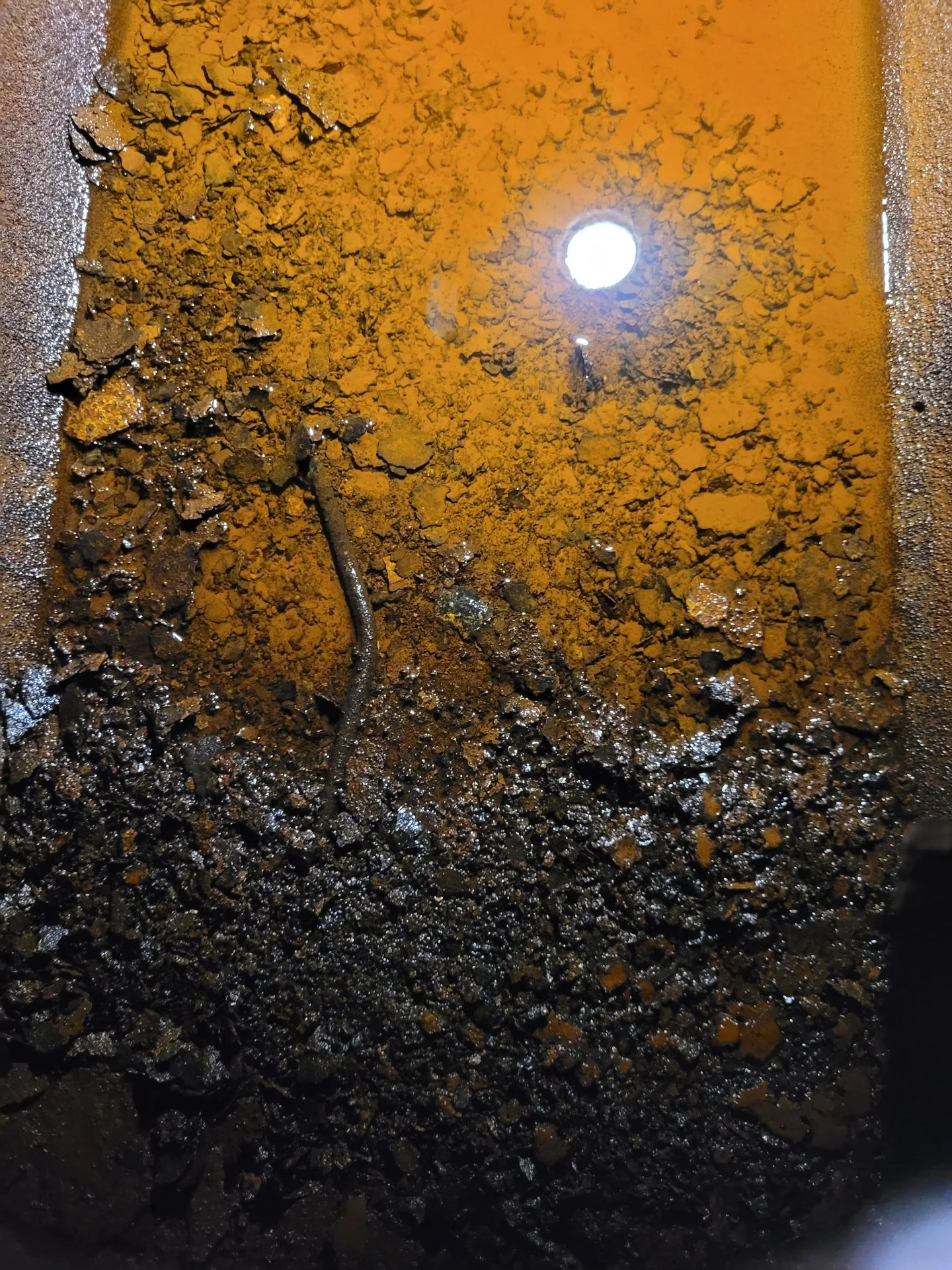

Time to get the thing running on it's own tank. Got it dropped last night and found this:
The smell...so terrible. Drained a full tank of varnish from it.
Filled it with water and cut a nice, big access panel in the top and set to scraping. It cleaned up fine. Next step is shake rocks in it to take care of the remnant varnish dust then weld it back up.
Sender and pick up tube cleaned up to new, and 60 series fuel pickups use the same tank sock - I had one of these laying around.
Should be sorted tonight.

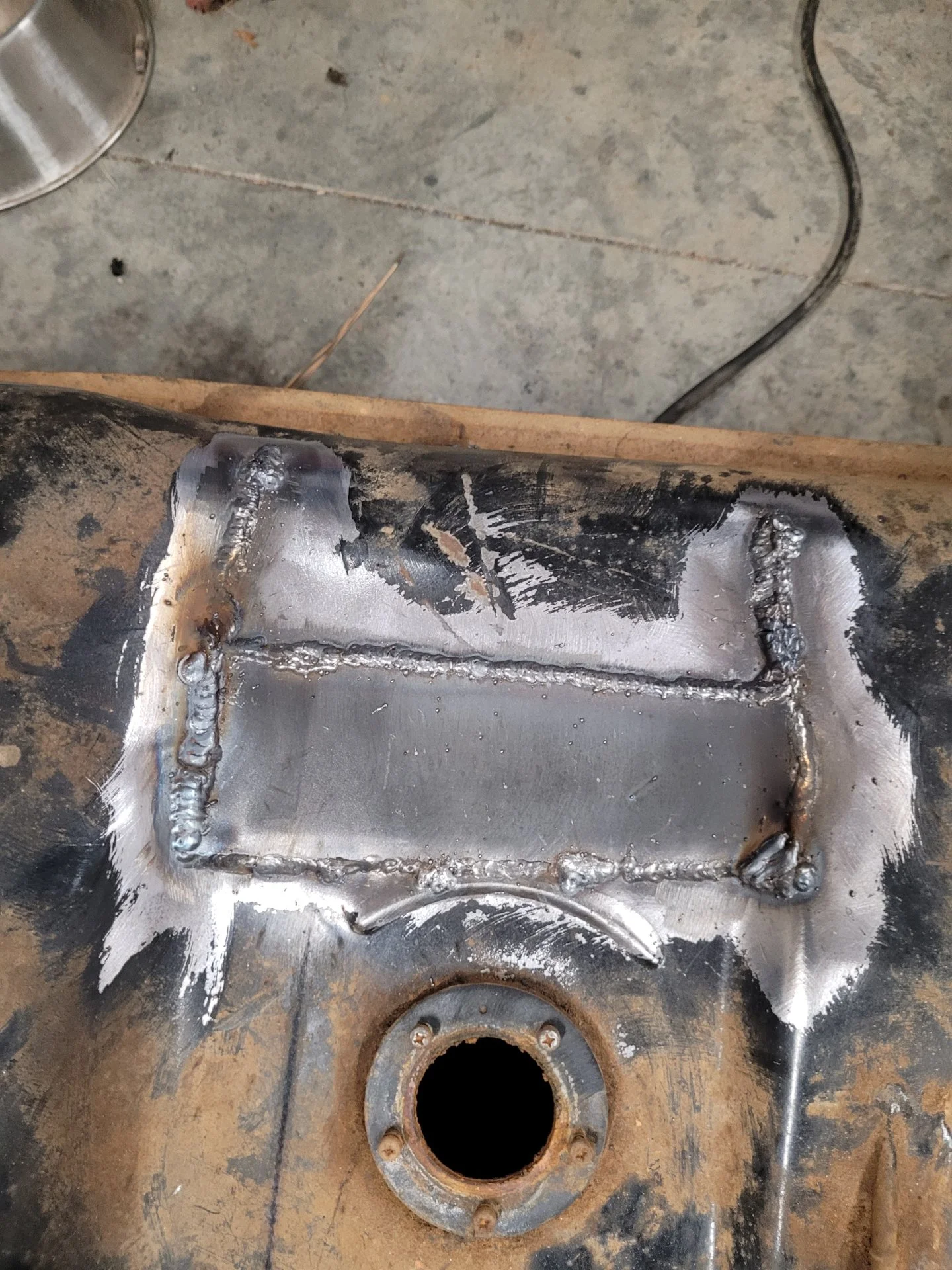

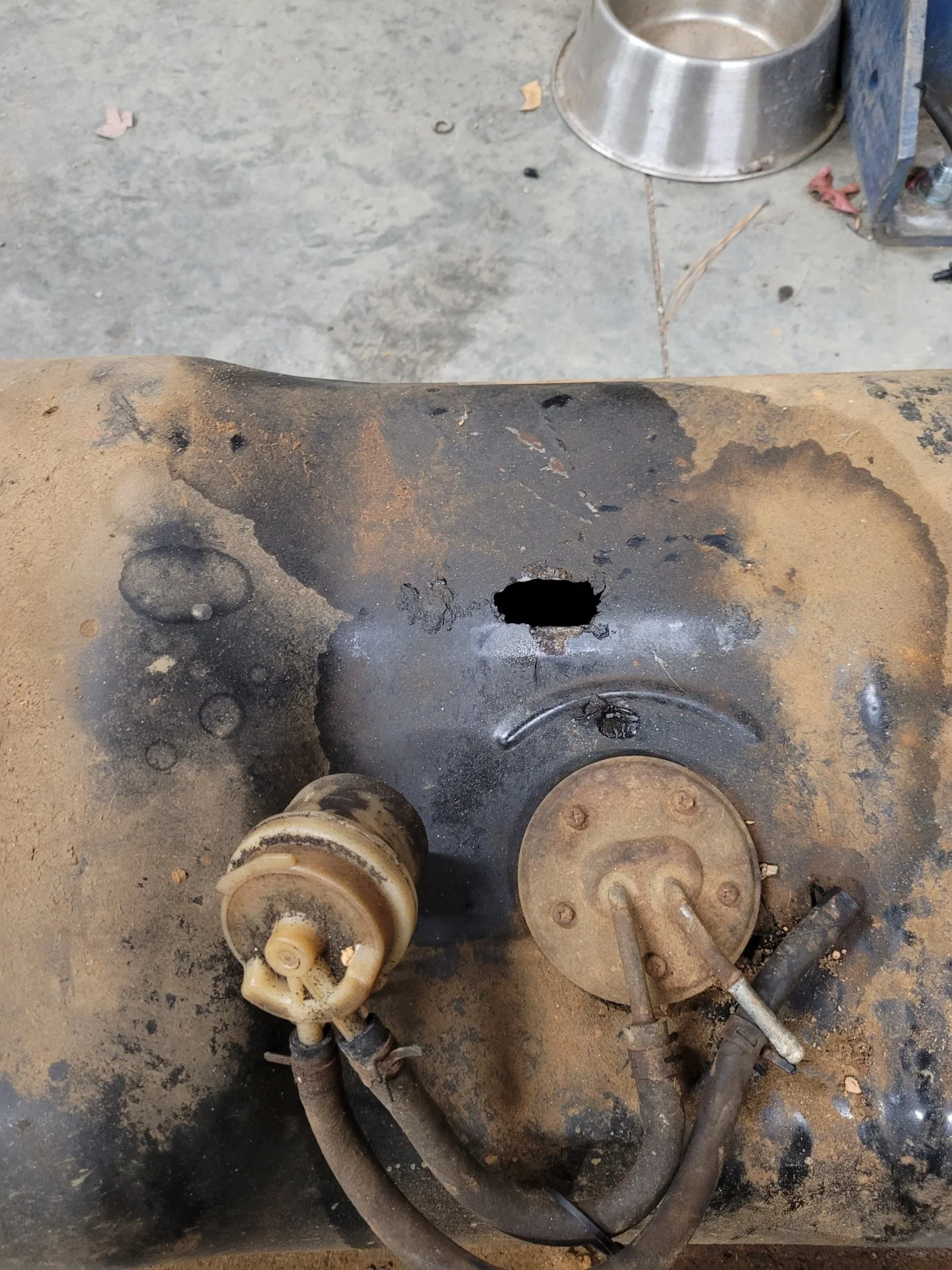

I'd love to know the metallurgy of this old tank steel...it popped and spat and hated every minute of welding. And that was properly prepped and cleaned. A little heat got in it, sweetspot machine setting was found, and she became a tank again:
Patch and parent measured similar thicknesses, but holy crap...the parent material begged to blow through. Hopefully those welds aren't seen for a while.
Corrected a few more pieces of plumbing and he's on his intended fuel supply again.

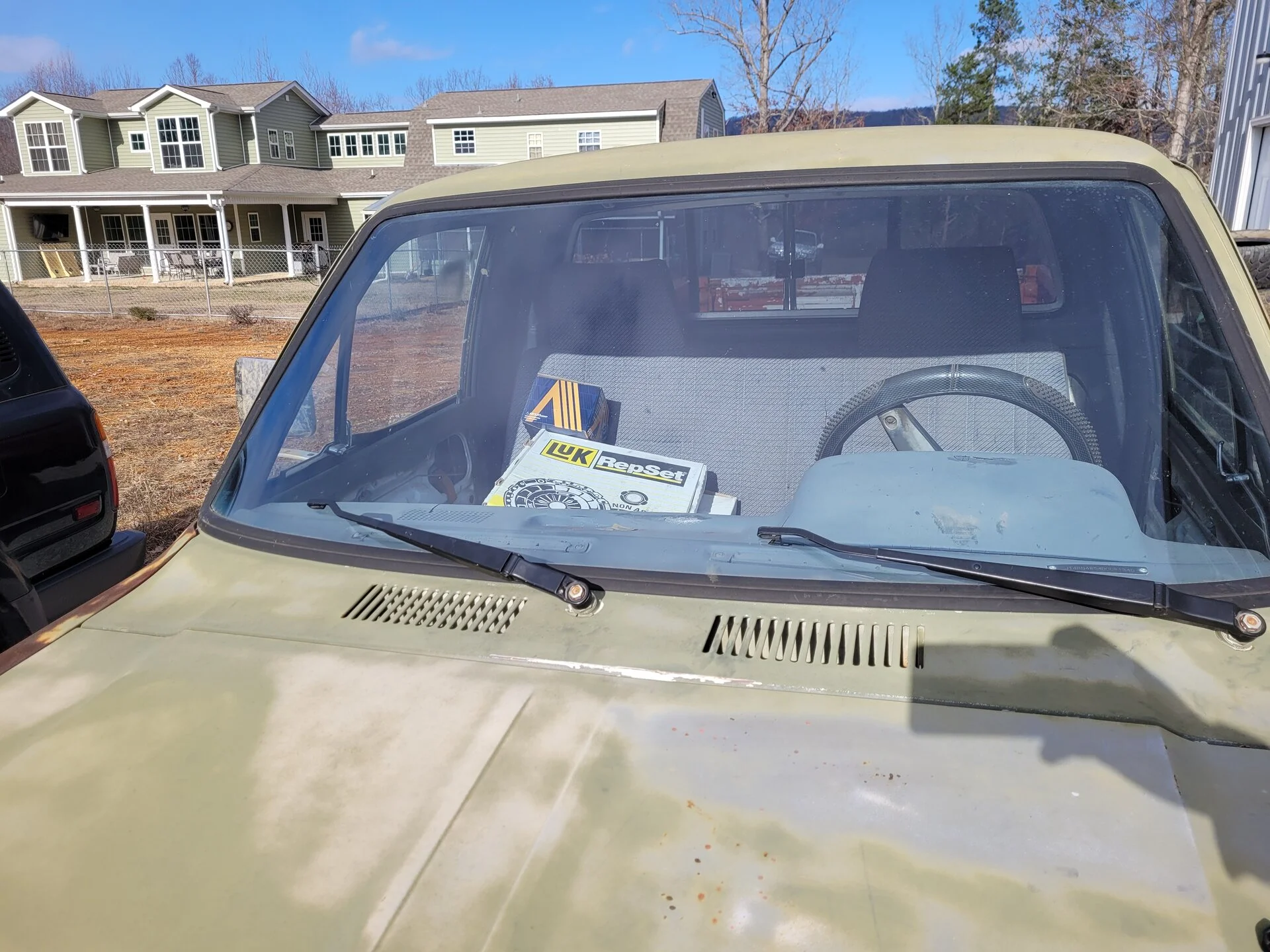

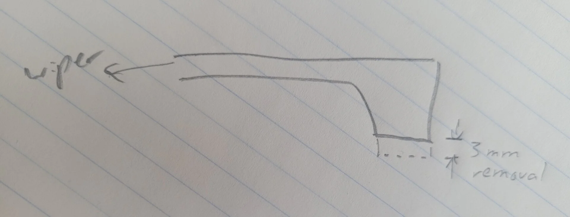

Finally got around to getting the wiper arms sorted. Snagged a set from a 3rd gen 4runner. You have to grind 3mm off the height of the stud pocket, but then they're good to go. Popped 2x 13" wipers on em after this photo. Junior is in business.
Can you explain the mod to the wiper arms in a little more detail?
Shorten the pocket height a little like shown below. Otherwise, the pocket crashes into the link pivot stud before the arm snugs onto the stud.
