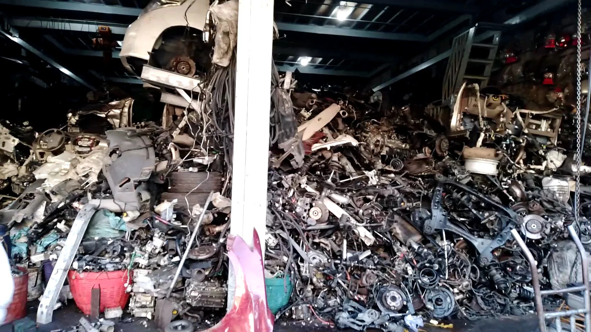

My idea was extra ground clearance under the pumpkin. I have all kinds of time. And huge parts supply.

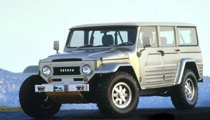

Thanks for the input. The main reason for needing a suitable doner frame is to have more modern drivetrain and not having a 40 or 45 to start with all the body will be new after market. I just not liking the look of overly wide axle look of the 80 to 40 swaps.
In stock form 4runner seem to do ok and with slight upgrades lift, lockers, taller tires would go any where a origanal 40 would go.
My next crazy idea is a 40 or 45 to 80 or even newer swap but widen the 40 body to the 80 or newer width. Maybe leaving the 80 or 100 firewall and floor pan. Similarly to the 70's chevy truck to late model morphs.
Any way it's just time and money. I got some of each.
