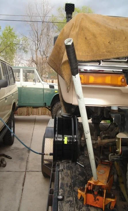

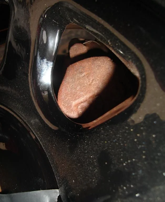

yep, they did. jeremy huskey was the guy who got them for us. iirc, it was 3.25. i really didn't want rims that stuck out that much and normally 3.5 would be fine, but they now have a "reinforcing" lip on the spokes that sticks out and hits the caliper (you can kind of see it in this pic). i tried the 15 with 3.5 and it rubbed. also tried a 15 w/ 3.50 alum, but it would've meant changing out all the studs and trying to source longer studs
great thanks, that was what i needed to know.. It's not that i think they looked bad it just not the look i am going for..Did they rub bad or just a little becouse I know alot of guys grind there calipers and run'em anyway.
