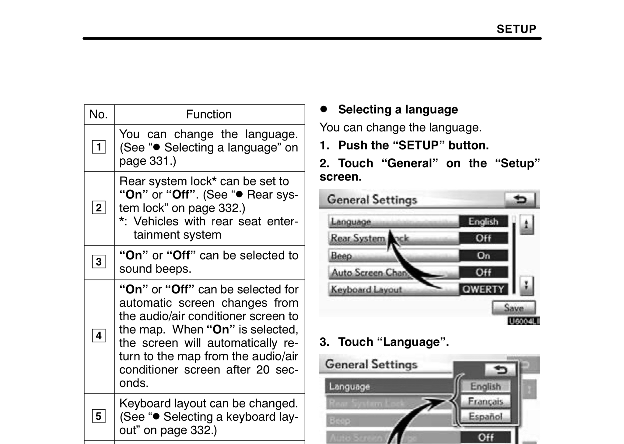

Not sure if anyone knows a fix for this. I haven’t had any luck searching, and I’ve been through all the settings I can think of. The factory radio/nav will not stay on whatever screen I select (such as FM or Bluetooth) and will flip back to the Nav screen after about 20 or 30 seconds.

I *think* there's a setting buried deep within the settings that you can toggle for keeping the screen on what you select so that it doesn't revert back to whatever it wants to show you. Hopefully someone else can verify before I get a chance to check it on my GX (though mine is a 2018 so not sure if the earlier models were programmed differently).
Have you tried turning Off “Auto Screen Change” in “General Settings” under “Setup”?
