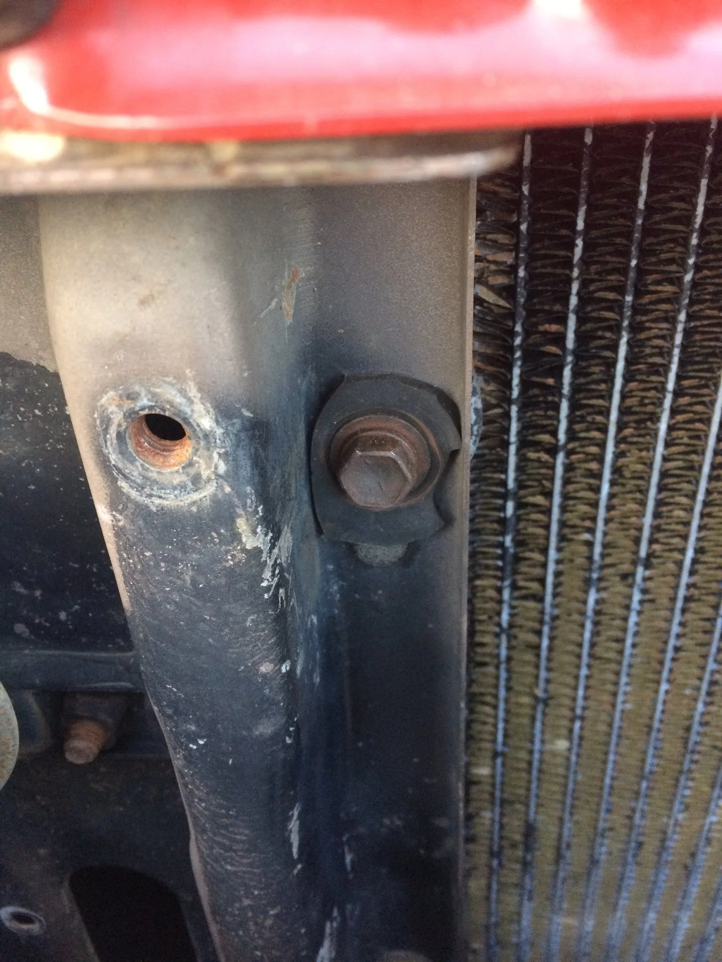

Working on pulling my radiator today since the new one should be here soon, and I noticed that the rubber isolators on the top bolts are dried and cracked as hell. I could find the ones for the lower, vertical bolts on Partsouq but no reference to figure out if the uppers are the same as the ones on the bottom bolts. Can anyone verify if the uppers are the same as the lowers? If yes that'll simplify my search, unfortunately they don't seem to be available anymore, so I'm still looking for any source that might have them.
Mine weee missing altogether I think, or half of them so I used a neoprene washer from Ace and cut it down to size to fit. I can get you a photo but not till tmrw, leaving work in the dark and it’s cold as heck.
Yeah I'm curious to see how you did yours.
So the rear section of the rubber is good but the front was missing. That’s where I cut a thick neoprene washer from Ace to act as the front side. If I remember correctly the rubber is simply a smaller version of the lower horizontal insulator. So getting that rubber sleeve that the bolt shaft runs through would take some ingenuity. Maybe Onur can source them... or Georg could grab some decent used ones.
FWIW, radiator insulators on my rig were decent when first pulled @ 2yrs ago. I coated them with plumbers silicon grease and they still look good. I added lil more with the recent radiator swap.
Nice Fix NeverGiveUpYota.
Thanks! I’m thinking @Spook50 if Ace has rectangular sheets of thinner neoprene (I know they do of the washers) you could cut and potentially make a tube buy gluing the ends w/ plastidip. But maybe there’s a thin rubber hose that could work. Honestly the material wouldn’t even need to be glued together, just stuffing it in and having a big enough space to slide the shaft through would suffice.
