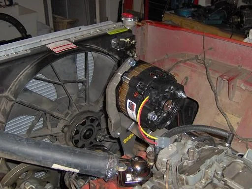

i run a ford taurus fan with my TPI set up, check out this link https://forum.ih8mud.com/40-55-series-tech/50141-electric-fan-faq-links.html others just dont care for electric fans period. and 210 isnt really that bad for that engine and emissions are better in that range. if it got to 220 or above i would be worried.

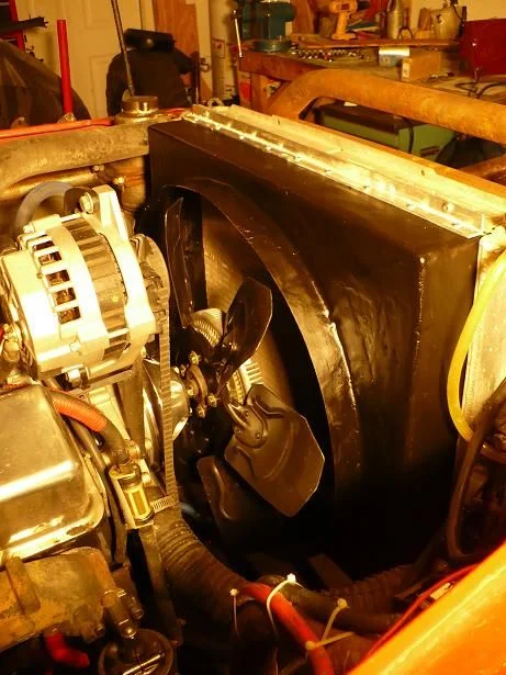

What lone gunman said. I think it is a 18-19" 7 blade fan on a heavy duty clutch. I had the lincoln MK VIII electric and it would move a lot of air and would pull the temp down very quickly when turned on, I had trouble with underhood temps being too high even though the engine was 190 deg. This coupled with the large electrical load it placed on the system caused me to switch to the mechanical version. Now it moves a ton of air and no electrical load. As a side effect it also keeps the floor and tranny tunnel cooler. It is on a 19X26 generic aluminum radiator, now the temp stays below the thermostat. ( I had drilled a couple holes in it in a prior life)
