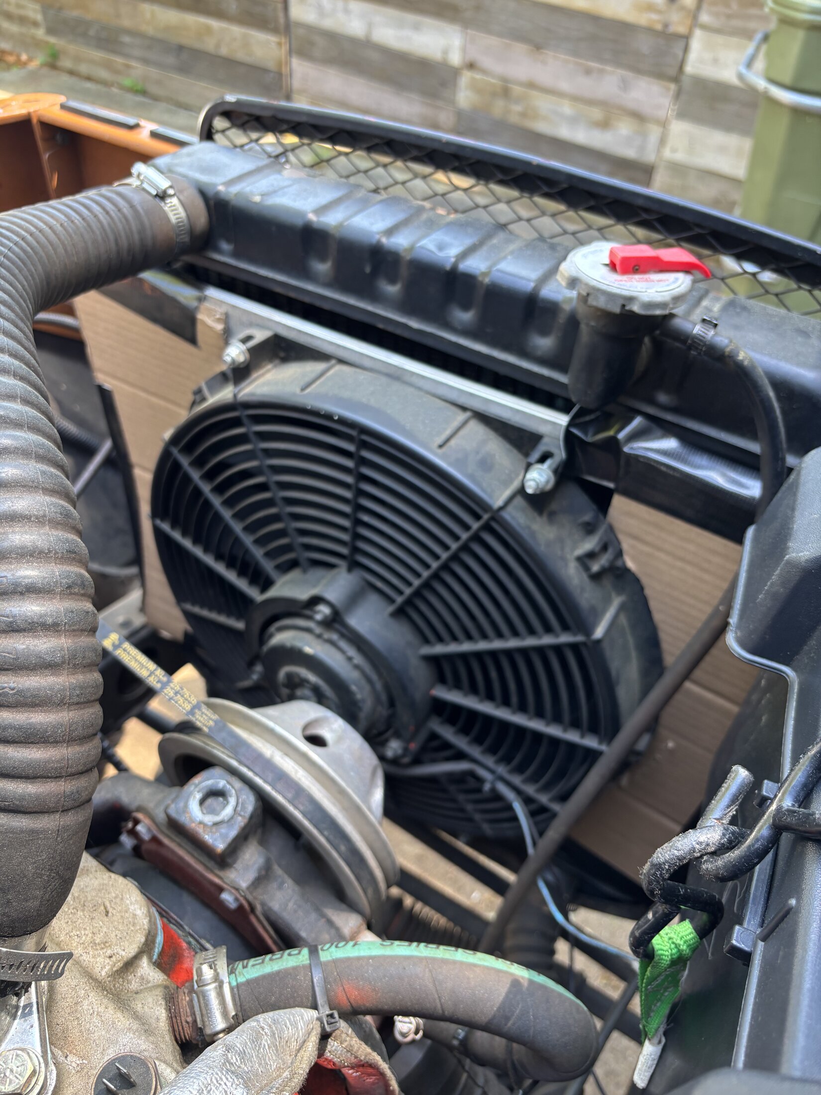

I made a fan shroud and properly positioned the straight steel fan 1/2 way into the shroud as is should be. I ran fenderwell headers for decades b4 going to ramshorns manifolds. At the beginning I had cooling problems with a high hp 350, then adapted a shroud which helped a lot. Now the engine is more stk and runs cool.

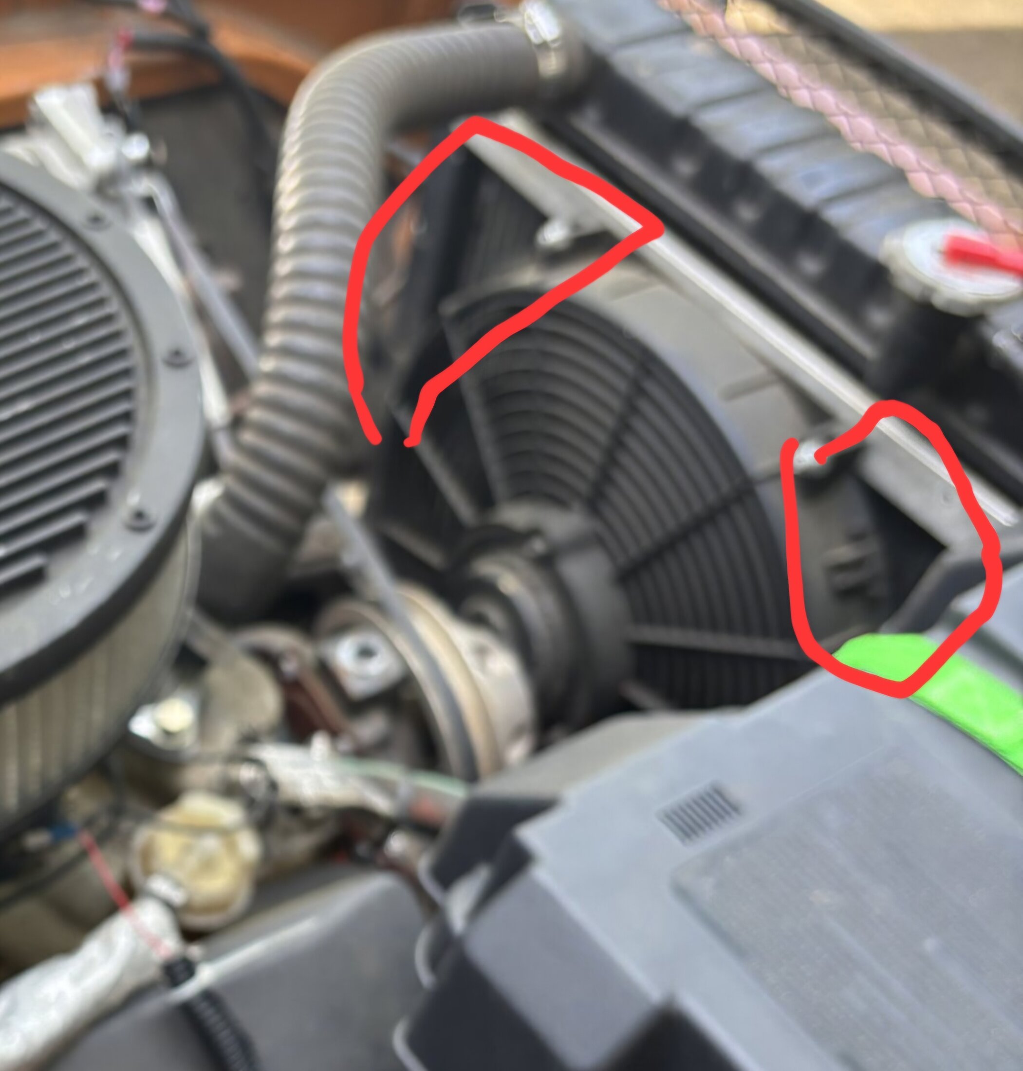

You might try adding aluminum or metal sheet metal to the open corners so the electric fan can pull air from those areas/corners, like @peesalot mentioned. The metal needs to be spaced away from radiators core, so the fan can pull air. At 1st you could cut and tape cardboard there and see if it helps. Does it have a heater, is there a reason it's not hooked up? I not 100% convinced the heat is effecting the clutch, the headers are above the slave. Below is also the fsm instructions on clutch adjustment. Pedal height, pedal play, rod adjustment. Pedal play is when the slave rod start to move and slight Pedal travel.
View attachment 3886645View attachment 3886656
Thanks for this its very helpful. The diagram and your description helped me understand about those open corners. I will try the cardboard option just to see how much difference it makes, and see about adjusting the clutch. That would be awesome if an adjustment could correct that.

The shroud was a genius idea...it kept the temp 10-20 degrees cooler! Never once got over 170. Obviously need to make a more permanent setup, but this showed how much of a difference it will make!

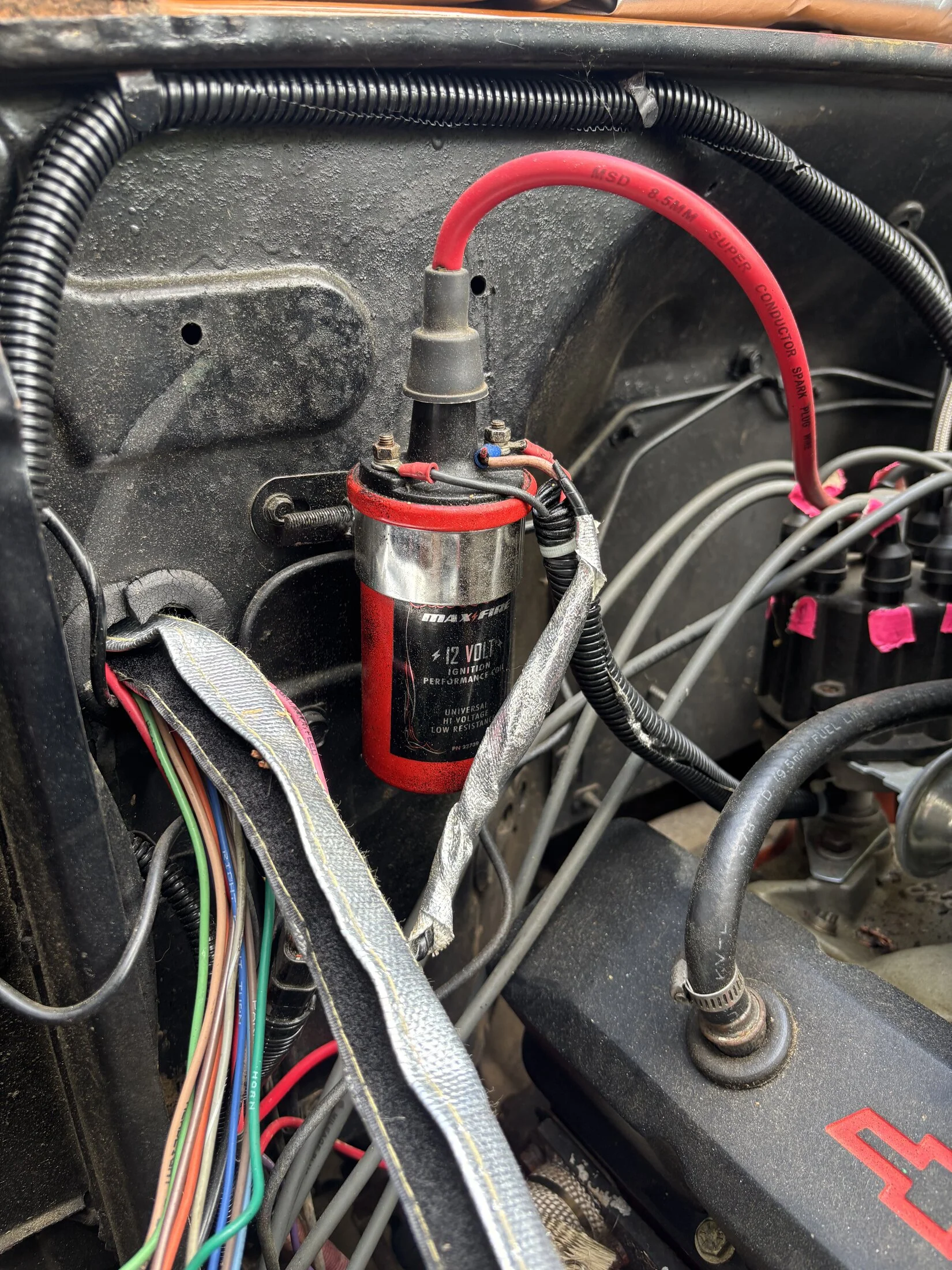

What kind of ignition system do you have? HEI's are notorious for heat sink issues with the module. There is also the issue of the intake manifold on that motor. That looks like a single plane intake. They aren't the best for drivability at low rpm and starting ease. If you have points and an external coil, you need to make sure all of that is up to speed or it will be a hard starter as well.
Attached is a pic of the coil.
