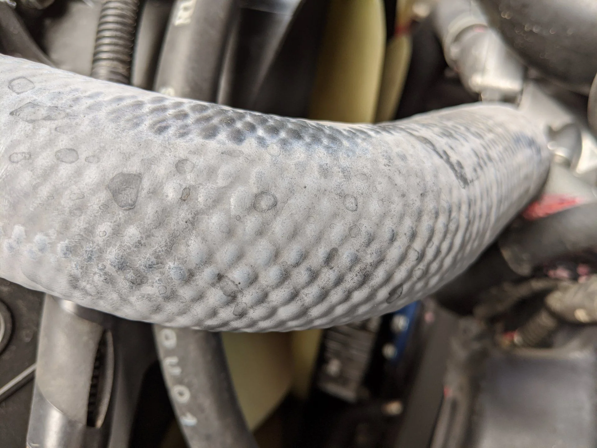

On a side note, apparently my upper radiator hose was replaced recently by the dealer...but should it look like this? The red leaking coolant appears to be old as well, since it's dry and crusty and I haven't noticed any signs of new leaking coolant.
View attachment 2352464View attachment 2352465
I don't have your answer on the kit, but I did go out and check and my OEM replacement hoses do not look like that. They are smooth.
Thanks. I'll be replacing the radiator hoses as I just don't think that looks like a healthy hose.
