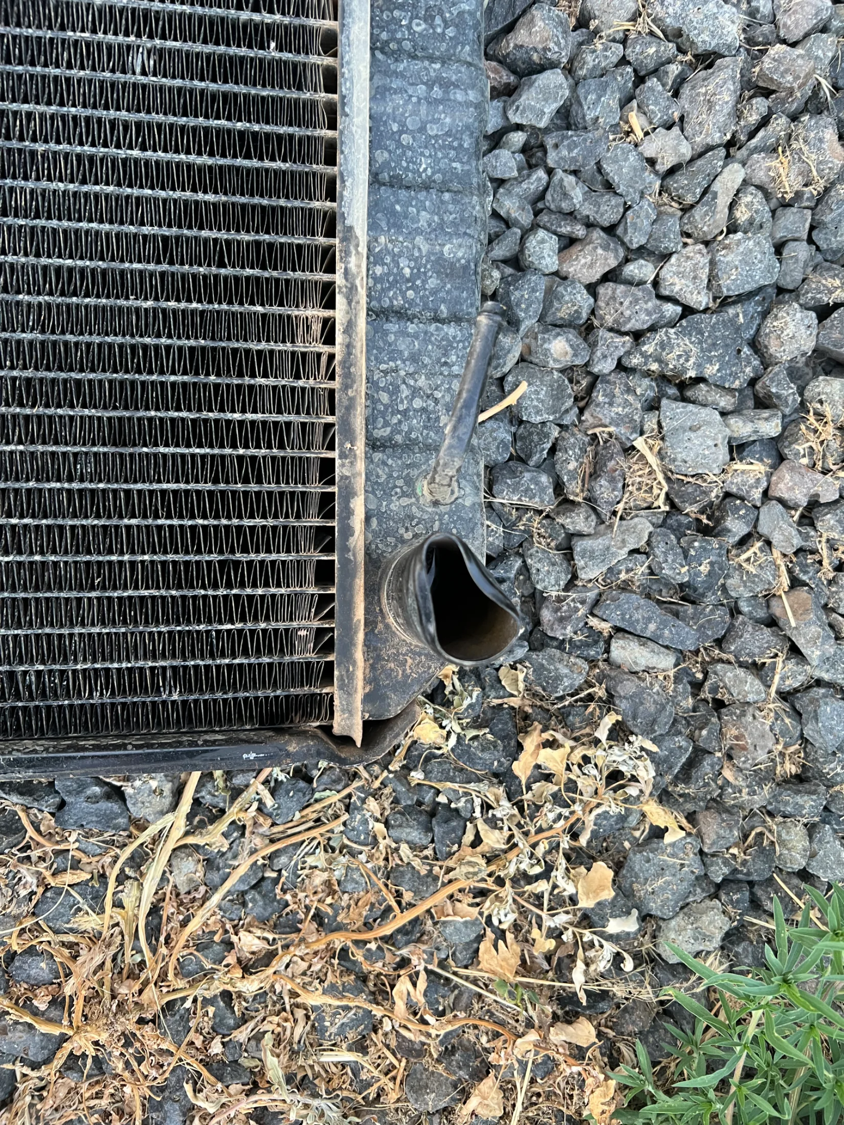

Don’t get the CSF. I know toast had an issue with one and I just pulled one out and it’s ruined. This is the lower rad inlet pipe and it crushed from me trying to get the hose off by hand. I was wiggling the hose up and down due to already tacoing an older one when trying to get the hose off by hand.
Yikes. What model of CSF is that? How old? Maybe Mudder is super strong and crushes inlets? :)
