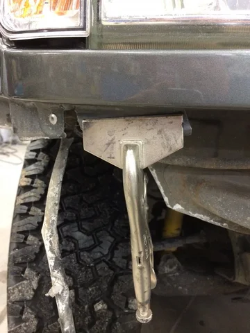

My 99 100 has metal tabs/notches on each side that helped secure stock bumper (just below headlight cavity). I am installing ARB and trying to confirm if the top of the ARB bumper sits just below these tabs? I presume so since not enough room for bumper to go in or above, although my last cruiser and installer attempted that :(
The ARB install instructions do not mention these tabs/notches - it just says align bumper to allow 15mm gap between bumper and truck. Seems to me with the notch there, there is going to be more than a 15mm gap. Do these notches need to be cut off to install the ARB? Help a brutha out please :)

I bent them back out of the way.
