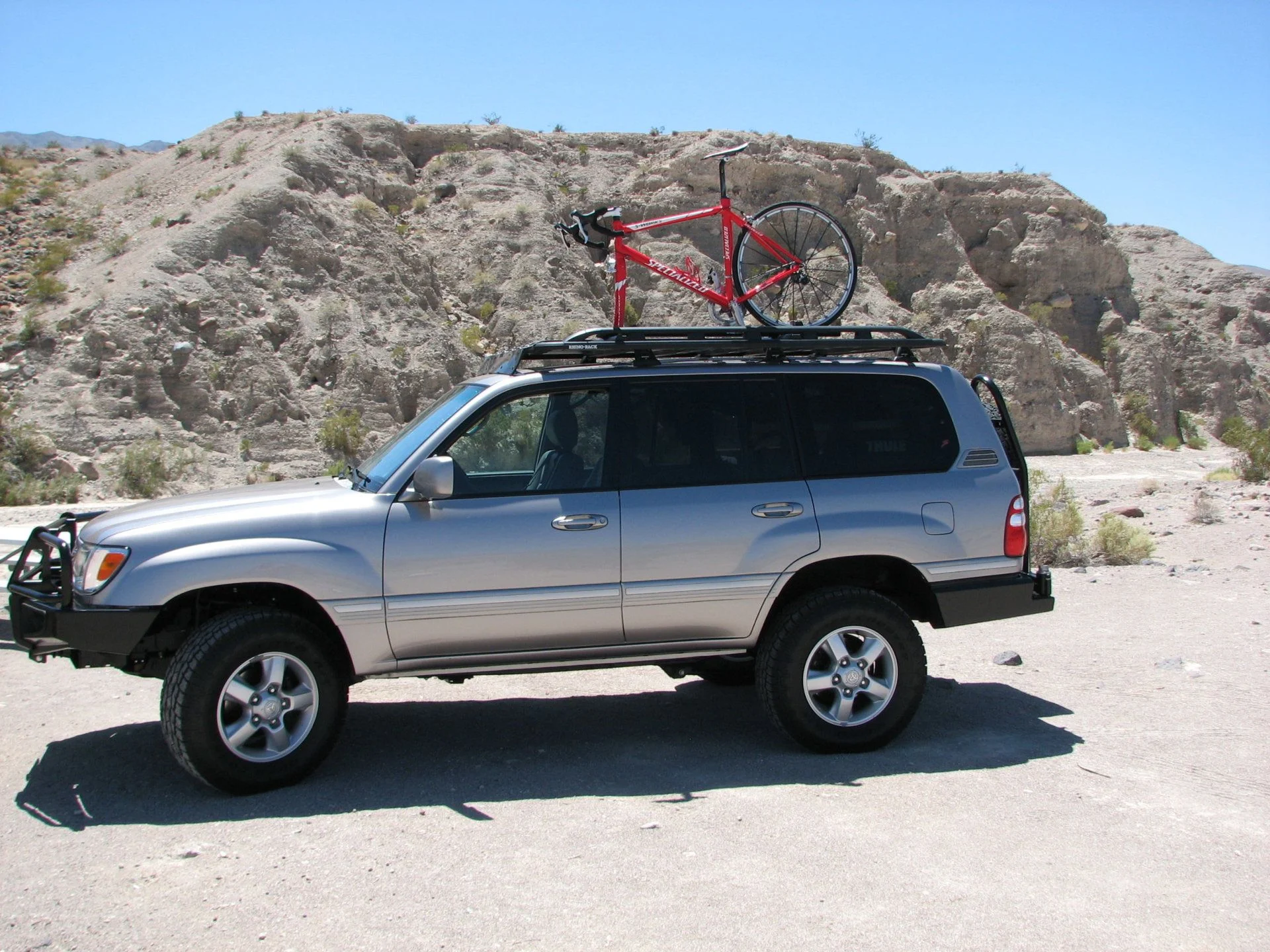

I have an 84x56 PP mounted using the 3 feet per side in the original roof rack mounting points so not quite the
same as a BB mount. I am pretty sure the BB uses the same existing (3 per side) mounting points with the frame
of the BB resting on the channel between them. If you want to keep the dust deflector, you will have to move the
rack forward on the BB which you should be able to do without drilling new holes. If not, the simple thing would be
remove the deflector. I attached a couple of photos of my rack to give an idea of how that size PP fits the roof. Hope this helps a little.

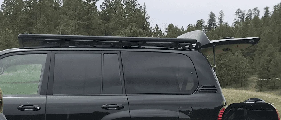

FWIW, backbone and pioneer platform (84x56) fit perfectly in the already existing holes of a LX470 (with enough clearance for the rear spoiler).

Honestly, I don’t know. I had it done by a shop (4x4 Backcountry in Denver). They were very knowledgeable and did a great job (except that they got one screw crooked so it didn’t seal completely; but they fixed that too).
