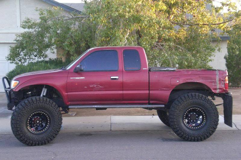

Yeah, we don't come over too often. Mine is the red truck. Faux has the white one. I answered the questions over on the AzTTORA board. Both trucks have been featured in mags. Like mentioned, mine was in 4wd & Sport Utility earlier this year. I have upgraded the axles and tires, and added the crawler since the article was written. They also have the article online in their features section. Faux's truck was featured in OffRoad mag late last year.
Here is a "how I bought it" pic. Basically stock with 32" tires and smitty bars.
Here is a pic from earlier this year after upgrades from 1/2 ton to 1 ton axles and 40's.

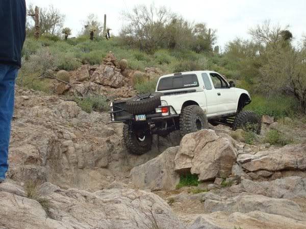

The White POS would be mine. :hillbilly:
Short spec list:
Started life as a '98 Tacama 2wd Prerunner
... as it sits now:
About the only thing original to the truck is the 2.7 3rz (4 banger of fury)
'99 4wd auto trans with the first Marlin 2.28 reduction box made for the 2.7 auto.
Up front: '79 F-250 HP44 (full width) 5.38's and a few other expensive parts.
Out back: 80 something GM 14 bolt, Shaved, with a 4340 Overson spool, 5.38's, disk brake upgrade, etc.
Front suspension: Custom 3 link on 17" Blistein coilovers,
Rear suspension: 3/4 ton 64" chevy springs frenched into the frame.
Tires: 40" Maxxis creepy crawlers
It's got a few dents too! :D
