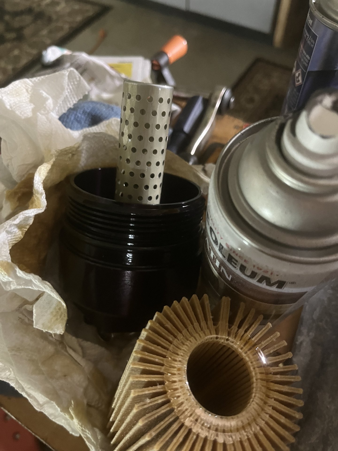

The OEM filter goes over the perforated metal holder in either direction.
The white adapter is not used with this filter.
The large rubber gasket goes onto the upper grove on the housing...I use a bit of silicone grease on the gasket before I install it.
Maybe a silly question, but did you transfer the perforated tube over to the BJowett cap from your stock cap?

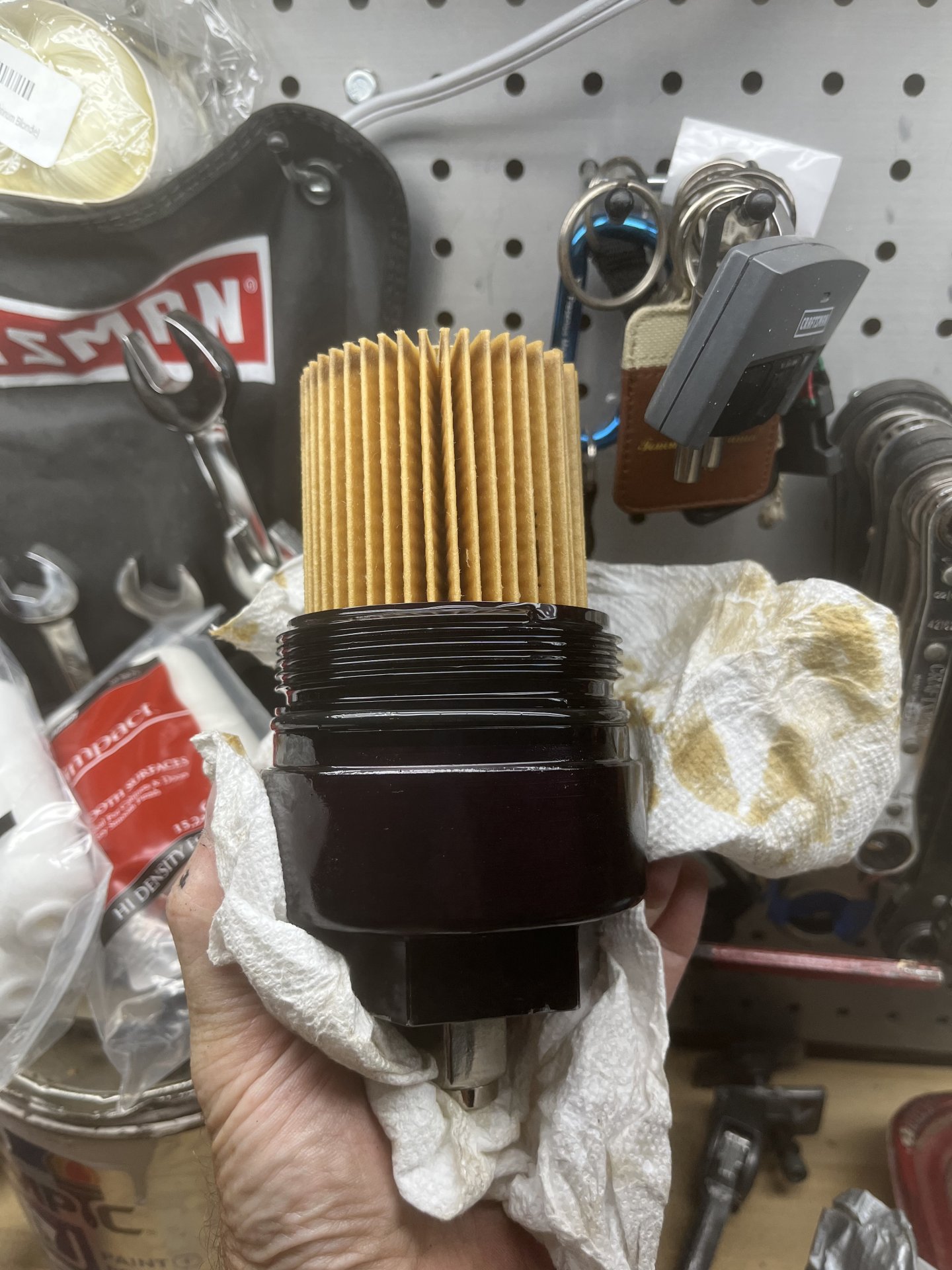

Is this gasket on the wrong place?
Yes. It goes in the groove above where your picture shows...i.e., the bottom groove is NOT where it goes. Sounds like you didn't get instructions on the filter.
ok so your talking about the gasket and it is in the wrong place?
I've been on a creeper under the Lexus for the last two days. Who needs directions ! Paint fumes may be getting to me.
Yes, that. So you just slide the filter over that perforated tube. Throw away the white plastic drain tube and small o-ring that came with your new oil filter. The large o-ring goes in the milled groove on the outside of the filter housing below the threaded section.
Your o-ring is in the wrong groove. It goes in the next groove up. Looks like i was wrong. Crossing out since it is corrected later in this thread.

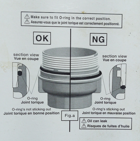

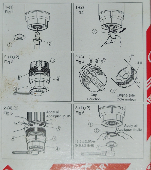

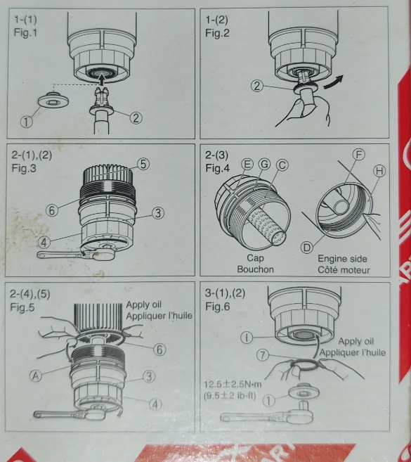

It’s my recollection that the o-ring position shown in post #7 IS actually correct. Does anyone still have the directions to confirm?
Here is from the original Toyota filter housing package. This is the aluminum housing but the same location for plastic one.
So the o-ring in post 7 photo is in the wrong place, right? It should be in the upper groove, right?
