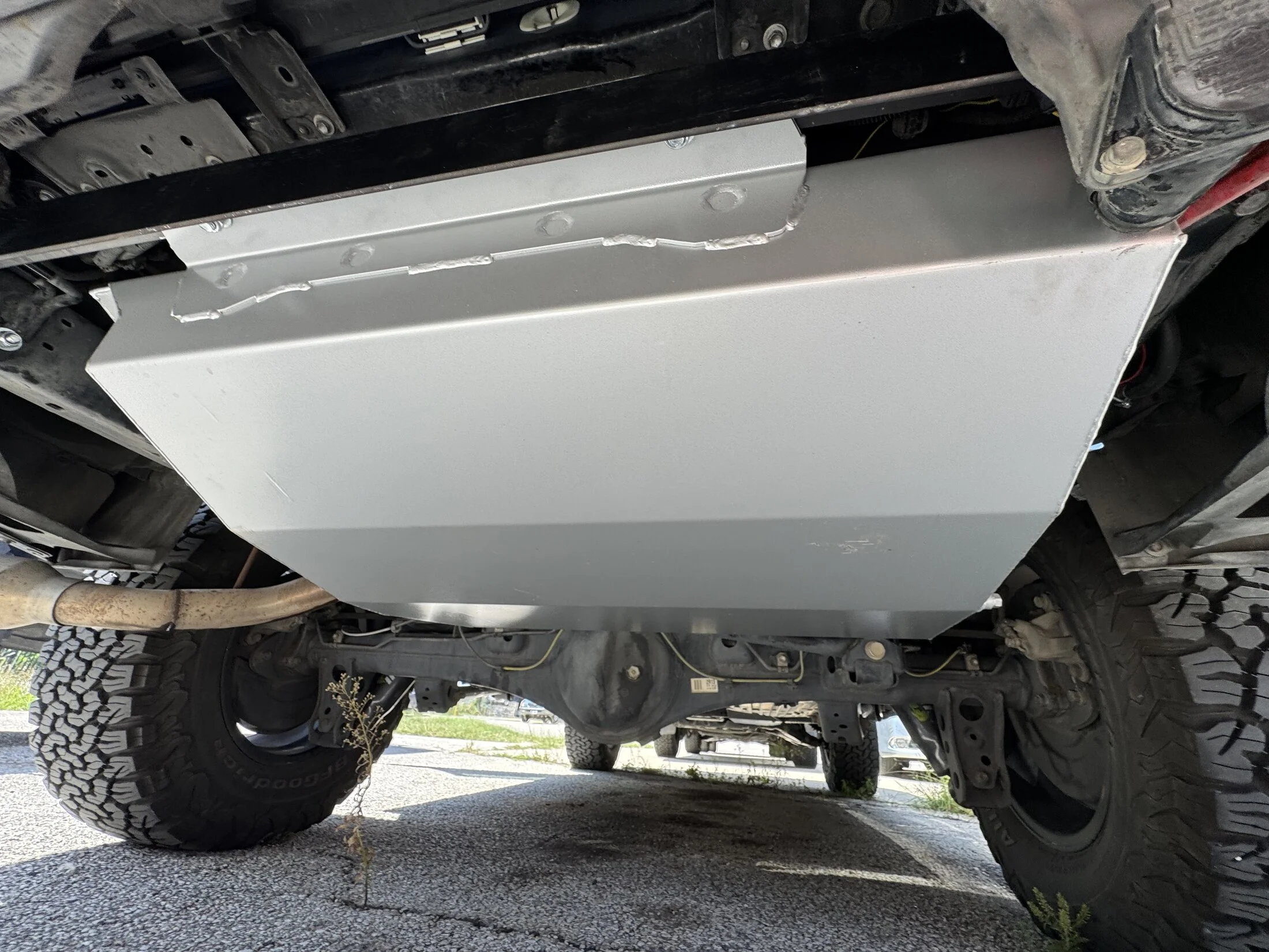

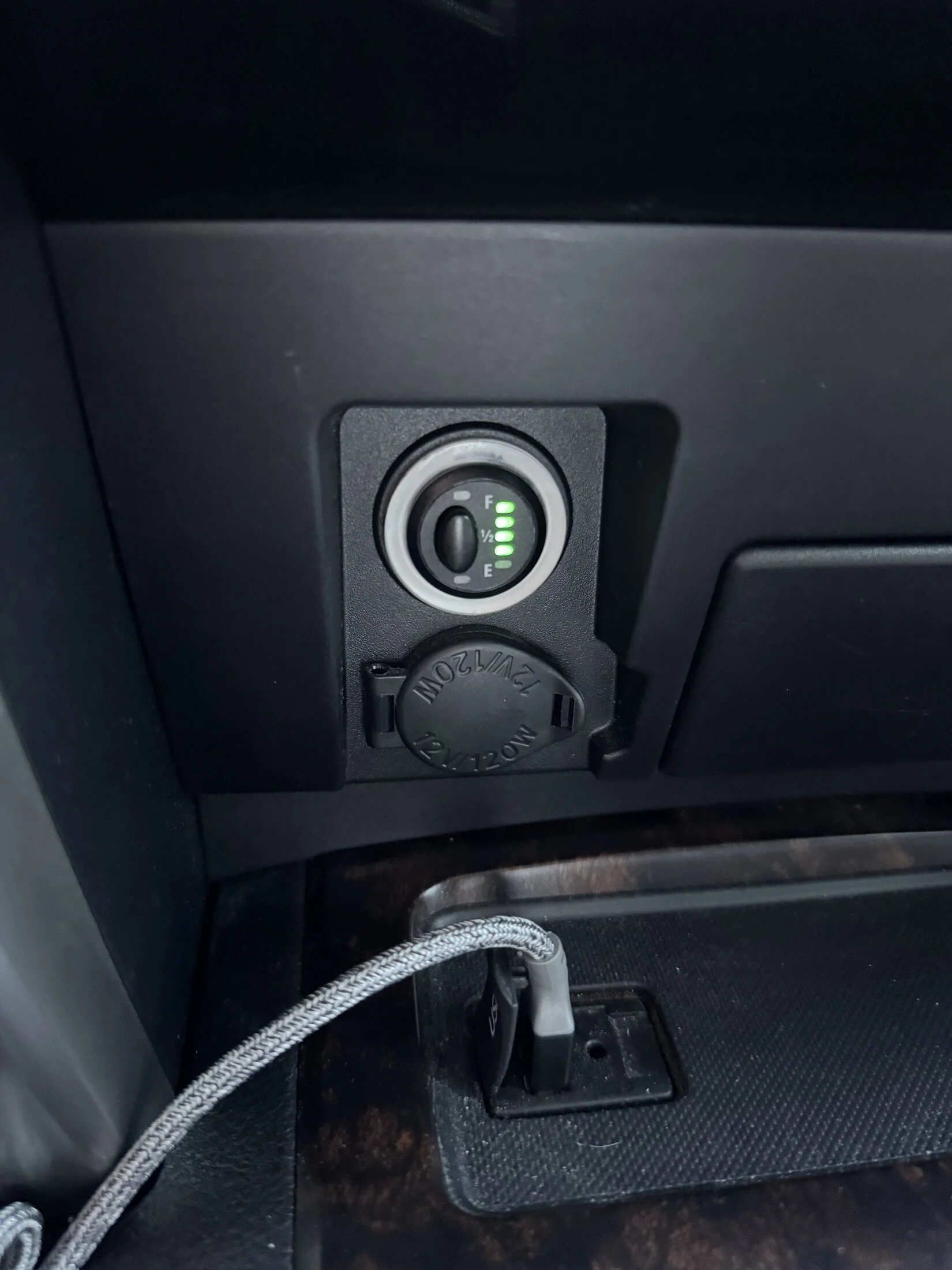

After many months of patiently waiting- finally installed! So far it’s working great! No codes.
No problems with fueling. Full squeeze at the gas pump. No premature clicking off. No squeaks.
I ordered early Nov 2024. 40 gal LRA. Was worth the wait because I got a Black Friday discount and the retail prices on these has gone up recently. ($2745! Currently)
Few things I learned along the way. The pump is not nearly as loud as I had anticipated.
Also- Always knew the 12.5 allowed you to keep the spare. I didn’t realize they actually weld a hollow port through the tank for the spare tire release tool for access. Very cool
The install on the 24/40 is just very slightly less involved than the 12.5. The fit is extra tight on the 12.5. And of course you have to re install the tire carrier.
From what I understand the fit on the 24/40 tanks is not as tight - less chance of body / frame rubbing.
As many have said before- highly recommend!!

Nice work! If you ever want a skid for it, reach out to Budbuilt. I've got a 40 too and she hangs low, but has quite the protection now. It's legit kit!
