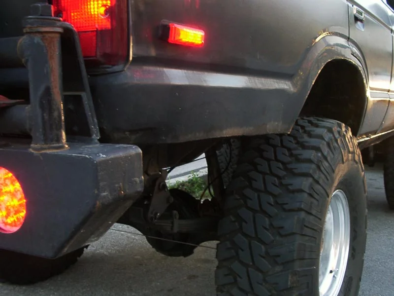

I'm going to be trimming my QP for my new bumper and I was wondering if I could get some pictures of a cut job without a bumper covering it up. I need to know how high I can cut it and if Im going to need to be welding any sheet metal anywhere.

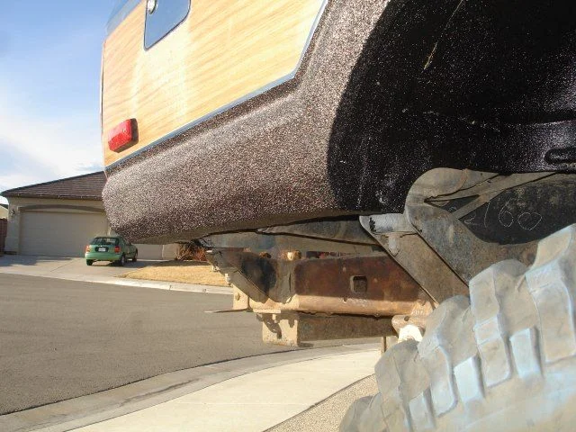

you will need to weld caps on it or it'll be open to the inner fender

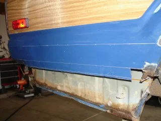

only pic I can find but you can see the rear quarters are open ..ok on mine but I do get alot of mud and crap up there on a topped rig your would HAVE to cap em

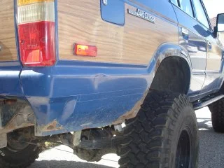

ok here you can kinda see if the bottoms was open how it leads to the inner fender
Hmmm ok, thats what I figured. I don't have a welder that welds worth s*** so I guess Ill be paying jason a little extra.:cheers:

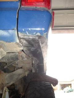

You DO NOT need a power house welder to weld the sheet metal. Its burns through VERY EASILY! Youre basically doing HUNDREDS of tack welds. Its a long tedious process, but as ROM mentioned...worth it.
I had some NASTY cancer that I had to chop out and re make sections of panel. WATCH OUT for the wires that run inside the QP's, and the filler neck can be a little sketch too.

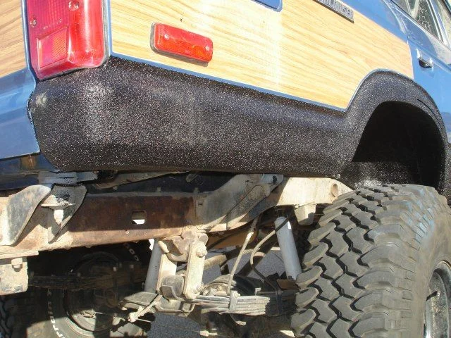

Here is the finished product!
