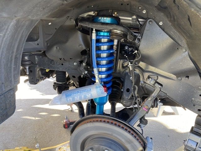

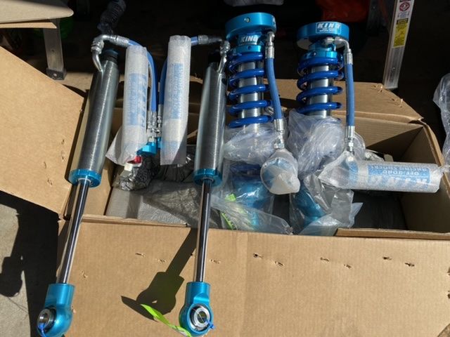

In my typical fashion I can’t leave a good thing alone, plus got tired of the choppy ride on the GX and wanted a lift anyways. With help if a good friend who got the King’s shocks on his GX I bit the bullet and ordered the King’s shocks and he help me ordered it with 2.5 body and resi with compression adjustment,
so sexy!

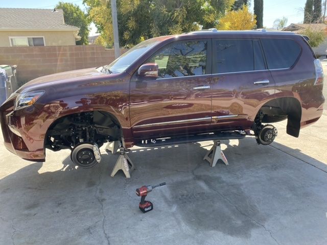

My girl ready for new legs!

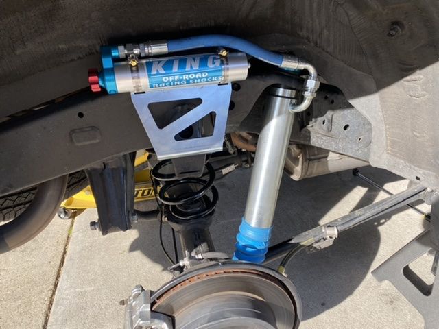

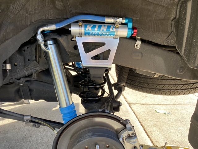

Instal went relatively smooth for the rear, passenger for some reason was harder to drop the axle so had to use spring compressors to put new spring back in.

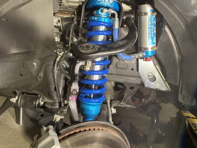

Front went in easier than expected, granted we decided to not to change the UCA since my GX only has 10k on it.
We were so close we can taste it! Plus it was dinner time! Then trouble arrives! The brackets to mount the Resi do not fit!!! They are for 150 with sway bar and the GX with KDDS doesn’t even have threaded holes for the bolts. So we decided to improvise with rivnuts, then the problem with driver side is then is the KDDS sway bar was in the way. So dropped the sway bar and popped in the rivnut, then we realized the driver side has a weird piece of metal in the way that doesn’t seem to do anything besides holding the shield. Out came the cutting wheel and grinder.
Finally mission accomplished!
torqued everything and went for a drive! oh she is sooooo smooth! Got slightly over 2 inch in the front and almost 3 inch in the rear but the rear will settle.
So due to the way the kit is designed King’s never did R&d on a KDDS GX. Valving was custom and obviously the Resi brackets will not work out of box. This mean I’m the first GX460 with KDDS with King’s 2.5 coilovers with Resi!!!:bounce2::bounce::bounce::bounce2:
Ride is superb! Again, custom valving for the GX which is a lot heavier than the 4Runner. Relatively firm on small stuff and soaks up big bumps like a dream. It’s like riding on temperpedic firm pillows. With my Resi I got compression adjustments and will leave the setting on softest during break in. Probably will add a few clicks to reduce the brake dive more but it is already damn amazing!

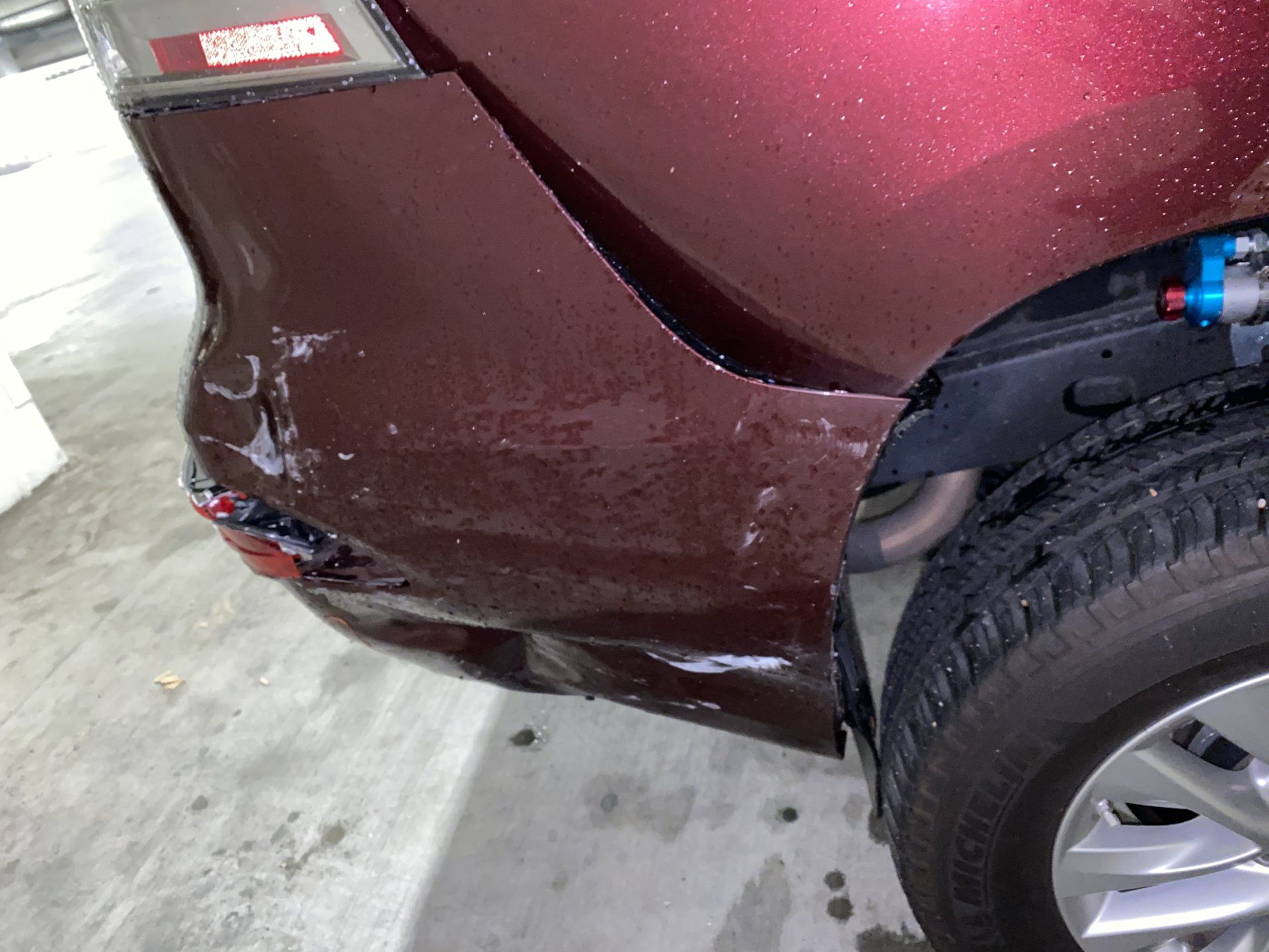

Before I can do much with the 460 some crazy lady ran a red light and ran into the 460 while the wife was driving it. Fortunately it’s relatively mild and body shop said it will be 2 weeks and 5200 dollars. At least she had insurance and we have uninsured just in case. Just really pissed that the rear quarter panel on the 460 has to be repainted at only a year old.
