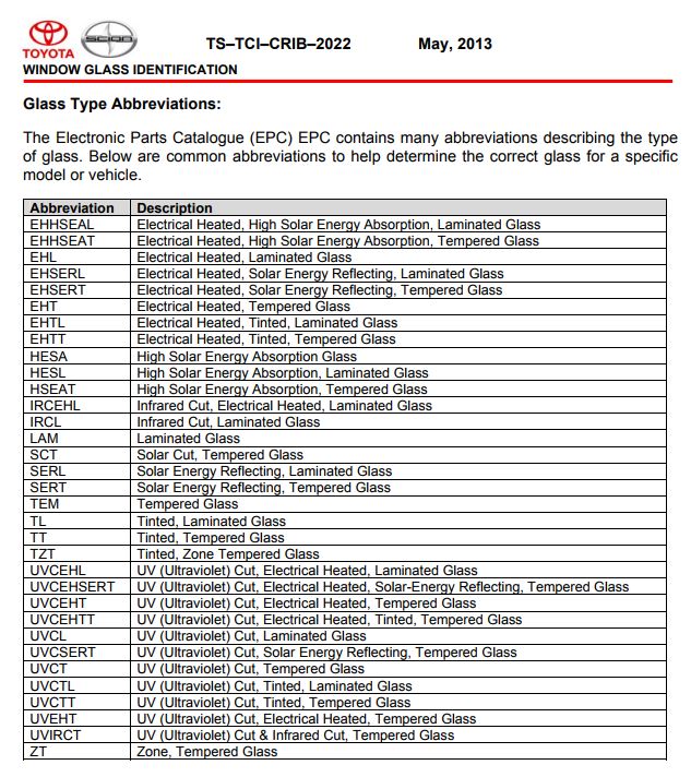

EHTT stands for "Electrical, Heated, Tinted, Tempered" glass...in case you were wondering.
More info here: http://toyotaservicemanagement.com/...2-Window-Glass-Identification.ENG-FR.-pdf.pdf

I don't know why the glass from a 84-90 wouldn't fit. I thought the only differences was when you have the troopy door which is 4 inches taller. I think yours would be the 3rd from the top on the list 68131-90K07
68131-90K00TEMPERED GLASS, T=3.5
68131-90K06TINTED TEMPERED GLASS, T=3.5, BLUE
68131-90K07 ELECTRICAL HEATED TINTED TEMPERED GLASS, T=3.5
68132-90K00TEMPERED GLASS, T=3.5
68132-90K04TINTED TEMPERED GLASS, T=3.5
68132-90K05ELECTRICAL HEATED TINTED TEMPERED GLASS, T=3.5
Hello,
Does your truck have a rear defogger? If so, an "electrical heated" glass will suit you. Otherwise, a tempered glass window will do.
Standard grade Toyota glass has no color. What Toyota calls Tinted Glass has a bluish/greenish hue.
The part numbers listed by Rosco / @roscoFJ73 are good for model years 1984 through 2006. Newer model years should also fit, because little has changed in that part of the 70 Series.
