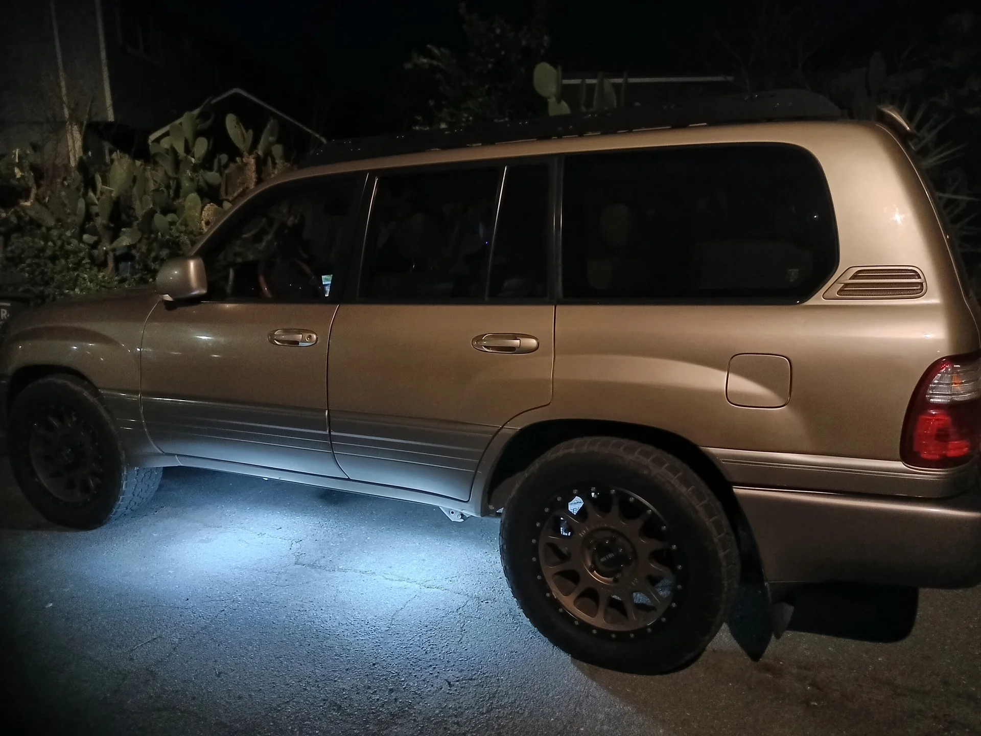

Too much deep snow in N Idaho...must've strained the wiring on my drivers' side puddle lights. I bought these from a MUD maker about 4+ yrs ago, but can't find him now. They were plug n play into the existing running board harness connector, a very easy install. Any ideas on replacing?

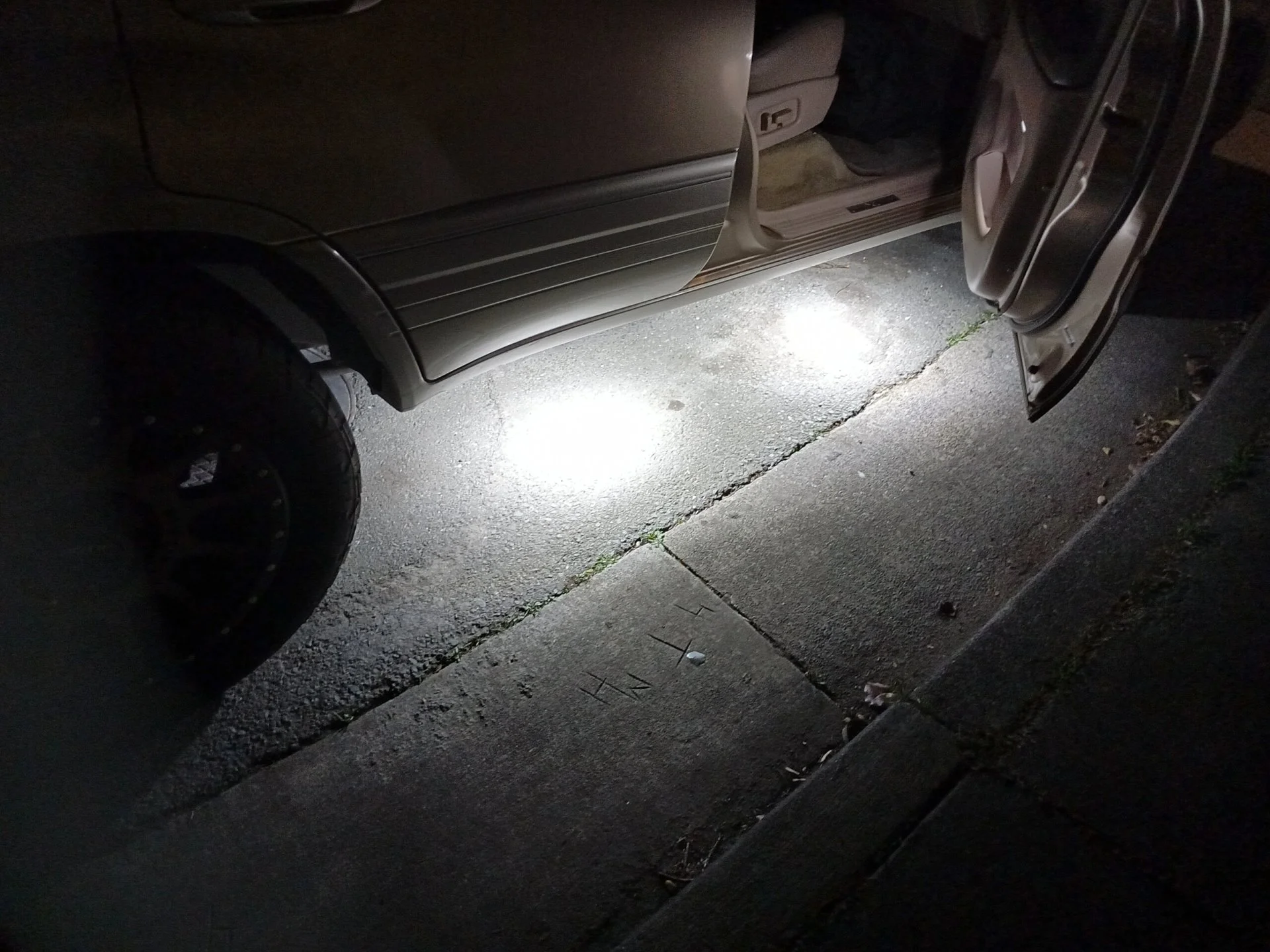

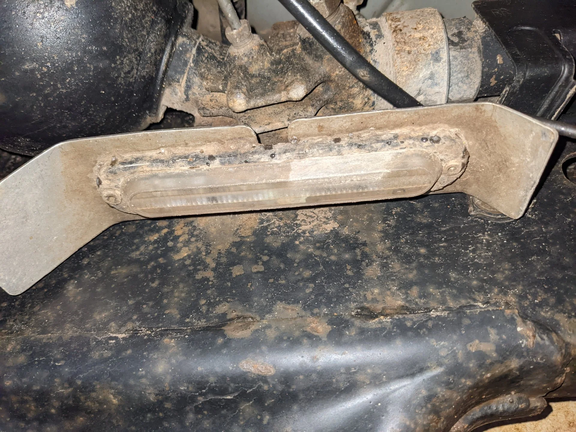

In the two pods, one-half of each light strip is on, the other half is out. So, likely not a light failure...

Hmm that's odd. I'd pull them down and check all the wiring. You can also use a multi meter to ensure your still getting around ~12v at each light.

You were right, to check voltage. I had ~12v at the initial harness connection, so then had to work downstream. My snowventure had just strained the wiring at the first puddle junction of three wires, causing intermittency. Your lights are still good (!) although I ended up using one of the new ones I bought, as it provided the extra length of wire I needed after stripping back the existing. It was just easier than re-building a new harness.
